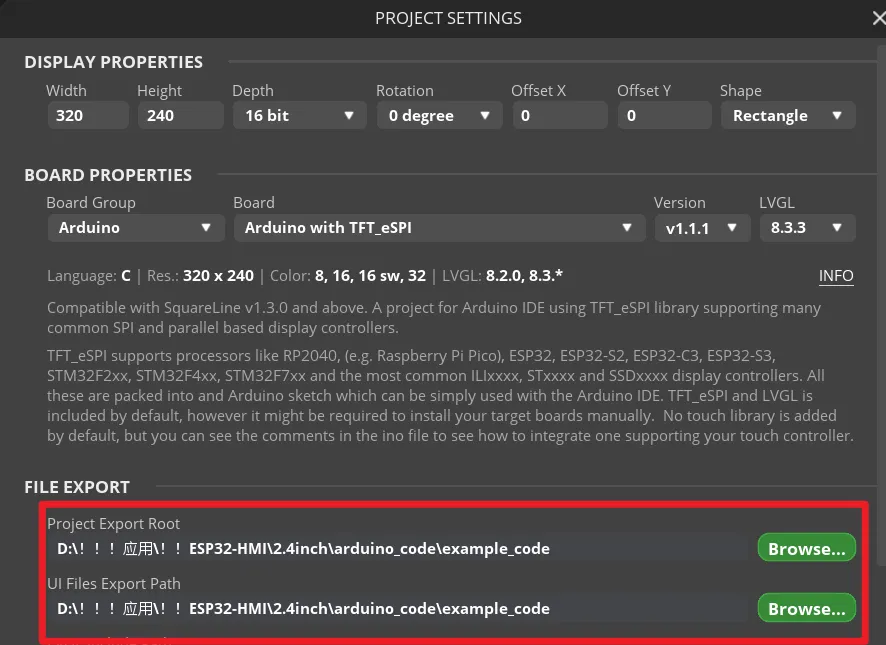

Open the SquareLine Studio and create a project. Select "Arduino"->"Arduino with TFT_eSPI".
Note:
Set the name of the project, set the screen resolution to 320*240, set the color depth to 16bit, and keep other default settings. After setting, click CREATE to create the project.

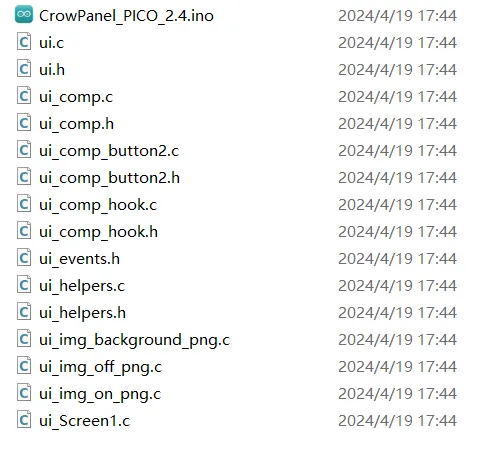

Export UI files.
Then click "APPLY CHANGES".
Please click
to download the main program(and the expert UI is included). -

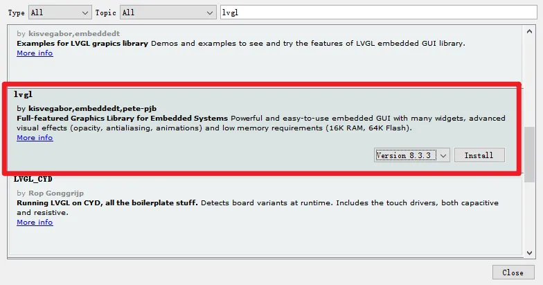

Please click
to download the libraries we modified.
Tips:
If you install the lvgl libraries by Library Manager, you need to copy the demos folder and examples folder and paste them to src folder. And modify the lv_conf_template.h file and rename it to lv_conf.h, and place it in libraries folder.(Please refer to the library provided)
If you install the TFT_eSPI libraries by Library Manager, you need to modify User_Setup.h file accordding to the hardware specification.(Please refer to the library provided)

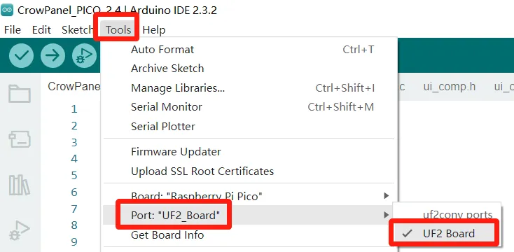

Upload the Code¶

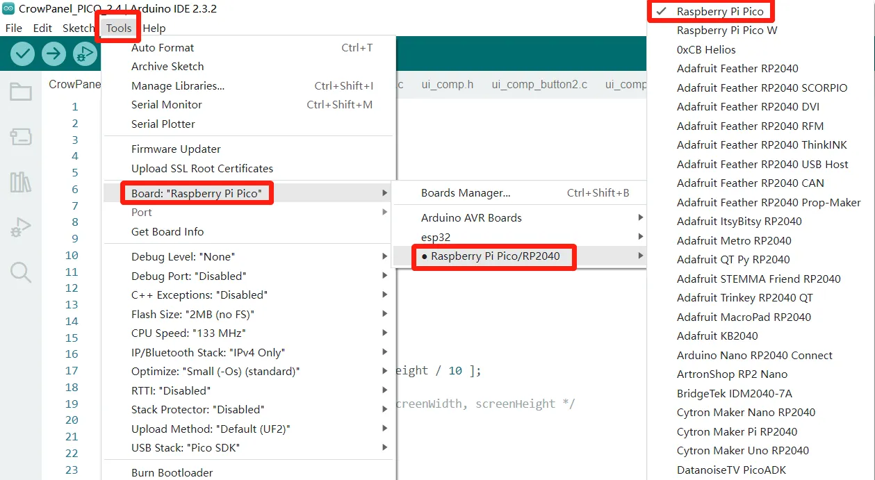

After completing the installation of the RP2040 board according to "Get Started with Arduino IDE" and the installation of the library according to "Add Libraries", open the program and connect the PICO HMI 2.4-inch to the computer via a USB-C cable.
Select Board: click "Tools" -> "Board" -> "Raspberry Pi Pico/RP2040" and select "Raspberry Pi Pico"
Select Port: Please hold the BOOT button and press the RESET button first, and the PICO HMI board will turn into a U disk. Then click "Tools" -> "Port" and select UF2...(Note: you need to press the button every time you need to connect the board with computer through serial communication.)

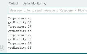

Example2: Monitor environment temperature and humidity¶
Connect the DHT20 sensor to IIC port. After uploading the code to the board, the temperature and humidity value will show on serial monitor.
