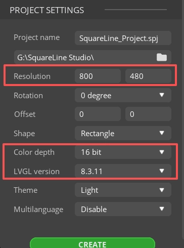

Note:Please select the corresponding resolution and color depth according to the screen specifications.

5.1 Create a new SquareLine Studio project.¶
Here, I take a 2.8-inch screen as an example. After determining the resolution, I fill it in

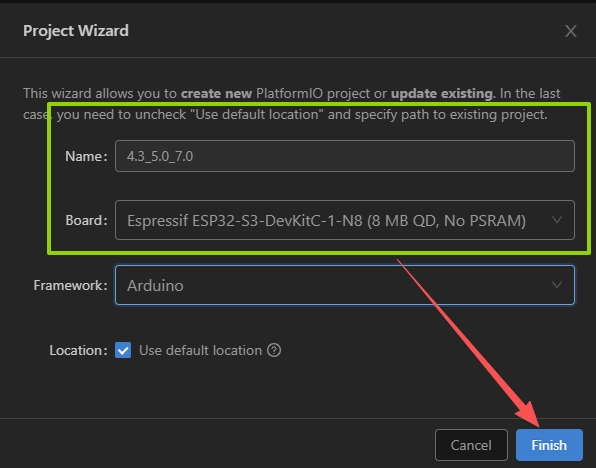

Click the PlatformIO icon, click QUIK ACCESS 'Open', then click '+New Project'.
Add a project name. Select "Espressif ESP32-S3-DevKitC-1-N8" for the board and Arduino for the framework.(In this lesson, the 2.8-inch development board is taken as an example.)

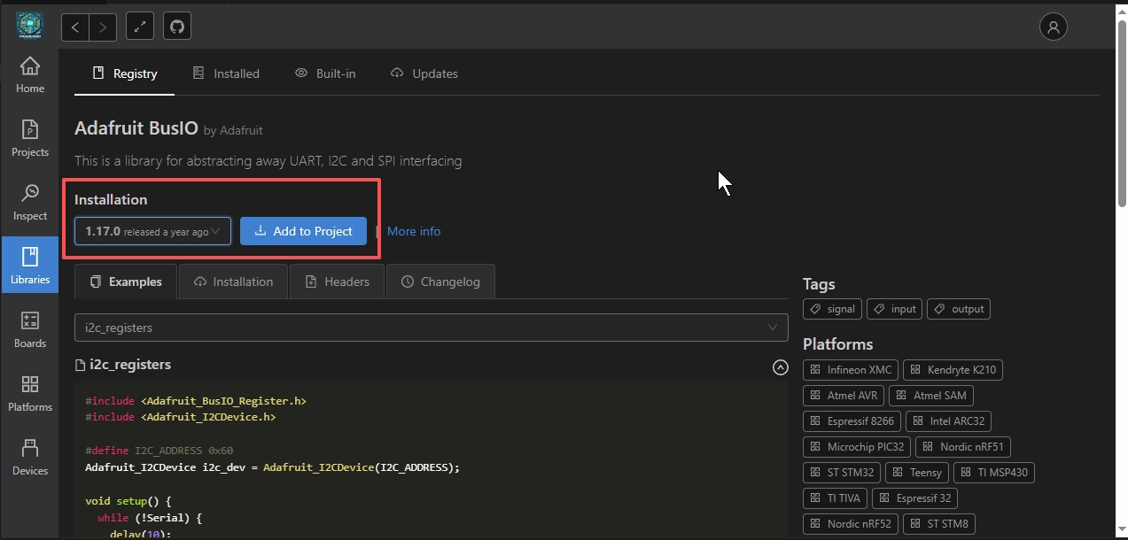

6.2 Add the necessary libraries to the PlatformIO project.¶

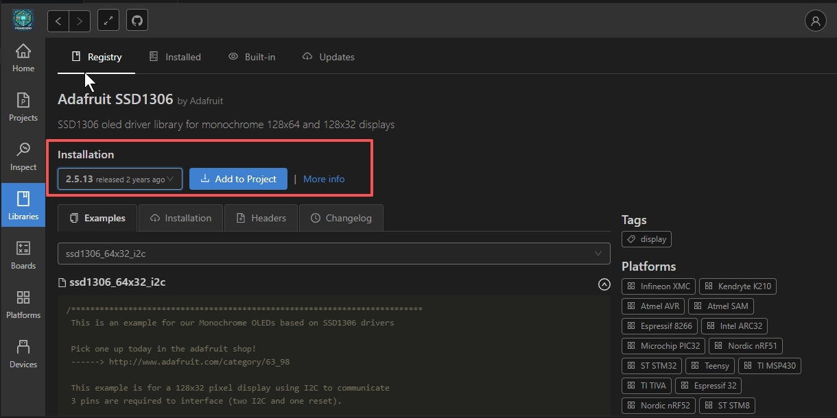

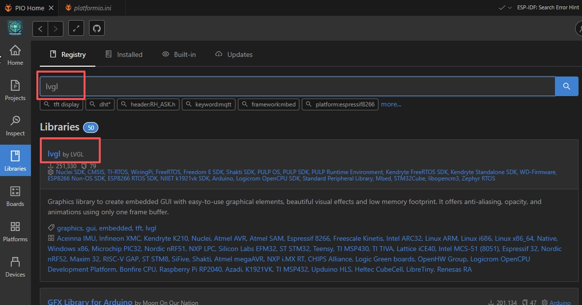

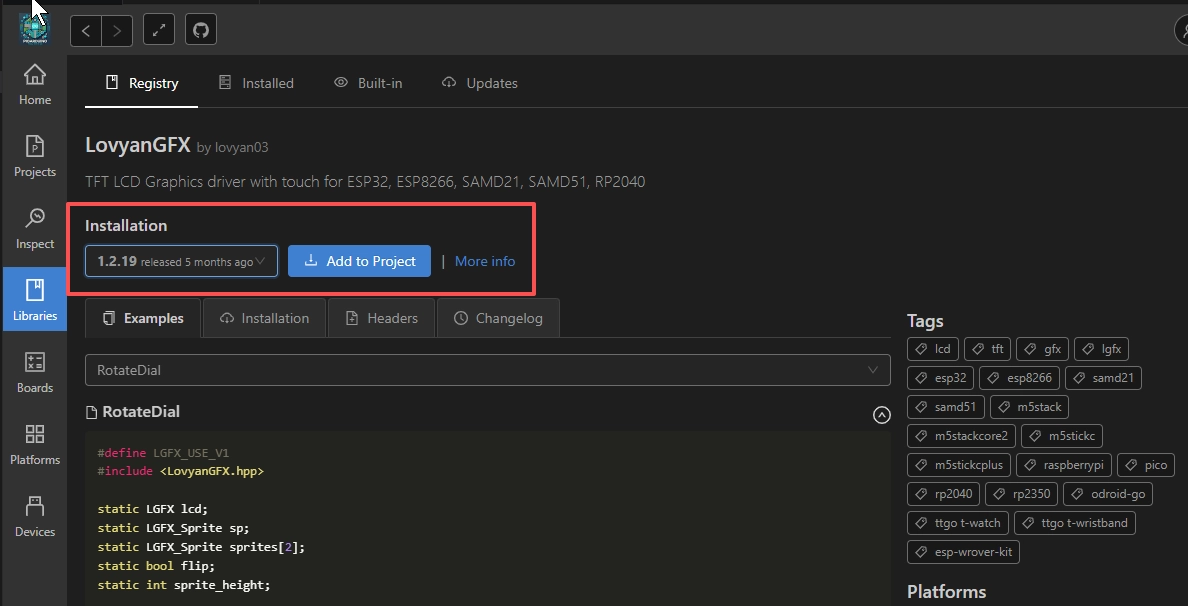

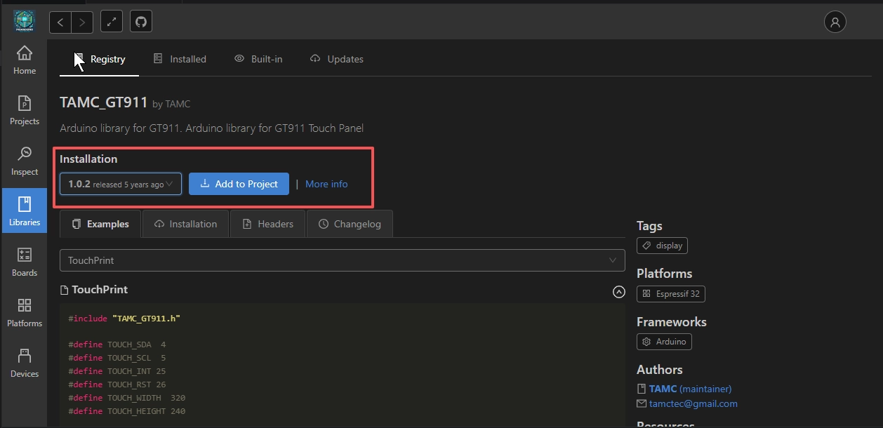

Click the PlatformIO icon, click ‘Libraries’, then search for the following libraries.
① Lvgl
② LovyanGFX
③ Adafruit SSD1306
④ TAMC_GT911
⑤ FT6336U

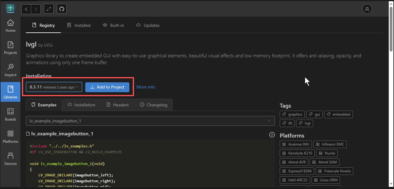

Click on the LVGL library.

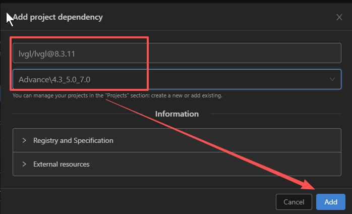

Select version 8.3.11 (which needs to correspond to the version selected when creating the project in SquareLine Studio), and click "Add to Project".
Select the corresponding project name and click "Add".

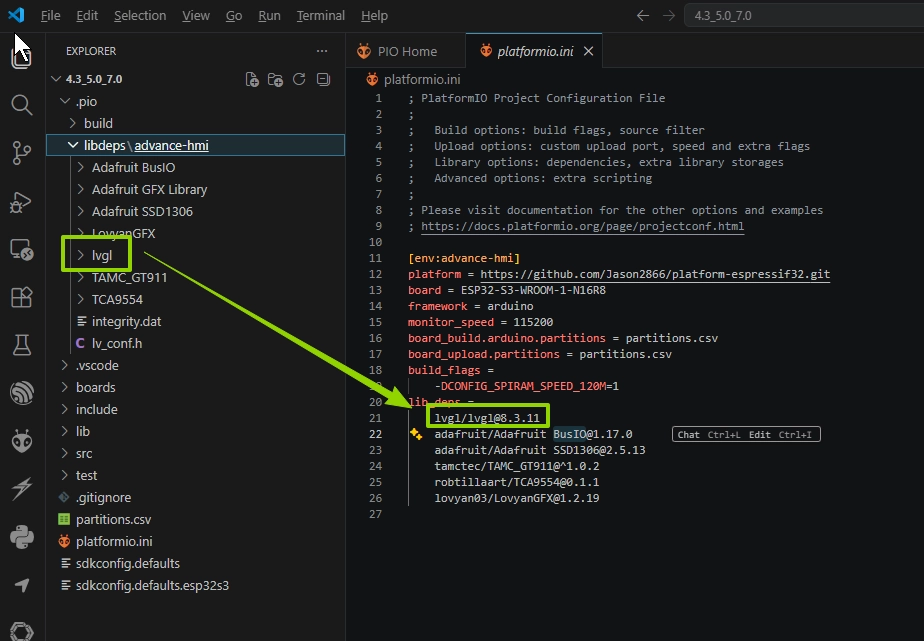

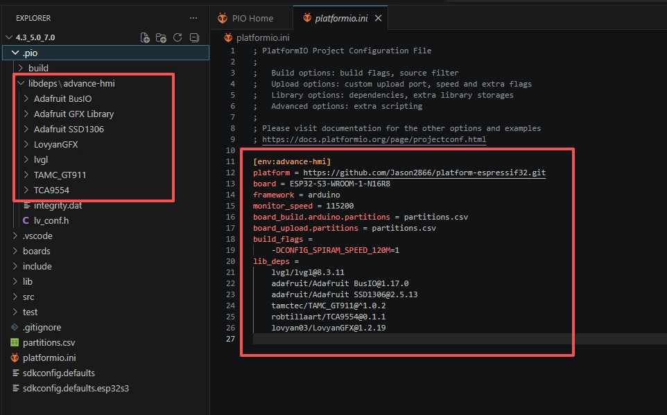

If the library is successfully added to the project, the interface will automatically jump to the PlatformIO.ini file and automatically generate the project dependencies.
Note: If the platformio.ini file remains unchanged, but the library that has just been added is present in the pio->libdeps->esp32-s3-devkitc-1 folder, then click on "Compile". The PlatformIO plugin will pop up a window prompting you to change the library dependency link in the platformio.ini file.

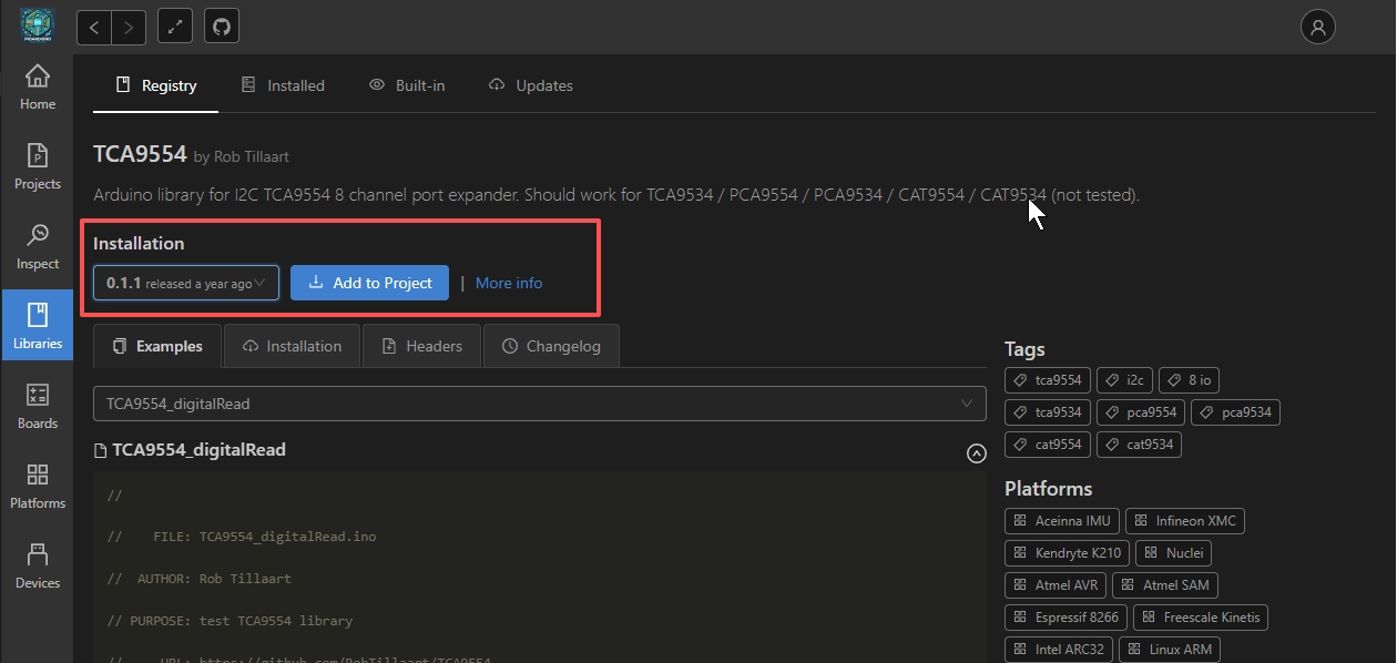

Repeat the above steps and add the remaining libraries one by one (just select the latest version by default for the library versions).
After all the required libraries have been added, the PlatformIO project will be as shown in the following figure.
Place the lv_conf.h we provide to the path: .pio\libdeps\esp32-s3-devkitc-1-myboard in the project folder.
6.3 Add the chip configuration to the PlatformIO project¶

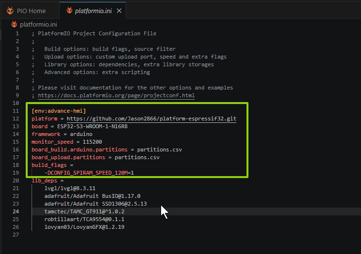

Open the platformio.ini file. This file is the configuration file of the PlatformIO project, which is used to define information such as the project's build environment, upload options, and library dependencies. Copy the following development board configuration into this file.
monitor_speed = 115200
board_build.arduino.partitions = default_8MB.csv
board_build.arduino.memory_type = qio_opi
build_flags =
-DBOARD_HAS_PSRAM
-mfix-esp32-psram-cache-issue
-DCONFIG_SPIRAM_SUPPORT=1
-DCONFIG_SPIRAM_TYPE=1
-DPSRAM_SIZE=2
-DPSRAM_CLK=120000000
board_upload.flash_size = 8MB

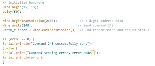

In terms of hardware, we use a microcontroller (STC8H1K28) to control the screen backlight, speaker on/off, and buzzer.
(However, there are other function interfaces that need to be written in the specific code, and you can refer to the complete code provided later.)
Explanation:
0x30 is the I2C address of the microcontroller (STC8H1K28).
0x5D is the I2C address of the touch IC (GT911).
sendI2CCommand(0) means sending command 0 to the microcontroller (address 0x30) to instruct it to set the screen brightness to maximum.
For 0 mentioned above, you can replace it with the following values:
- 0 is the brightest backlight.
- 0 to 245: The screen brightness will gradually increase to the minimum value
- 245 represents turning off the screen light
Additional notes:
You can also control the following functions by sending other instructions to the microcontroller:
- It means sending the 248 command to the microcontroller (0x30) to instruct the speaker to turn on.
- It means sending the 249 command to the microcontroller (0x30) to instruct the speaker to turn off.
- You can also send command 246 to control the buzzer to turn on, and send command 247 to control the buzzer to turn off.
By writing the instruction 0x10 to the address 0x30 of the microcontroller, it is used to control the microcontroller.
