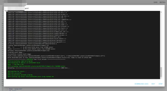

Once the program is edited, click 'INSTALL' and select 'Wirelessly'. This way is very convenient for us.
The following interface will appear after successful burning.

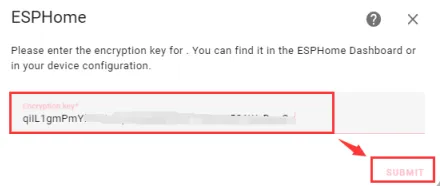

Enter the API was just asked to remember.

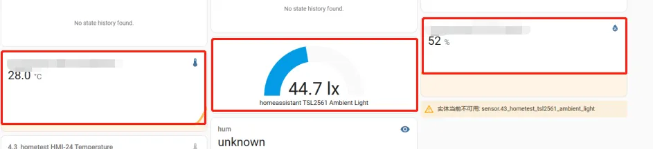

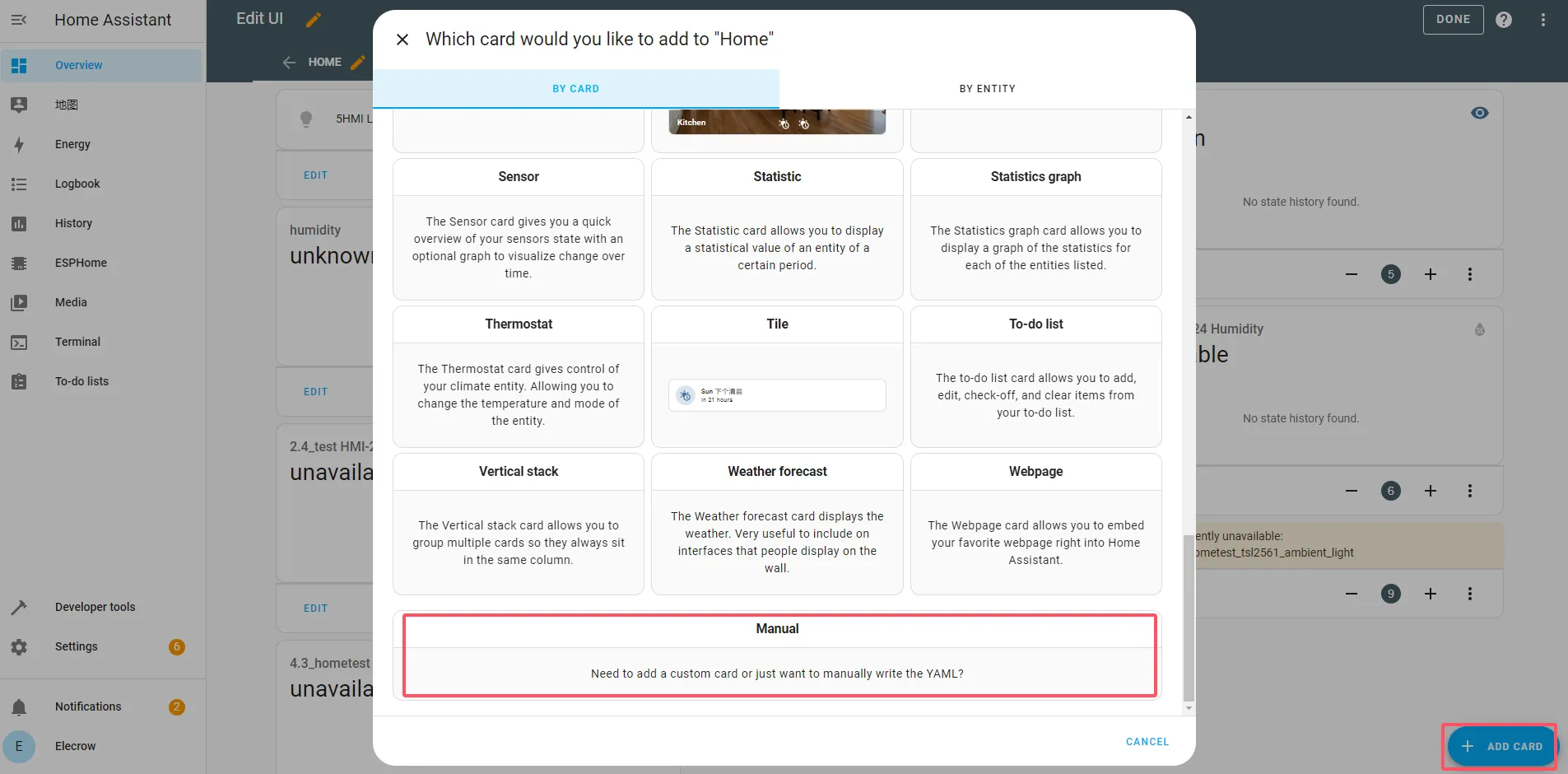

Now add a card to view the data detected in real time.

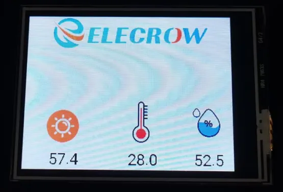

The added card will automatically generate the functions we set. The set function is to detect temperature, humidity and brightness.

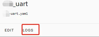

Connect the UART port of the Terminal SPI to the PC. You can view the data received by the Terminal SPI from the LOG.

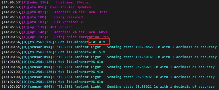

IIC
Connect the digital light sensor to the IIC port of the Terminal SPI. Check the brightness value in LOG.

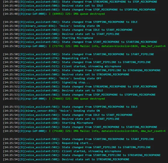

Microphone
Connect a button sensor to the A1 port to control the microphone on and off.

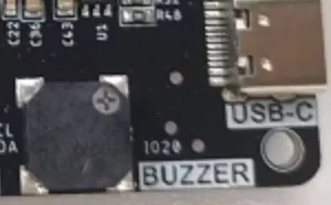

Buzzer
Make the buzzer sound.

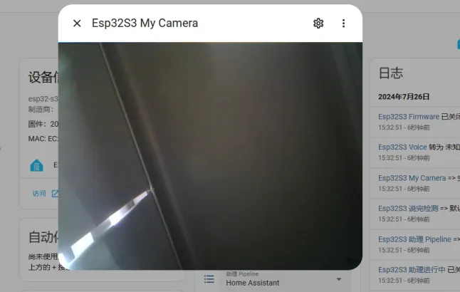

Camera
Observe the environment through the camera.
