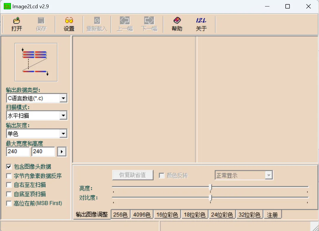

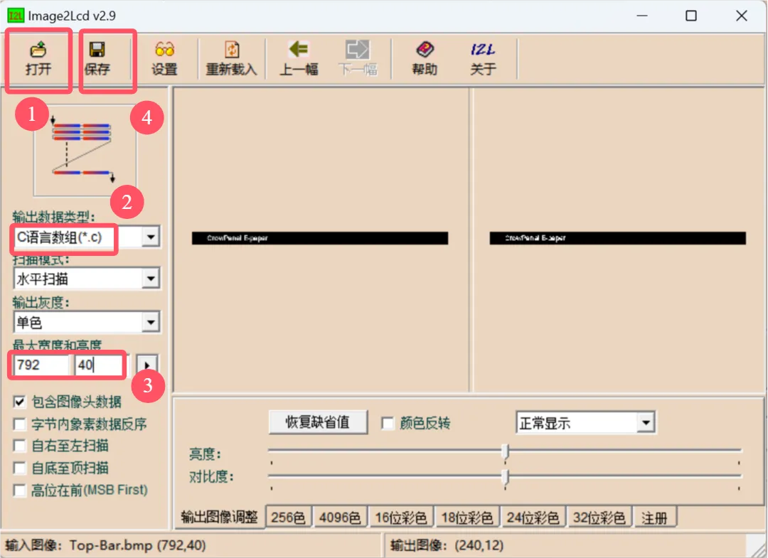

Convert the image format¶

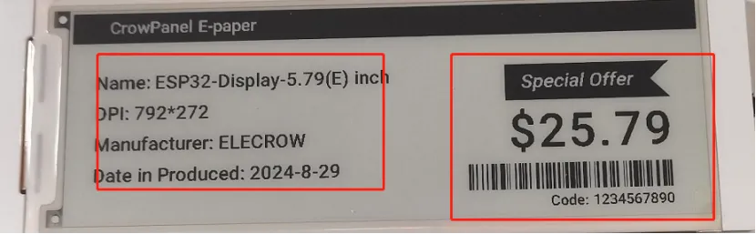

First, let's take a look at the price tag we design in this example, which is divided into three parts(all are images). The top bar is a fixed and unchanging background. On the left is the description, and on the right is the price. The parts we need to update are the description and price.
For the fixed top bar, we can convert it to C array and put them in the code.
For the variable description and price, we need to convert them to bin file and upload them to the board through WiFi.
Click open and select top-bar.bmp, convert it to array format.
- Open file
- Output date type: C language array by default
- The biggest width and height: Consistent with the width and height of the image. Note that it must be a multiple of 8, otherwise it cannot be displayed properly
- Save and output
You can put this array in a suitable header file, and I have placed it in Ap_29demo. h here.

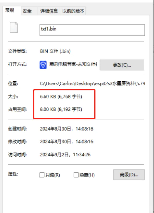

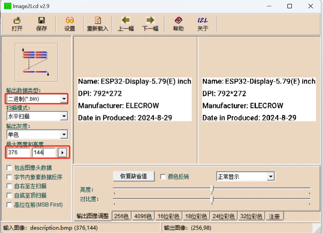

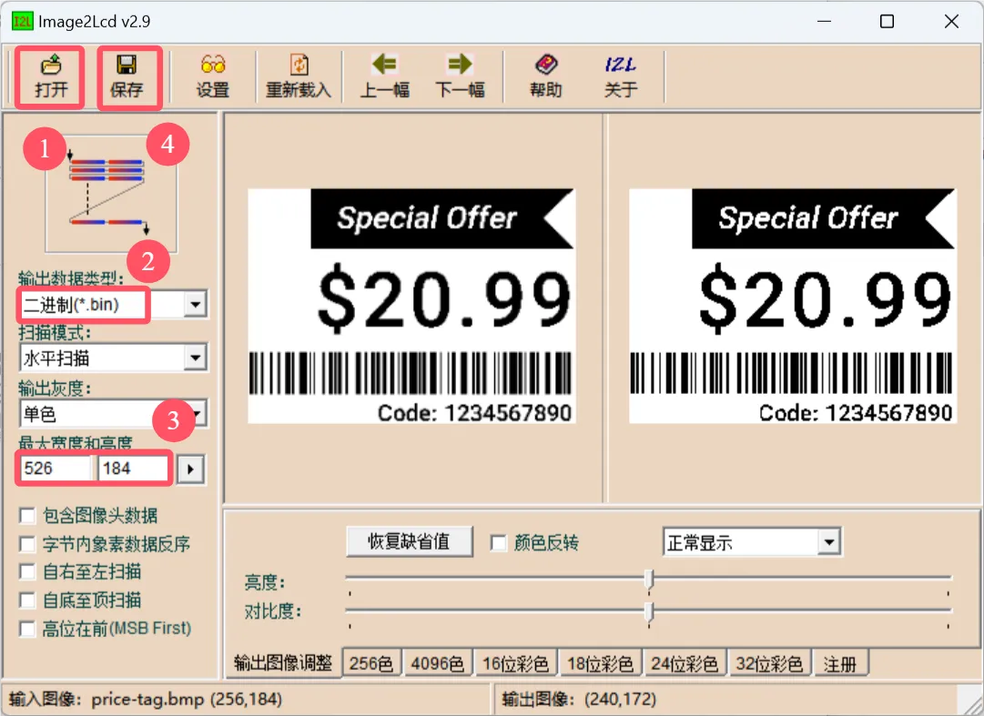

Convert the description pictures and price tag pictures to bin files. These bin files will be used to update prices over WiFi.
- Open the file
- The output type select .bin file
- The width and height should consistent with the width and height of the image. Note that it must be a multiple of 8, otherwise it cannot be displayed properly
- Save the file

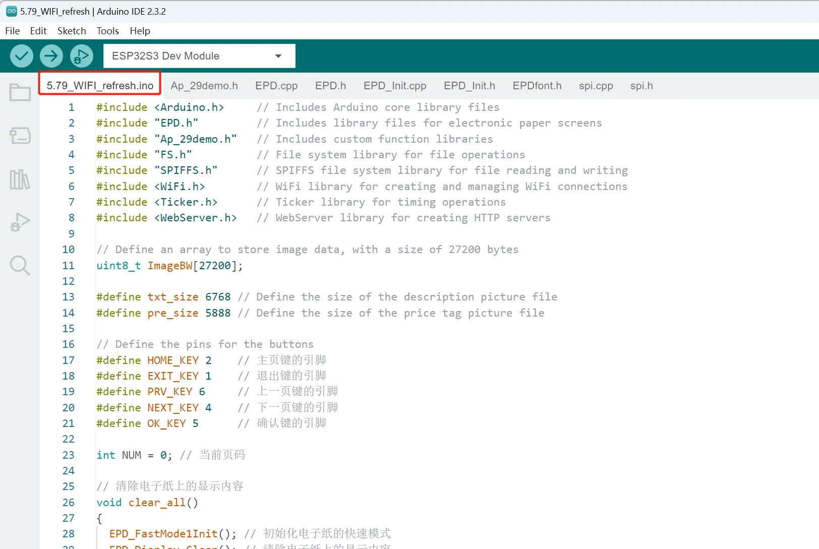

Add necessary libraries
#include <Arduino.h> // Includes Arduino core library files
#include "EPD.h" // Includes library files for electronic paper screens
#include "Ap_29demo.h" // Includes custom function libraries
#include "FS.h" // File system library for file operations
#include "SPIFFS.h" // SPIFFS file system library for file reading and writing
#include <WiFi.h> // WiFi library for creating and managing WiFi connections
#include <Ticker.h> // Ticker library for timing operations
#include <WebServer.h> // WebServer library for creating HTTP servers
Define the file variable fsUploadFile Used for accessing files, txt_size and pre_size correspond to the size of the BIN file(Exported in the above steps) for the text label and price label to be transmitted. The image resolution requirement is smaller than the screen resolution and both width and height are multiples of 8.

#define txt_size 6768 // Define the size of the description picture file
#define pre_size 5888 // Define the size of the price tag picture file
Note: The size here can be defined based on the size of the images to be transmitted later, otherwise it will cause image transfer failure

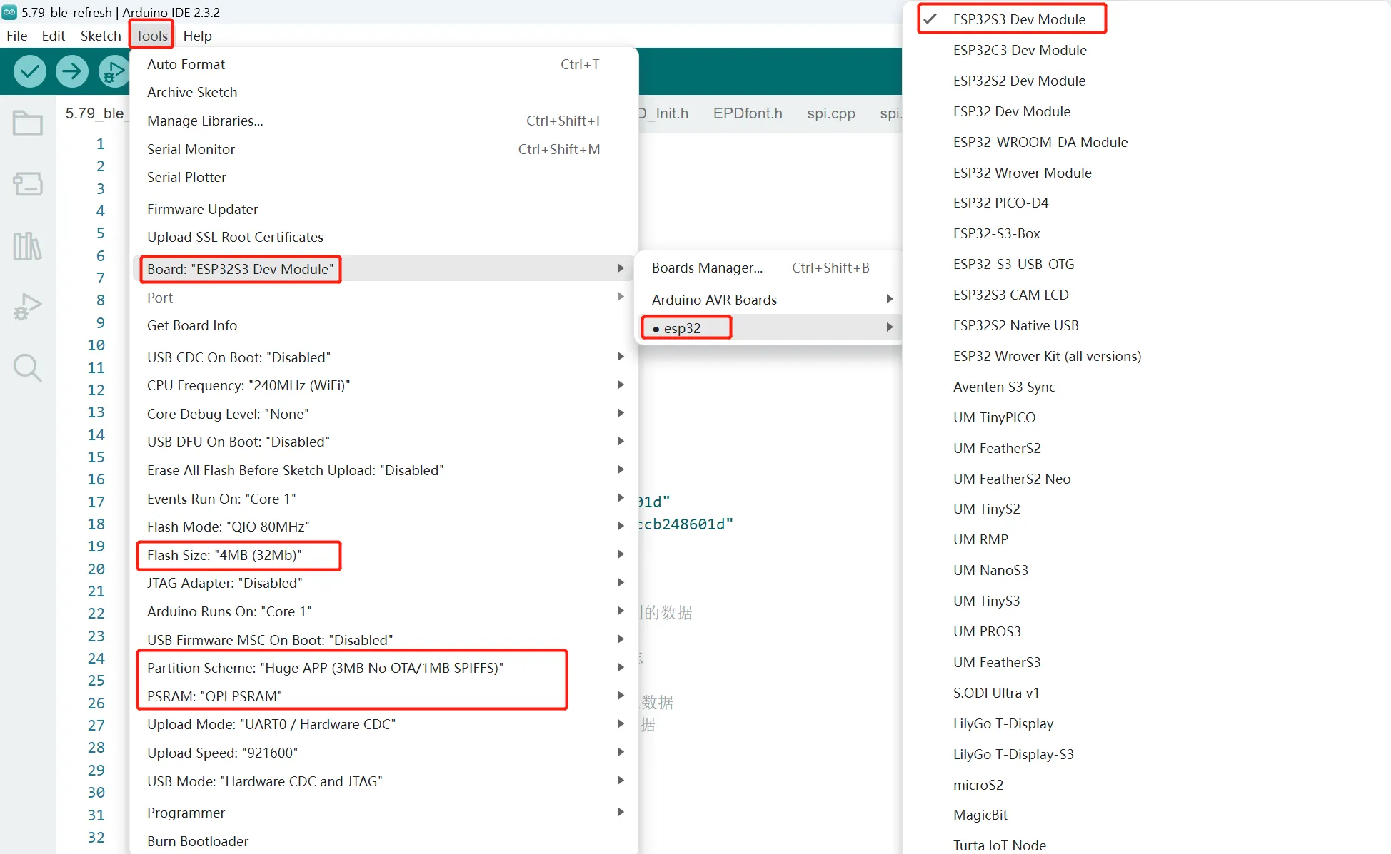

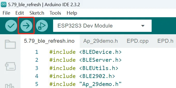

Upload the Code¶

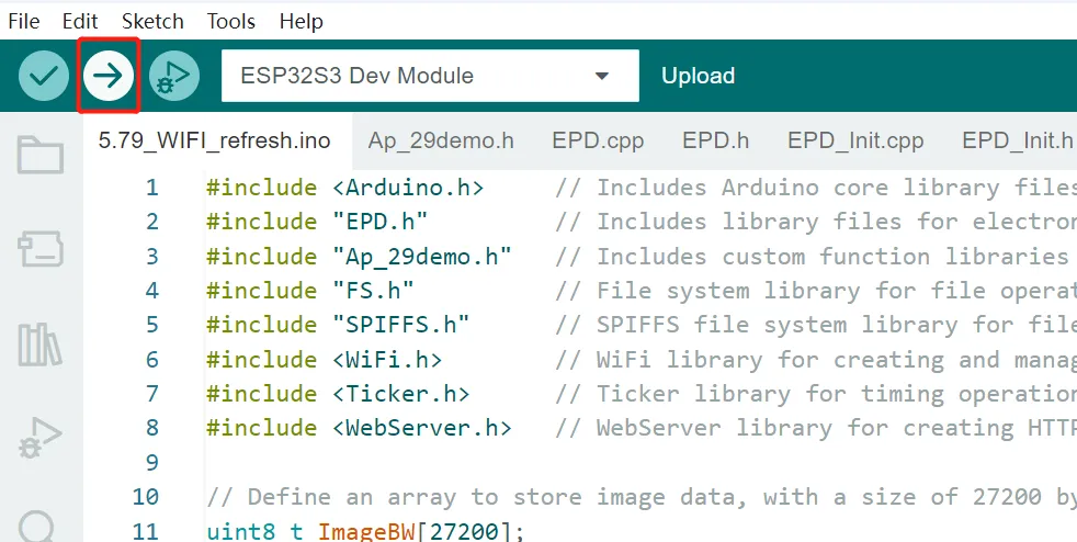

Open the 5.79_WIFI_refresh.ino

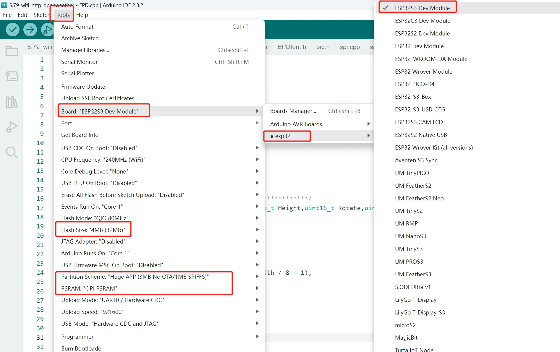

Click "Tools"->"Board"->"esp32"->"ESP32S3 Dev Module", and the "Partition Scheme" select "Huge APP (3MB No OTA/1MB SPIFFS)", "PSRAM" select "OPI PSRAM".
Connect CorwPanel to the computer, click on "Tool" and select the corresponding "port".

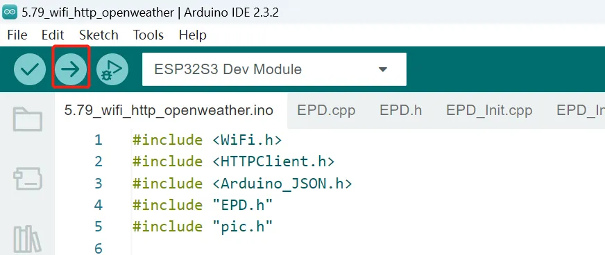

Click "Upload" to upload the code to the board. There will be an image show on the screen.

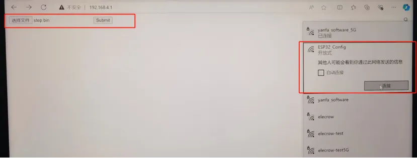

Update the price tag with WiFi¶
Connect a laptop to the hotspot of the ESP32 E-PAPER display.
Enter the IP address 192.168.4.1 in the browser.
Select the bin file of the picture you need to show, then click submit.
Note: The size of the images you transfer must be consistent with the size defined in the code, otherwise it will cause image transfer failure
After successful transmission, the price and text will be replaced, and the data will be saved in flash.

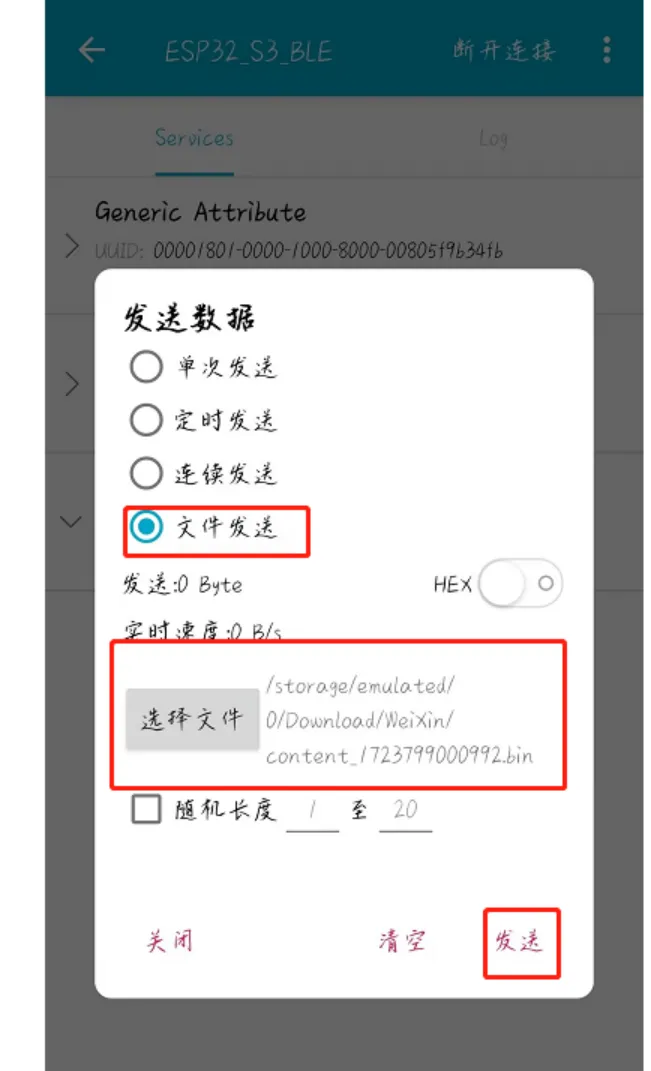

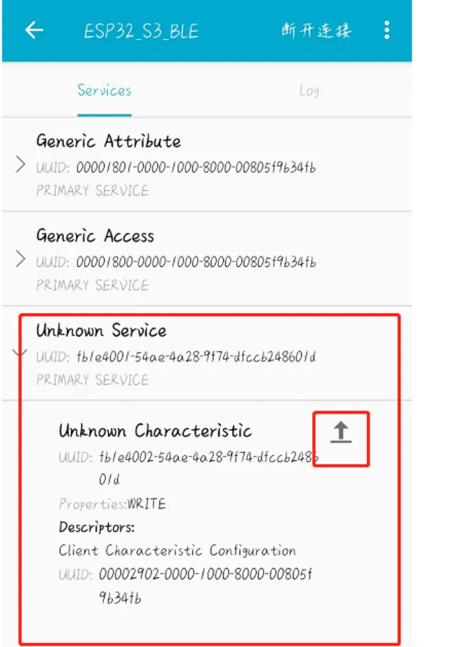

Update via Bluetooth¶
The same as the method in the "Update via WiFi".
Code Explanation¶
Please click
to download the code file 5.79_ble_refresh.zip for this demo.

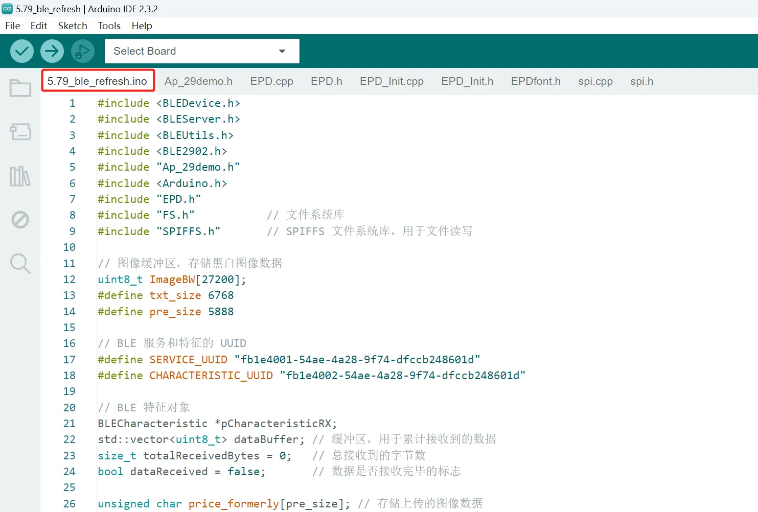

#include <BLEDevice.h>
#include <BLEServer.h>
#include <BLEUtils.h>
#include <BLE2902.h>
#include "EPD.h"
#include "FS.h" // File System Library
#include "SPIFFS.h" // SPIFFS File system library, used for file reading and writing
//Object for storing uploaded files
File fsUploadFile; //Used to manipulate files in the SPIFFS file system
ble_pic function
Process the bin file sent and determine if it matches the pre-set file size. If it does, store it in the file system and update the display icon.
void ble_pic()
// Check if data has been received
if (dataReceived) {
// Ensure that the data buffer is not empty
if (!dataBuffer.empty()) {
size_t bufferSize = dataBuffer.size();
Serial.println(bufferSize);
if (dataBuffer.size() == txt_size)//txt size
filename = "txt.bin";
else
filename = "pre.bin";
if (!filename.startsWith("/")) filename = "/" + filename;
fsUploadFile = SPIFFS.open(filename, FILE_WRITE);
fsUploadFile.write(dataBuffer.data(), dataBuffer.size());
fsUploadFile.close();
Serial.println("保存成功"); //Successfully saved
Serial.printf("保存:"); //Save:
Serial.println(filename);
if (bufferSize == txt_size )
for (int i = 0; i < txt_size; i++) {
txt_formerly[i] = dataBuffer[i];
// memcpy(txt_formerly, upload.buf, sizeof(upload.totalSize));
Serial.println("txt_formerly OK");
} else
for (int i = 0; i < pre_size; i++) {
price_formerly[i] = dataBuffer[i];
// memcpy(price_formerly, upload.buf, sizeof(upload.totalSize));
Serial.println(" price_formerlyOK");
EPD_GPIOInit(); // Initialize the GPIO pin configuration of the EPD e-ink screen again
EPD_FastMode1Init(); // Re initialize the EPD screen in Quick Mode 1
EPD_ShowPicture(0, 0, 792, 40, background_top, WHITE); // Display the gImage_stcenario_home image on the screen with a white background color
if (bufferSize != txt_size)
EPD_ShowPicture(500, 80, 256, 184, price_formerly, WHITE); // Display the gImage_stcenario_home image on the screen with a white background color
// EPD_ShowPicture(400, 60, 256, 184, price_formerly, WHITE); // Display the gImage_stcenario_home image on the screen with a white background color
} else
EPD_ShowPicture(30, 80, 376, 144, txt_formerly, WHITE); // Display the gImage_stcenario_home image on the screen with a white background color
EPD_Display(ImageBW); // Display images stored in the ImageBW array
EPD_FastUpdate(); // Perform quick updates to refresh the screen
EPD_DeepSleep(); // Set the screen to deep sleep mode to save power
// Clear the buffer after writing
dataBuffer.clear();
totalReceivedBytes = 0;
// Clear data buffer
dataBuffer.clear(); // Clear the buffer after writing
// Reset the data reception flag after processing the data
dataReceived = false;
// Clear the display screen content
void clear_all()
// Initialize the quick mode of the e-ink screen
// Clear the e-ink screen
EPD_Display_Clear();
// Update display screen
EPD_Update();
class MyCallbacks : public BLECharacteristicCallbacks
Receive the data sent and integrate it together. Receiving the "OK" character indicates that the transmission is complete.

Double click the 5.79_ble_refresh.ino.

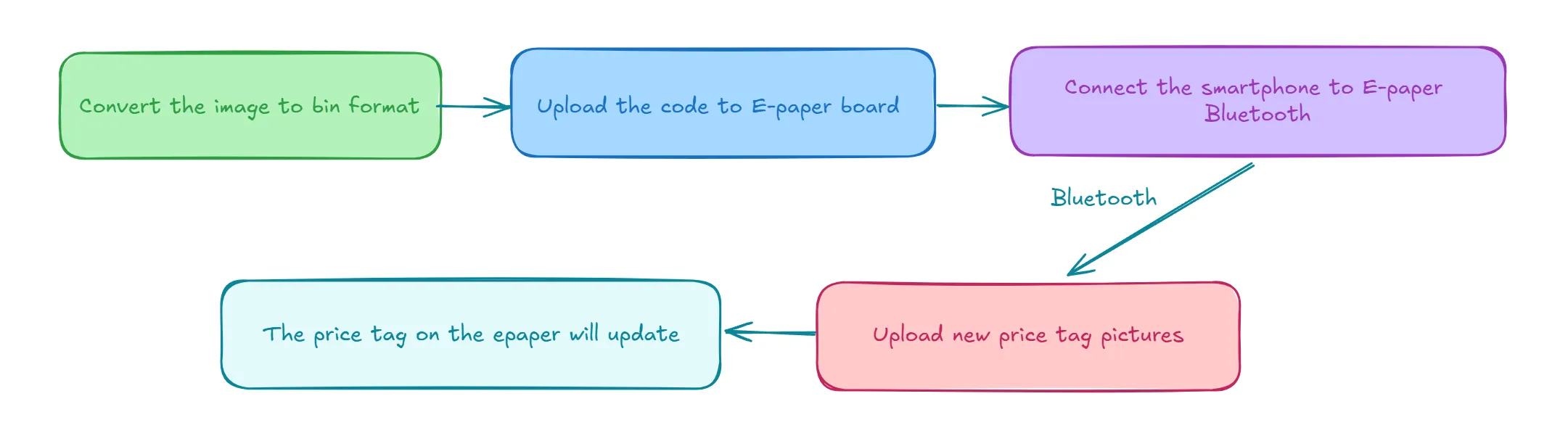

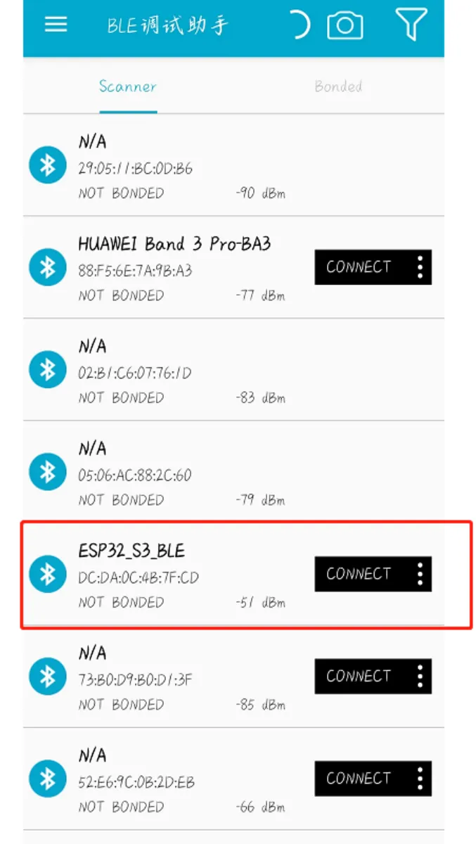

Download a BLE debugging assistant to your phone, and connect it your phone to the screen device BLE.
Upload the bin file(Save the bin file to your phone in advance).

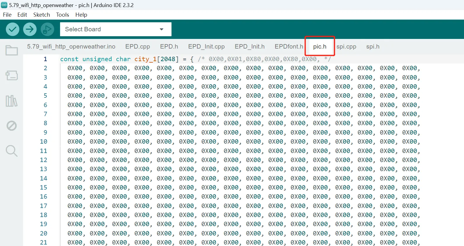

We need to convert the images of these 6 parts into C arrays and put them in the code, and combine them to form the UI interface above. The weather icon in the upper left corner is variable, while the other icons are fixed.
Click open and select the images, convert them to array format.
- Open file
- Save and output
You can put this array in a suitable header file, and I have placed it in pic. h here.

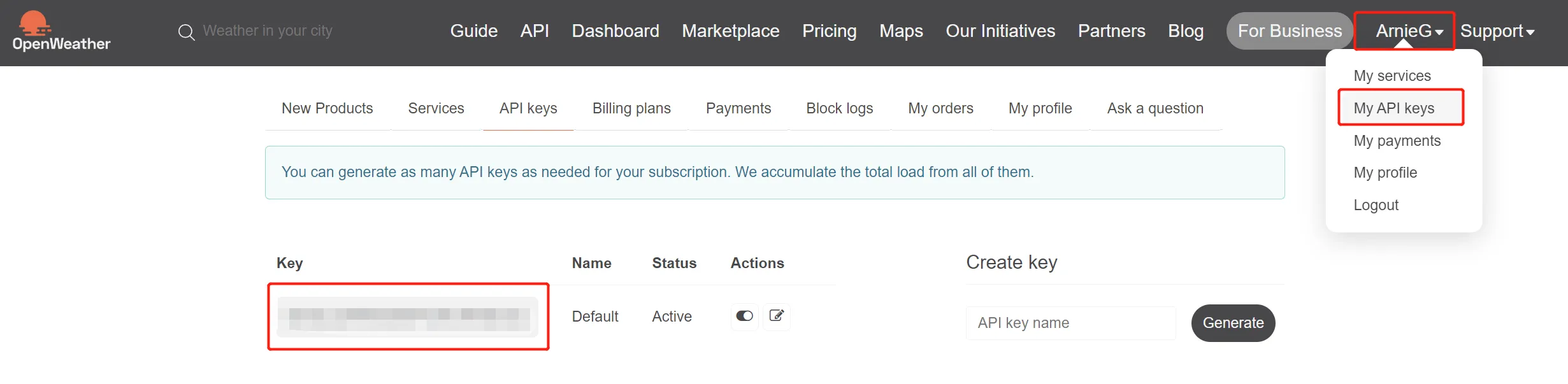

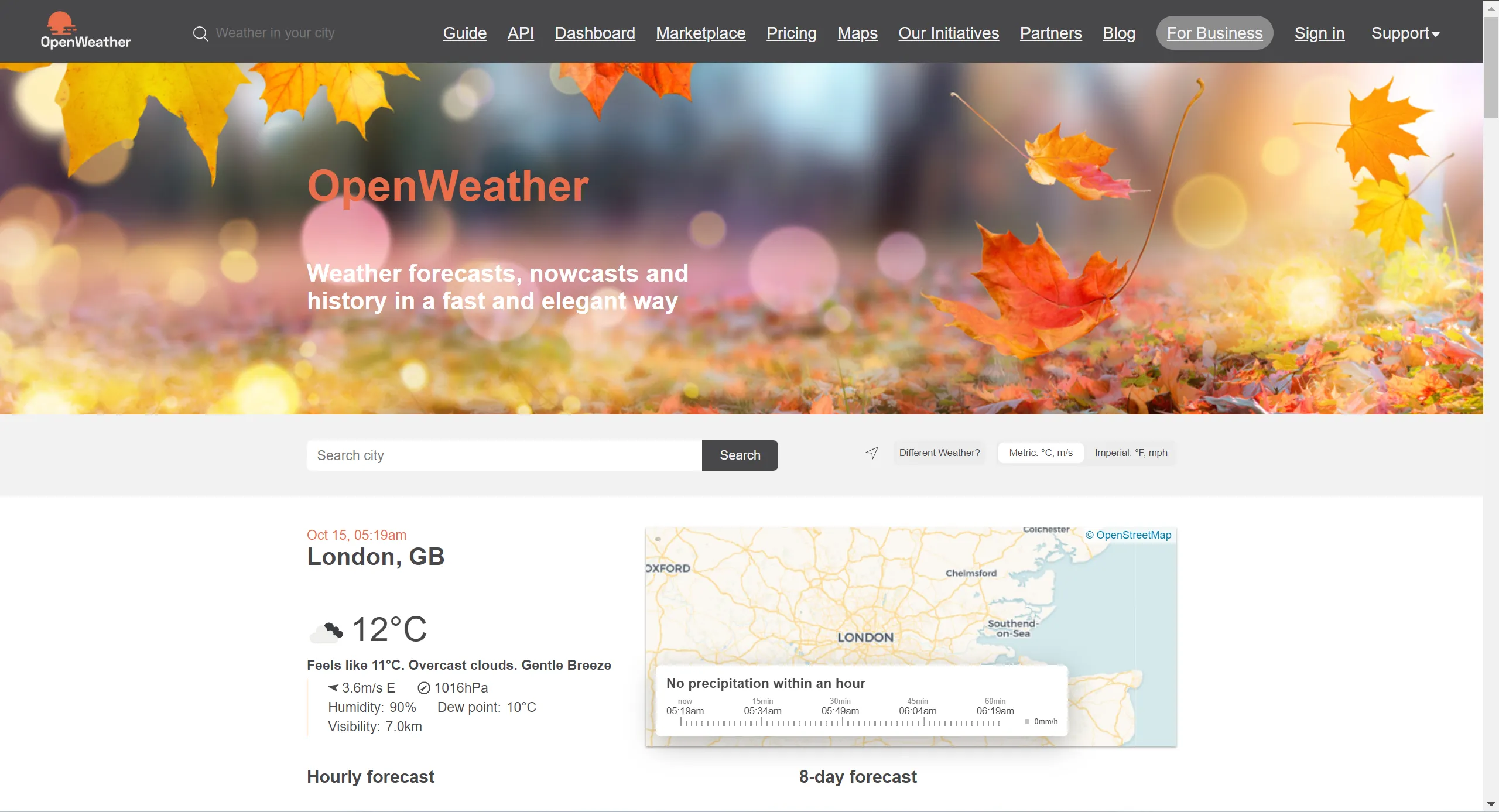

Register an OpenWeather account¶
Enter https://openweathermap.org/ and click "Sing in" to register an OpenWeather account.
Log in your account.
Click your user name -> "My API Keys" to find your API key.

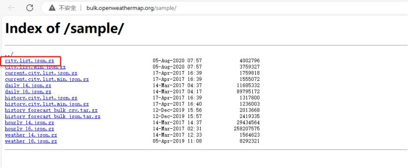

You can find the country code at: http://bulk.openweathermap.org/sample/

Double click the 5.79_wifi_http_openweather.ino.

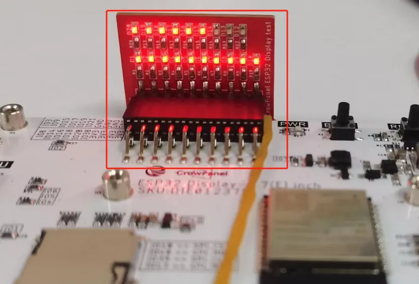

Connect the LED to the GPIO pins.
Upload the code to the CrowPanel. The LEDs will turn on, and the status of the GPIO will show on the screen.

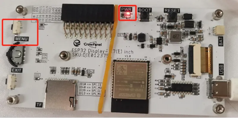

Example 3 Control PWR LED with menu Key¶
Open the 5.79_PWR.ino
#include <Arduino.h> #include "EPD.h" // Define a black and white image array as the buffer for the e-paper display uint8_t ImageBW[27200]; // Define the pin for the home button #define HOME_KEY 2 // Variable to count the state of the home button int HOME_NUM = 0; void setup() { // Initialize serial communication with a baud rate of 115200 Serial.begin(115200); // Set the screen power pin as an output and set it high to turn on the power pinMode(7, OUTPUT); digitalWrite(7, HIGH); // Set the POWER LED pin as an output pinMode(41, OUTPUT); // Set the home button pin as an input pinMode(HOME_KEY, INPUT); } void loop() { // Flag variable to indicate if any button has been pressed int flag = 0; // Check if the home button is pressed if (digitalRead(HOME_KEY) == 0) { delay(100); // Debounce delay to ensure the button press is stable // Re-check the home button state to prevent false triggering due to bouncing if (digitalRead(HOME_KEY) == 1) { Serial.println("HOME_KEY"); // Print the home button press information to the serial monitor HOME_NUM = !HOME_NUM; // Toggle the state of the home button (on/off) flag = 1; // Set the flag to indicate that the display content needs to be updated } } // If a button has been pressed, update the display content if (flag == 1) { char buffer[30]; // Buffer to store the display content // Initialize the e-paper display EPD_GPIOInit(); Paint_NewImage(ImageBW, EPD_W, EPD_H, Rotation, WHITE); Paint_Clear(WHITE); // Initialize the e-paper display and clear the previous display content EPD_FastMode1Init(); EPD_Display_Clear(); EPD_Update(); EPD_Clear_R26A6H(); // Set the state of the POWER LED and display content based on the home button state if (HOME_NUM == 1) { digitalWrite(41, HIGH); // Turn on the POWER LED strcpy(buffer, "PWR:on"); // Set the display content to "PWR:on" } else { digitalWrite(41, LOW); // Turn off the POWER LED strcpy(buffer, "PWR:off"); // Set the display content to "PWR:off" } // Display the content on the e-paper EPD_ShowString(0, 0 + 0 * 20, buffer, 16, BLACK); // Refresh the e-paper display content EPD_Display(ImageBW); EPD_PartUpdate(); EPD_DeepSleep(); // Enter deep sleep mode to save power } } -
Press the menu key and the PWR LED will turn on/off.

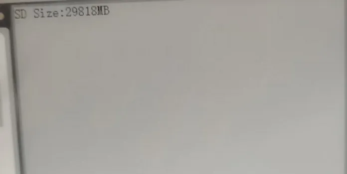

Example 4 Initialize SD card¶
Open 5.79_TF.ino
#include <Arduino.h> // Include the Arduino library #include "EPD.h" // Include the e-paper display library #include "SD.h" // Include the SD card library // Define the SPI pins for the SD card #define SD_MOSI 40 // SD card MOSI pin #define SD_MISO 13 // SD card MISO pin #define SD_SCK 39 // SD card SCK pin #define SD_CS 10 // SD card CS pin // Create an instance of SPIClass for SD card SPI communication SPIClass SD_SPI = SPIClass(HSPI); // Define a black and white image array as the buffer for the e-paper display uint8_t ImageBW[27200]; void setup() { // Initialize serial communication with a baud rate of 115200 Serial.begin(115200); // Set the screen power pin as an output and set it high to turn on the power pinMode(7, OUTPUT); digitalWrite(7, HIGH); // Set another power pin as an output and set it high to turn on the power pinMode(42, OUTPUT); digitalWrite(42, HIGH); // Brief delay to ensure power stability delay(10); // Initialize the SD card SD_SPI.begin(SD_SCK, SD_MISO, SD_MOSI); // Initialize SPI with specified pins // Try to mount the SD card file system and set the SPI clock speed to 80 MHz if (!SD.begin(SD_CS, SD_SPI, 80000000)) { // If SD card initialization fails, print error message to the serial monitor Serial.println(F("ERROR: File system mount failed!")); } else { // If SD card initialization succeeds, print SD card size information to the serial monitor Serial.printf("SD Size: %lluMB \n", SD.cardSize() / (1024 * 1024)); // Create a buffer to store the display content char buffer[30]; // Assume the display content will not exceed 30 characters // Use sprintf to format the string and store the SD card size information in buffer int length = sprintf(buffer, "SD Size:%lluMB", SD.cardSize() / (1024 * 1024)); buffer[length] = '\0'; // Ensure the string ends with a null character // Initialize the e-paper display EPD_GPIOInit(); // Initialize the GPIO pins for the e-paper Paint_NewImage(ImageBW, EPD_W, EPD_H, Rotation, WHITE); // Create a new image Paint_Clear(WHITE); // Clear the image, fill with white // Recreate and clear the image Paint_NewImage(ImageBW, EPD_W, EPD_H, Rotation, WHITE); Paint_Clear(WHITE); // Initialize the e-paper display mode EPD_FastMode1Init(); EPD_Display_Clear(); // Clear the e-paper display EPD_Update(); // Update the e-paper display EPD_Clear_R26A6H(); // Further clear the display // Print the display content to the serial monitor Serial.println(buffer); // Display the content on the e-paper EPD_ShowString(0, 0, buffer, 16, BLACK); // Draw the string on the e-paper // Refresh the e-paper display content EPD_Display(ImageBW); EPD_PartUpdate(); EPD_DeepSleep(); // Enter deep sleep mode to save power } } void loop() { // Main loop code delay(10); // Wait for 10 milliseconds } -
Insert the TF card to the card slot.
The size of the TF card will show on the screen.

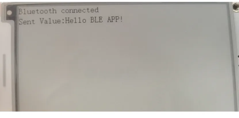

Example 5 Connect Bluetooth¶
Open 5.79_BLE.ino
After the blutooth is connected, the screen will show:
