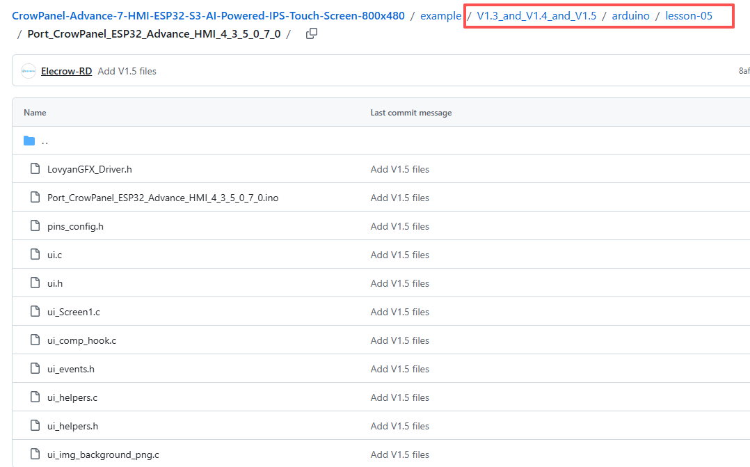

Click on the link below to download the code for this lesson:
