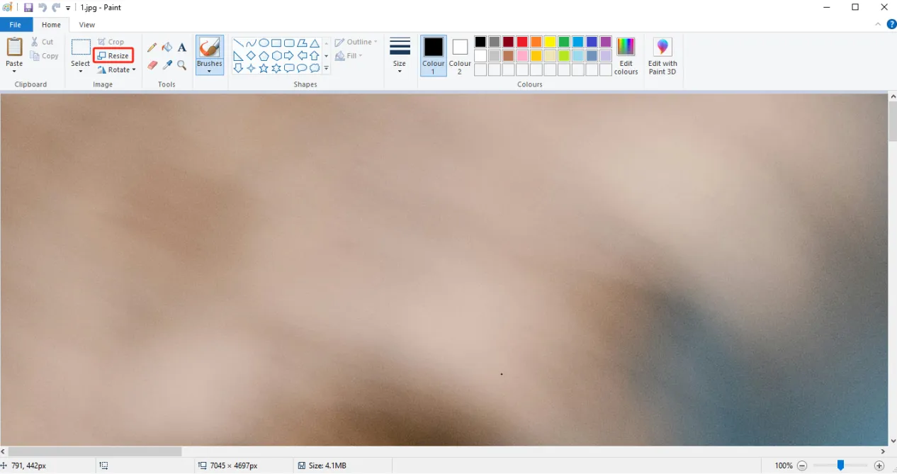

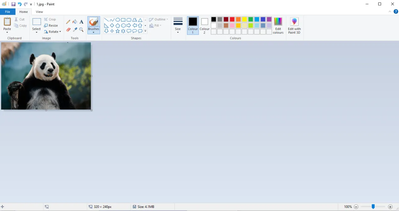

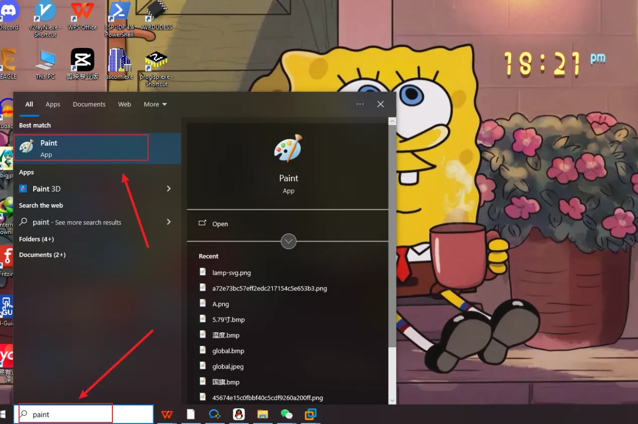

First, open the "paint" tool on the computer.
3

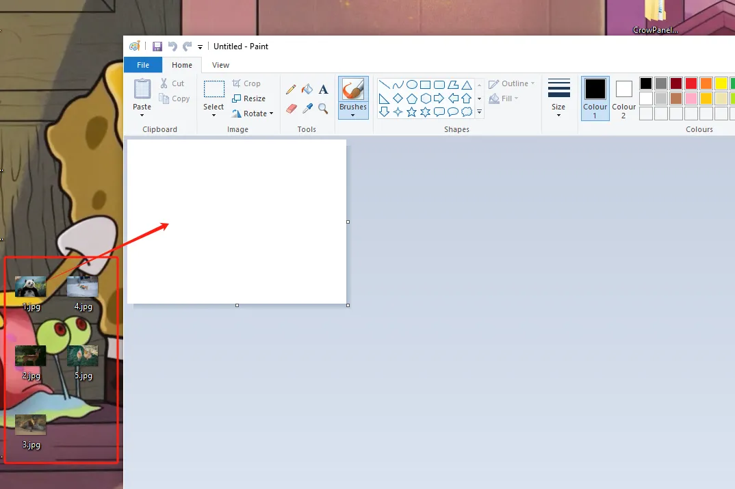

Drag and drop the image into the "paint" tool to readjust the pixels of the image
(Images can be uploaded to the browser and selected according to everyone's preferences)
4
5

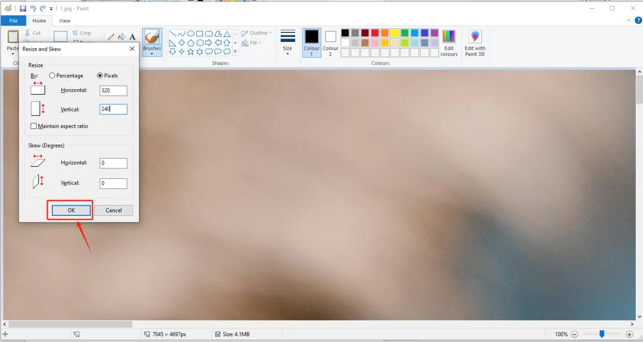

Adjust the pixel to 2.4-inch screen resolution: 320x240
(If you are using a different size, please set the correct resolution)
Can be referred to:There are resolutions of different sizes as references above. (Second point)
6
Click confirm
7
Adjust the resolution of the image as shown in the picture

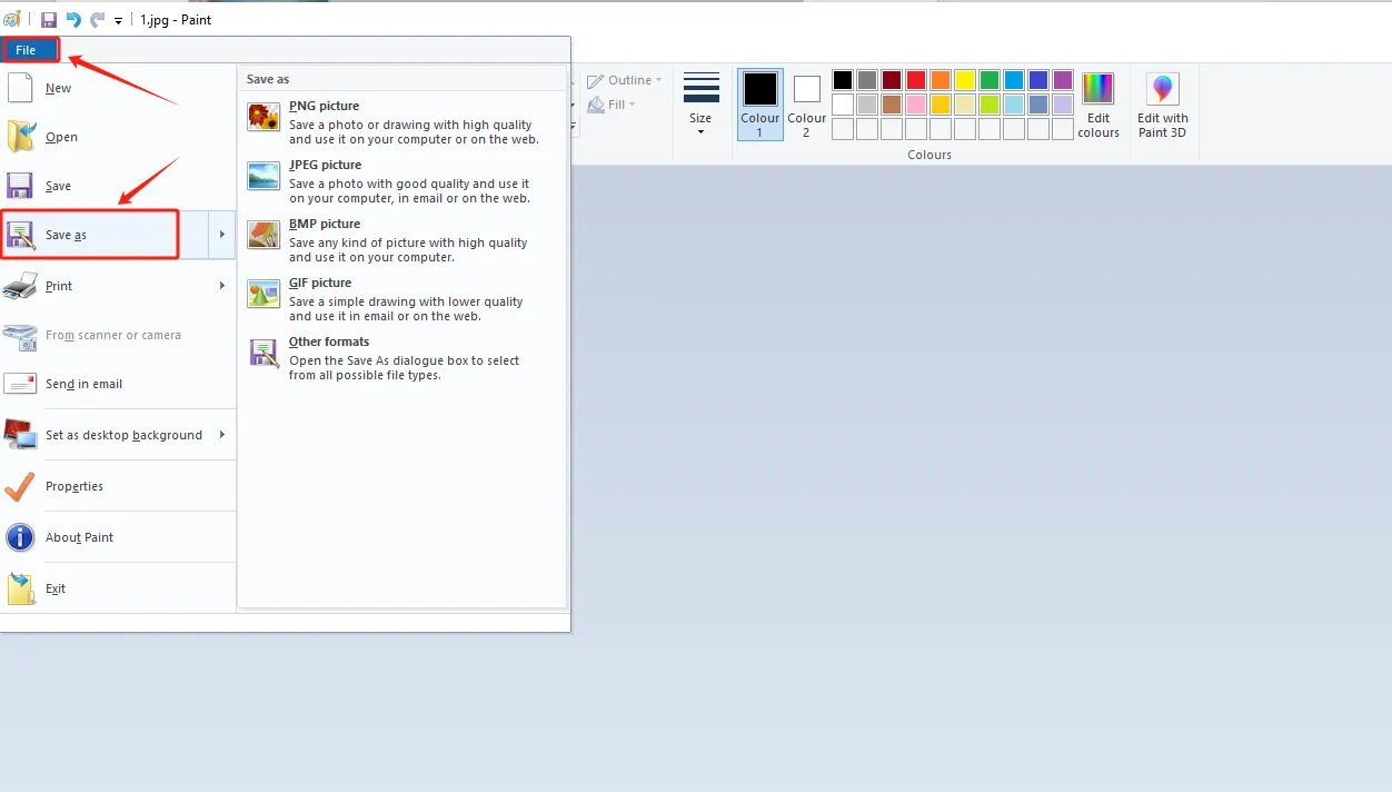

Save to a folder for easy use (folder path can be customized)
9

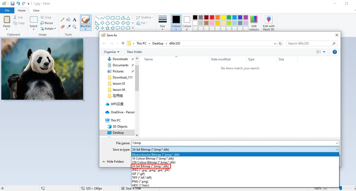

Save in BMP format (must have a 24 bit image depth)
10

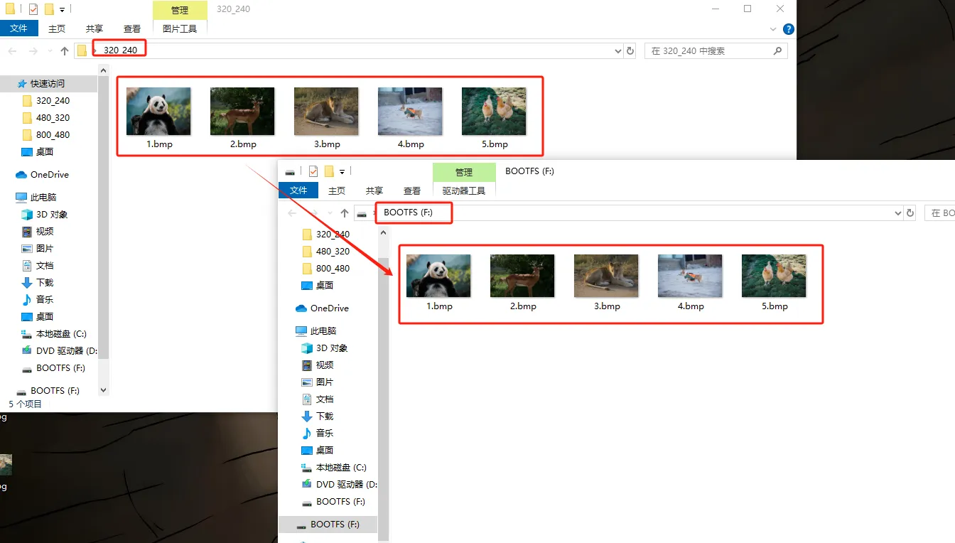

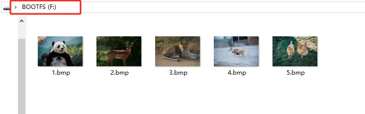

Insert the SD card into the card reader
11
Open the SD drive, copy the modified image to the SD drive and save it
12

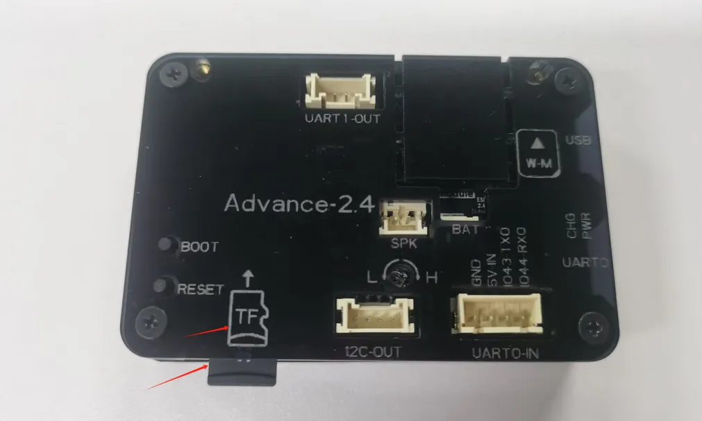

3 Insert the SD card containing this saved image into your CrowPanel ESP32 Advance HMI
13
(2.4 inch, 2.8 inch, 3.5 inch products can be directly inserted for use)
14

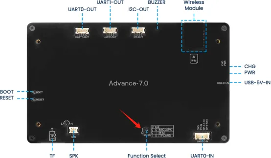

(After inserting the SD card, turn the function switch to 1 0 mode (TF Card mode) for 4.3-inch, 5.0-inch and 7.0-inch.)

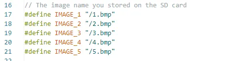

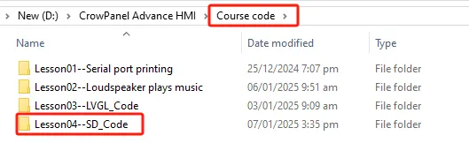

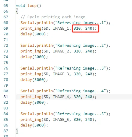

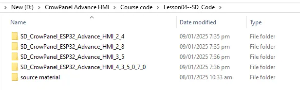

4 Open the code we provide, and you only need to modify the path and name of the image you saved
15
16
Modify the path of the image you saved
17
Here, my path is the five images in the current path on the SD card
So the path of my image is the current path "/" plus the image name (1. bmp)
18

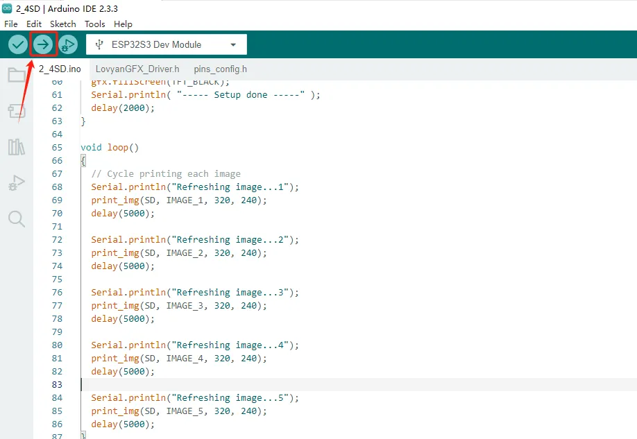

Then display the image in the loop and set the resolution size
(different sizes have different resolutions)
19
5 Configure the runtime environment and burn code
(Before burning, please replace the relevant library files according to different sizes.
How to replace, details in Lesson 2)
20
21

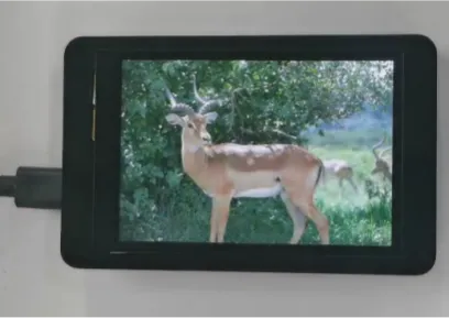

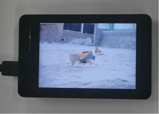

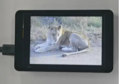

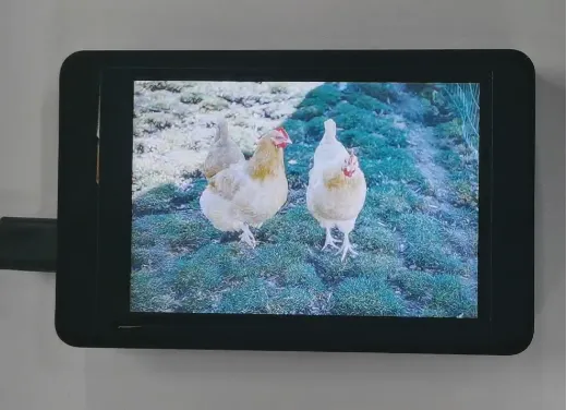

6 Phenomenon display
22
23
24
25
26

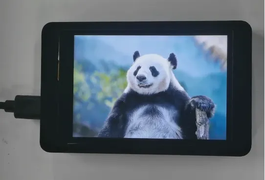

The five photos I saved on the SD card will be displayed in a loop.

2.8inch、2.4inch
#include "pins_config.h"
#include "LovyanGFX_Driver.h"
#include <Wire.h>
#include <SPI.h>
#include <FS.h>
#include <SD.h>
#include <Adafruit_SSD1306.h>
#include <Adafruit_GFX.h>
#define SD_MOSI 6
#define SD_MISO 4
#define SD_SCK 5
#define SD_CS 7 //The chip selector pin is not connected to IO
// The image name you stored on the SD card
#define IMAGE_1 "/1.bmp"
#define IMAGE_2 "/2.bmp"
#define IMAGE_3 "/3.bmp"
#define IMAGE_4 "/4.bmp"
#define IMAGE_5 "/5.bmp"
SPIClass SD_SPI = SPIClass(HSPI);
LGFX gfx;
// Display text on the screen
void show_test(int lcd_w, int lcd_h, int x, int y, const char * text)
  gfx.fillScreen(TFT_BLACK);
  gfx.setTextSize(3);
  gfx.setTextColor(TFT_RED);
  gfx.setCursor(x, y);
  gfx.print(text);
void setup()
  Serial.begin(115200);//set baud rate
  // Init Display
  gfx.init();
  gfx.initDMA();
  gfx.startWrite();
  delay(500);
  /* Turn on backlight */
  pinMode(38, OUTPUT);
  digitalWrite(38, HIGH);
 if (SD_init() == 0)
    Serial.println("TF_Card initialization succeeded");
    show_test(LCD_H_RES, LCD_V_RES, 75, 150, "SD_Card OK");
    delay(3000);
  } else {
    Serial.println("TF card initialization failed");
    show_test(LCD_H_RES, LCD_V_RES, 75, 150, "SD_Card failed");
    delay(3000);
  gfx.setRotation(2);
  Serial.println( "----- Setup done -----" );
void loop()
  // Cycle printing each image
  Serial.println("Refreshing image...1");
  displayImage(SD, IMAGE_1, 320, 240);
  delay(5000);
  Serial.println("Refreshing image...2");
  displayImage(SD, IMAGE_2, 320, 240);
  delay(5000);
  Serial.println("Refreshing image...3");
  displayImage(SD, IMAGE_3, 320, 240);
  delay(5000);
  Serial.println("Refreshing image...4");
  displayImage(SD, IMAGE_4, 320, 240);
  delay(5000);
  Serial.println("Refreshing image...5");
  displayImage(SD, IMAGE_5, 320, 240);
  delay(5000);
// SD card initialization
int SD_init()
  SD_SPI.begin(SD_SCK, SD_MISO, SD_MOSI);
  if (!SD.begin(SD_CS, SD_SPI, 80000000))
    Serial.println(F("ERROR: File system mount failed!"));
    SD_SPI.end();
    return 1;
  else
    Serial.println("Card Mount Successed");
    Serial.printf("SD Size: %lluMB \n", SD.cardSize() / (1024 * 1024));
  listDir(SD, "/", 2);
  Serial.println("**** TF Card init finished ****.");
  return 0;
