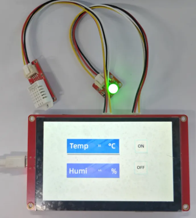

he example tutorial is an environmental monitoring project, demonstrate how to create a UI and use a sensor to obtain the environment temperature and humidity and display it on the screen; and how to control the LED on and off by the buttons on the screen.
In this tutorial, we will show you how to design the UI with SquareLine Studio, and show you how to upload the code with Thonny IDE.

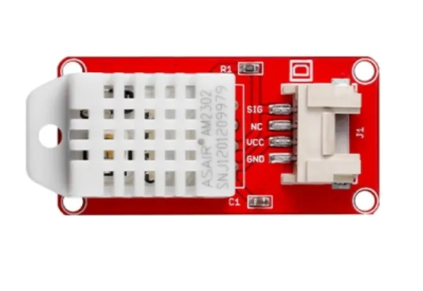

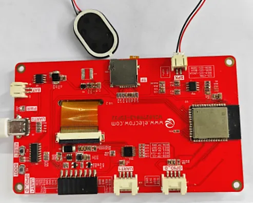

| CrowPanel ESP32 5.0'' HMI | Crowtail-AM2302 | Crowtail-LED | Crowtail Cable |

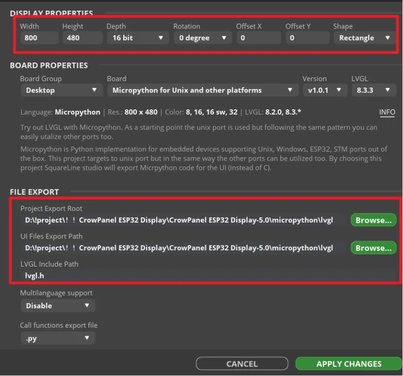

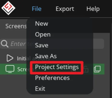

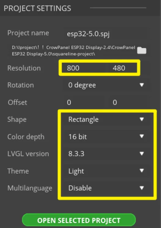

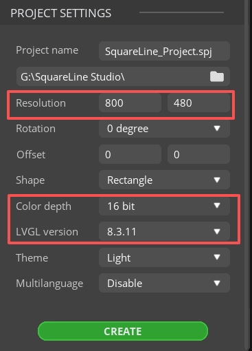

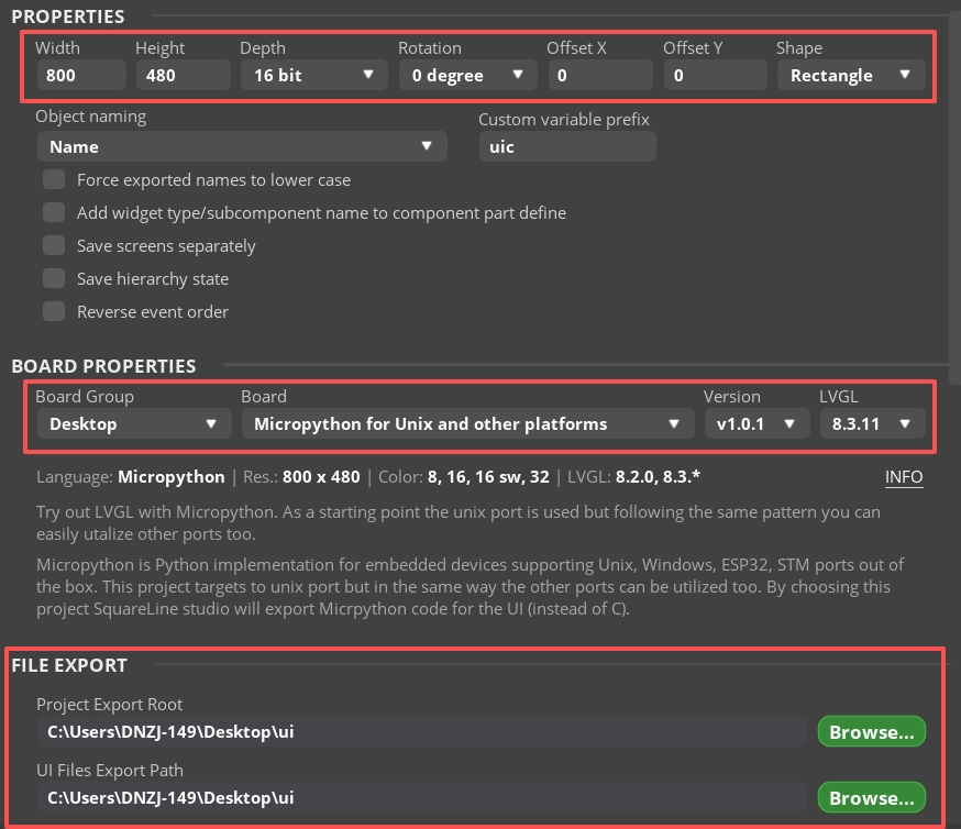

Open the SquareLine Studio and create a project. Select "Desktop"->"Micropython for Unix and other platform".
Set the name of the project, set the screen resolution to 800*480, set the color depth to 16bit, and keep other default settings. After setting, click CREATE to create the project.

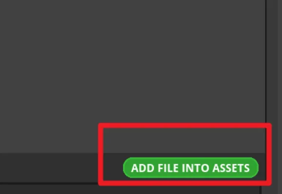

Please click
to download the custom images used in this tutorial. -

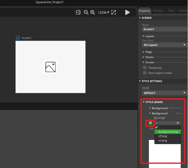

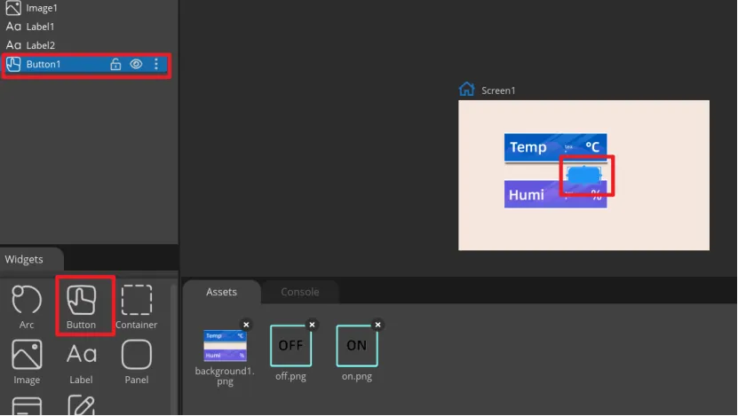

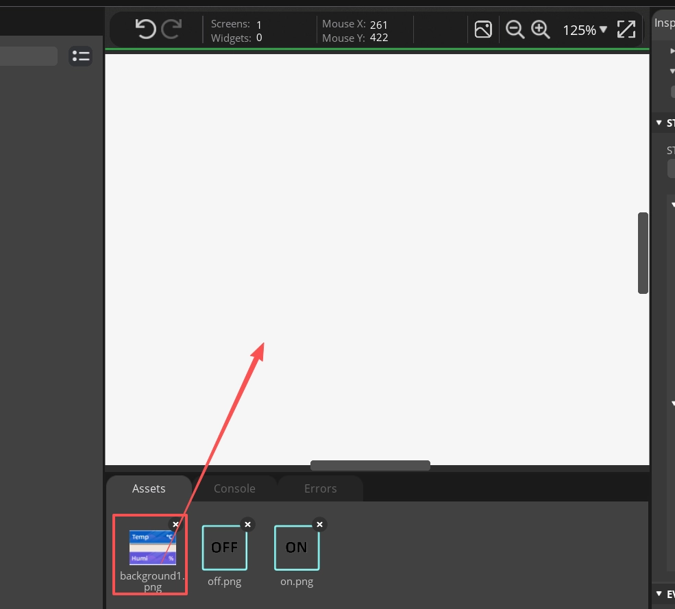

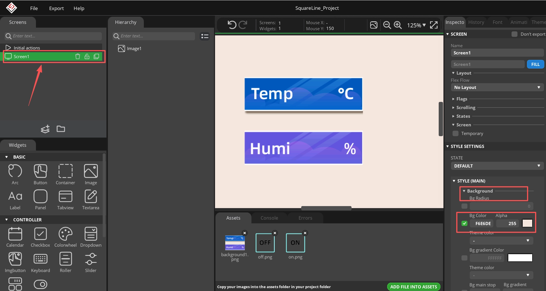

Add background.

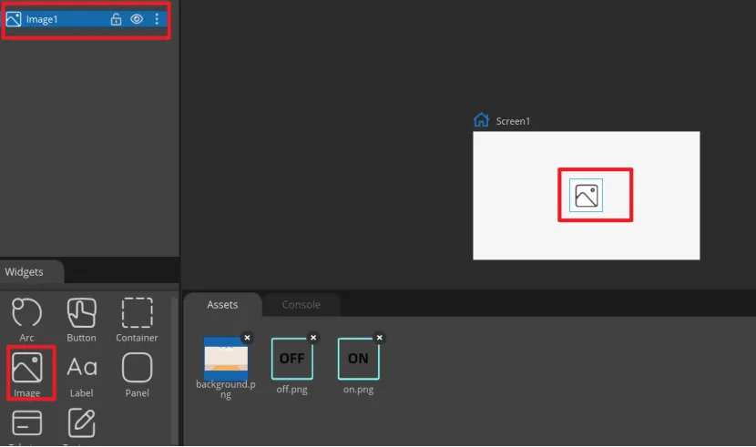

Click "Image" to add the image widgets.

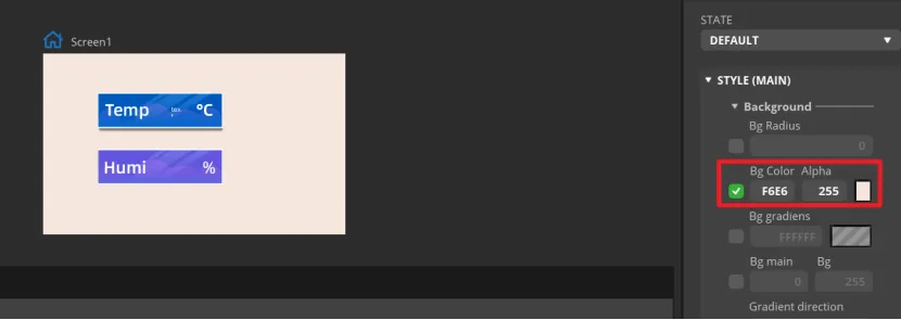

Find "Inspector"->"STYLE SETTING", click to expand "STYLE(MAIN)", then click the 2nd "Background". Check the "Bg Image" and select a background picture.

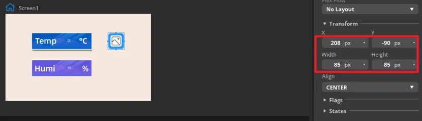

Adjust the position of the image.
Note: Because it requires a large amount of memory when running in Thonny IDE, the UI background resolution of this tutorial is small and not full screen, so it is necessary to modify the background to the same color as the image.

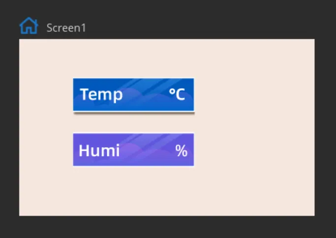

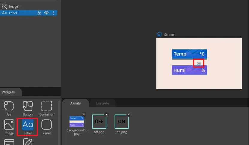

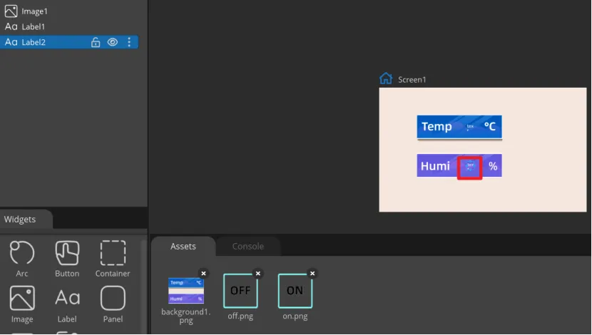

Add Label widget to show temperature and humidity value

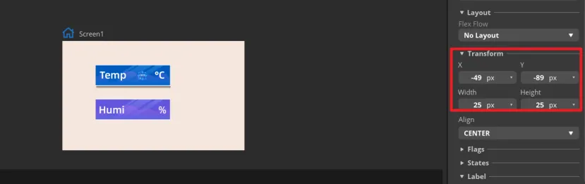

The content, position and size of the label can be adjusted by dragging the mouse. You can also directly enter numbers in the Inspector→LABEL→Transform to adjust. You can set the font color and other attributes in STYLE SETTING→STYLE(MAIN).
You can set the color and other attributes of the font in STYLE SETTING ->STYLE (MAIN).

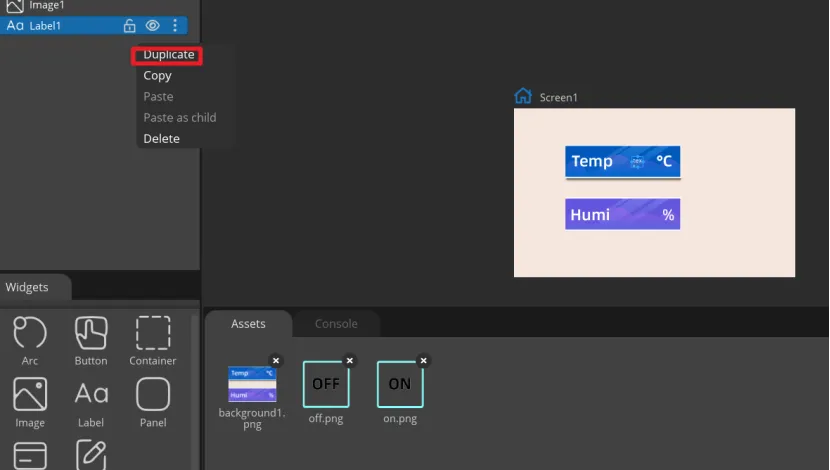

Duplicate a Label2 to show humidity value.
Adjust the position.

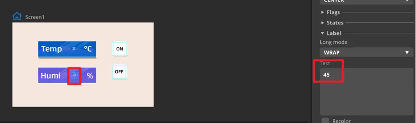

You can change the text of the label to set a default value.

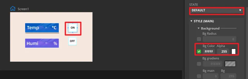

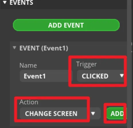

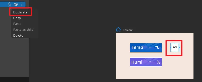

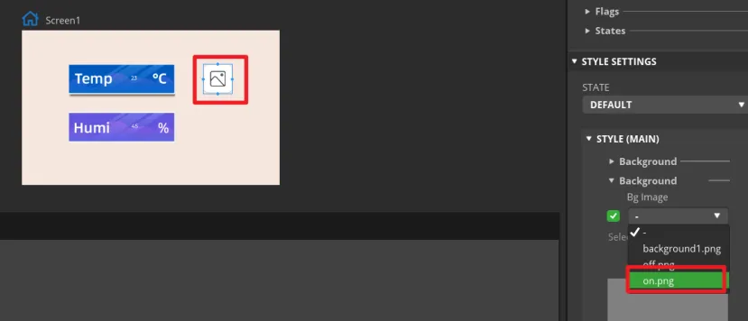

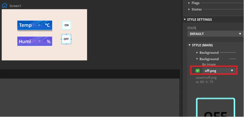

Duplicate a Button2 for "OFF".

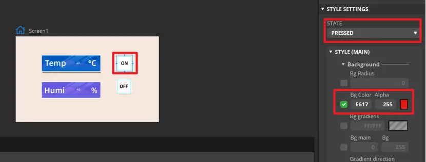

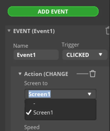

Add events to buttons.

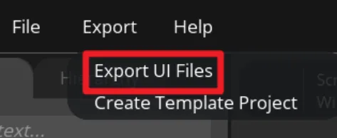

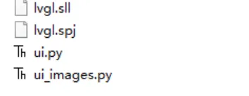

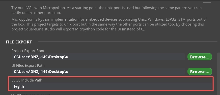

Export UI files.
Then click "APPLY CHANGES".
The UI file export is completed. Next we're going to learn about the main program and learn how to upload the code to the board with Thonny IDE.

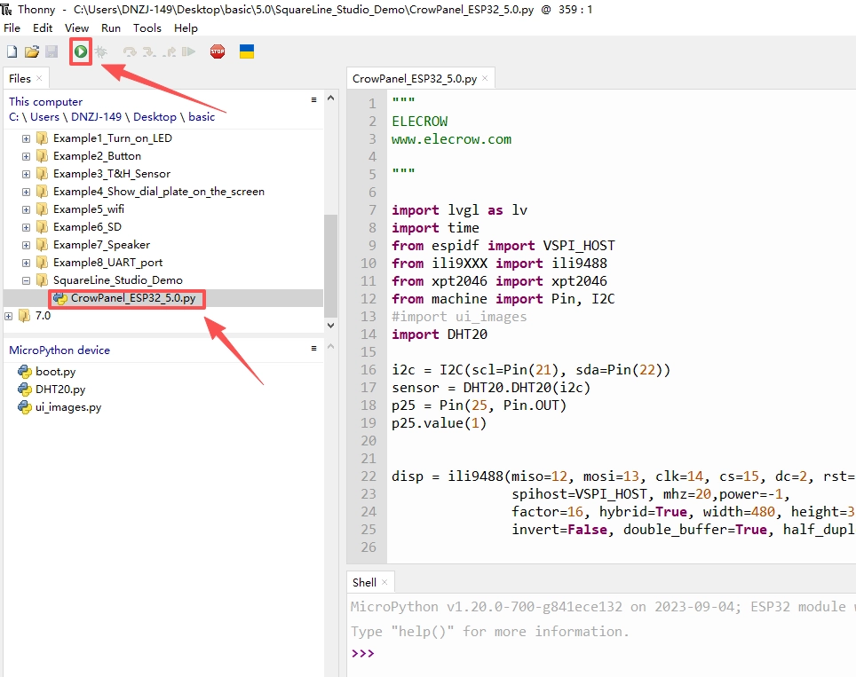

Build the Project with Thonny IDE¶
Download Thonny IDE¶
Go to the website https://thonny.org/ and download the corresponding software version (here we take the Windows version as an example)
Double-click the downloaded exe file to install the software.
Upload firmware¶

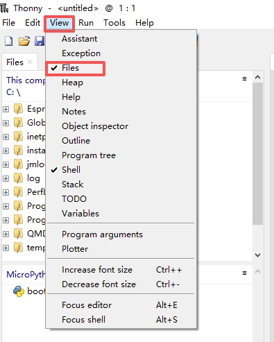

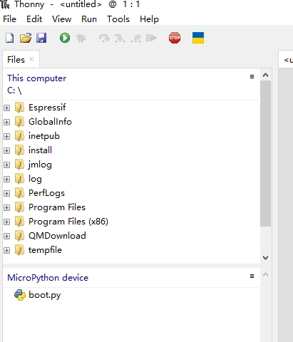

Connect the CrowPanel ESP32 HMI with your computer.

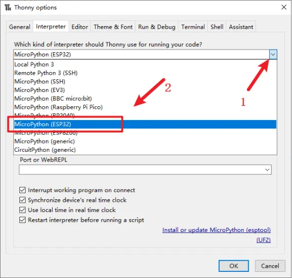

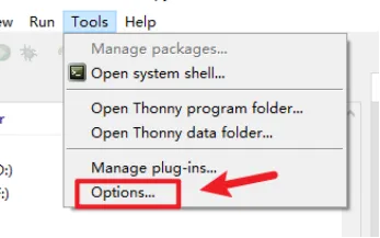

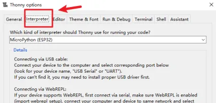

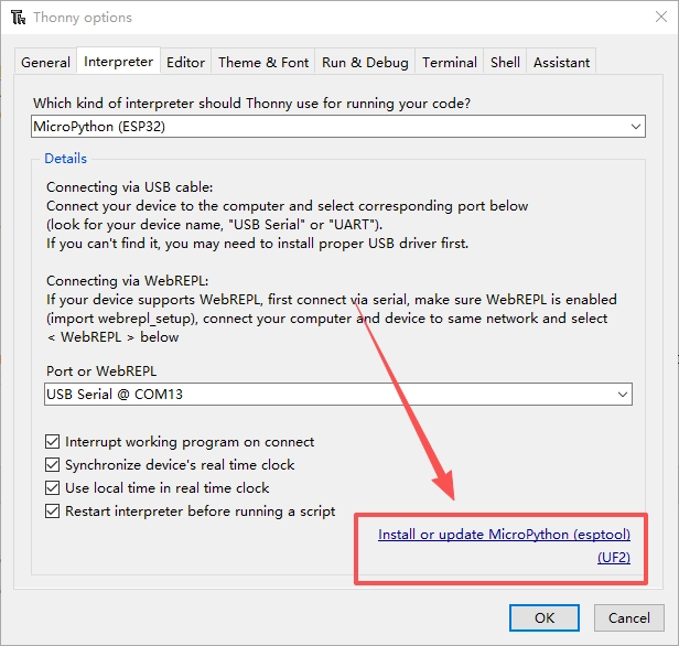

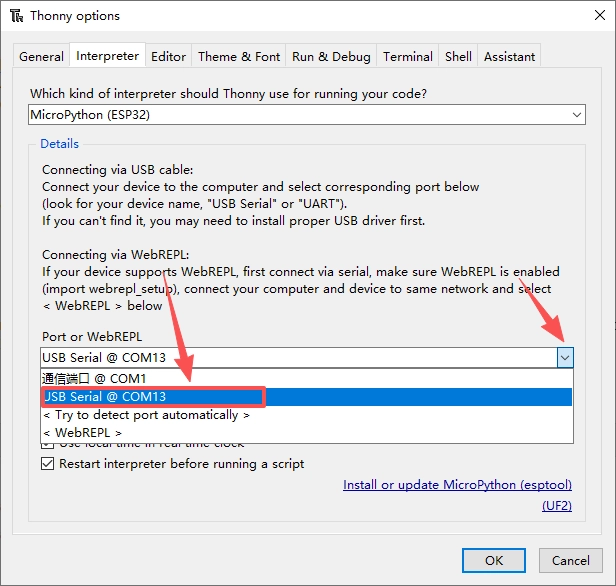

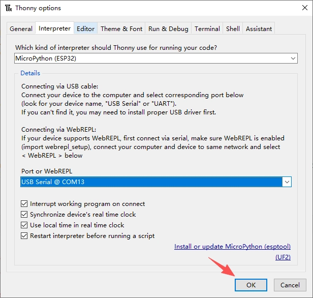

Open Thonny IDE and click "Tools"->"Options"->"Interpreter".
Select "MicroPython(ESP32)" for interpreter.
Select the corresponding serial port(or Try to detect port automatically).

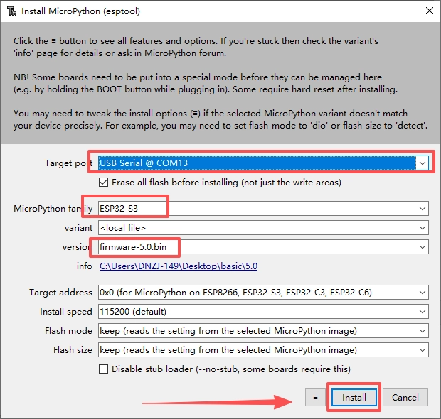

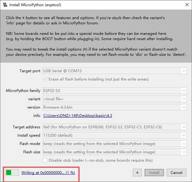

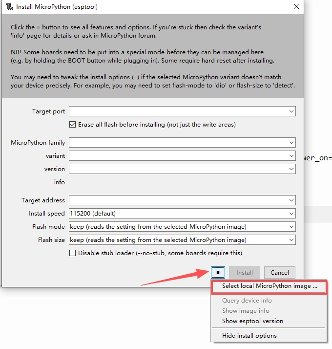

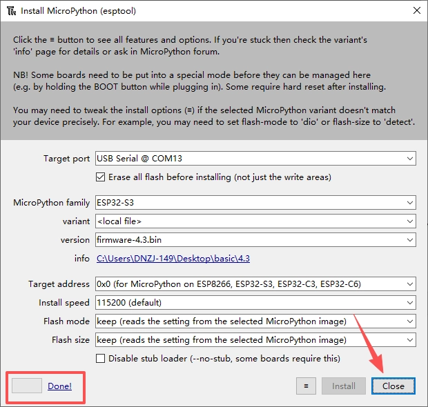

Click "Install or update MicroPython (esptool)"

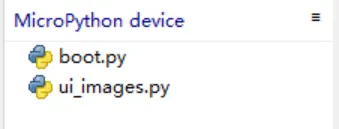

Click the icon with 3 lines, and click "select local MicroPython image...".Select the "firmware-5.0-A.bin" and install.
Waiting for downloading...

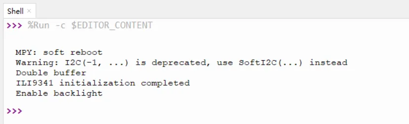

Edit the code¶

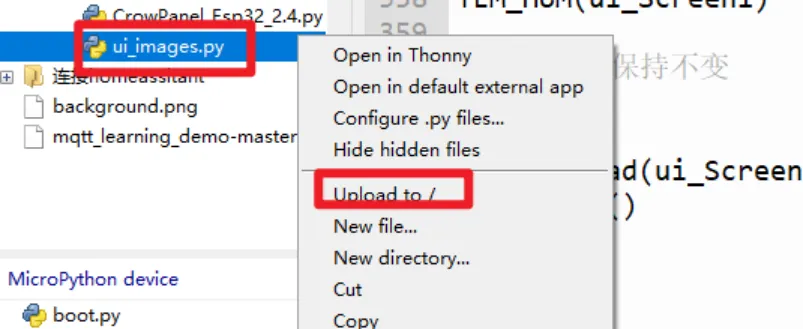

Please click
to download the code file and libraries.

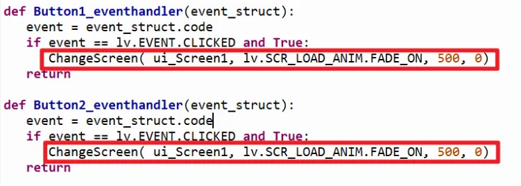

def Button1_eventhandler(event_struct):
event = event_struct.code
if event == lv.EVENT.CLICKED and True:
pin38.value(1)
return
def Button2_eventhandler(event_struct):
pin38.value(0)
return

Set up LED and sensor.
pin38 = Pin(38, Pin.OUT)# Set GPIO pin 38 to output mode
pin38.value(0)
#Initialize DHT22 temperature and humidity sensor
sensor = dht.DHT22(Pin(44)) # Create a DHT22 object and specify the GPIO pin to connect to

This part copies the code of ui.py generated by Squareline Studio. We need to modify the part that control the button.
Modify from
to
pin38.value(1)
return
pin38.value(0)
return

Upload the code¶
Please click

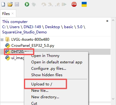

Upload the libraries¶
ui_image.py
In the upper left corner of the thonny, enter the path where ui_image.py is located, right-click ui_image.py, and click Upload to/
ui_image.py is added to MicroPython device successfully.
Upload the code¶
Click the "run" icon.
Successfully uploaded.

Example 1 Turn on/off the LED automatically in a loop¶
Connect an LED module to the D port(pin38) of ESP32 5.0'' HMI, and upload the following code. The LED will turn on and off in a loop.

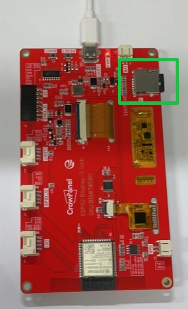

Example 5 Initialize SD card¶

Example 6 Playing music¶
Connect a speaker to the ESP32 HMI. Upload the following code.
