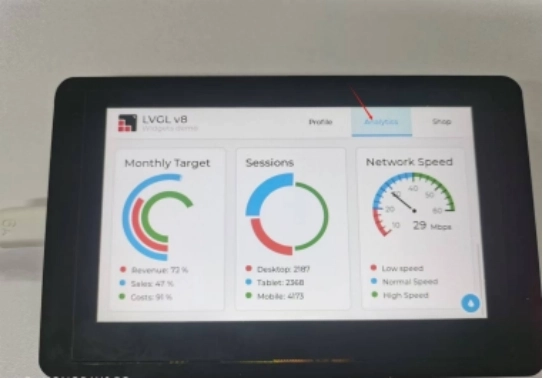

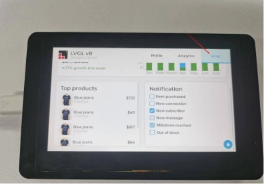

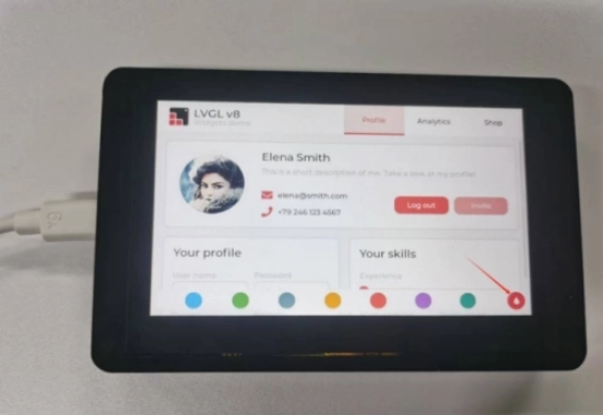

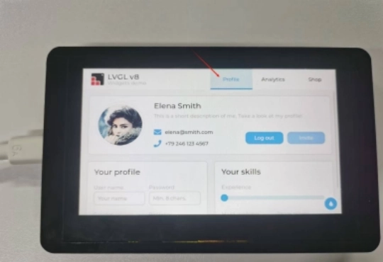

When you power on the product, you will see the following interface.
(The interface has not yet developed any functions and can only be viewed by sliding the interface.)
However, you can choose the theme color you want to use.

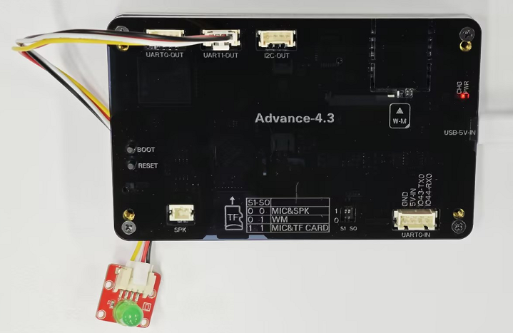

Connect the development board to the computer with a Type-C cable.

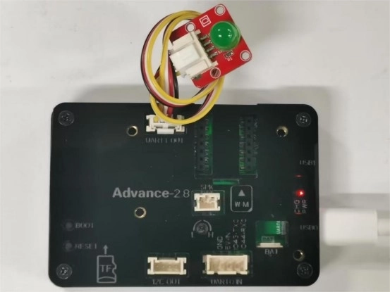

Note: For the development boards with sizes of 2.4 inches, 2.8 inches, and 3.5 inches, the default interface for flashing is USB0. For the development boards with sizes of 4.3 inches, 5.0 inches, and 7.0 inches, insert the small light bulb into the UART1-OUT port, and for development boards of other sizes, insert it into the UART-OUT port.

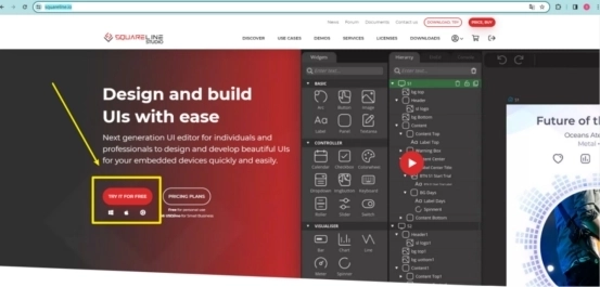

3. Install SquareLine Studio
3.1 Installation Guide
Download the version 1.4.0

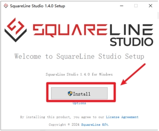

Click install.

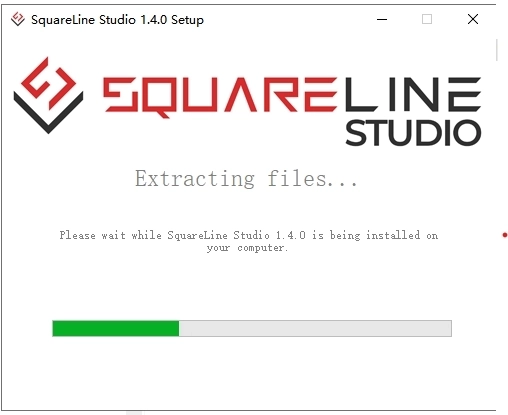

Wait for installation.
Installation finish.

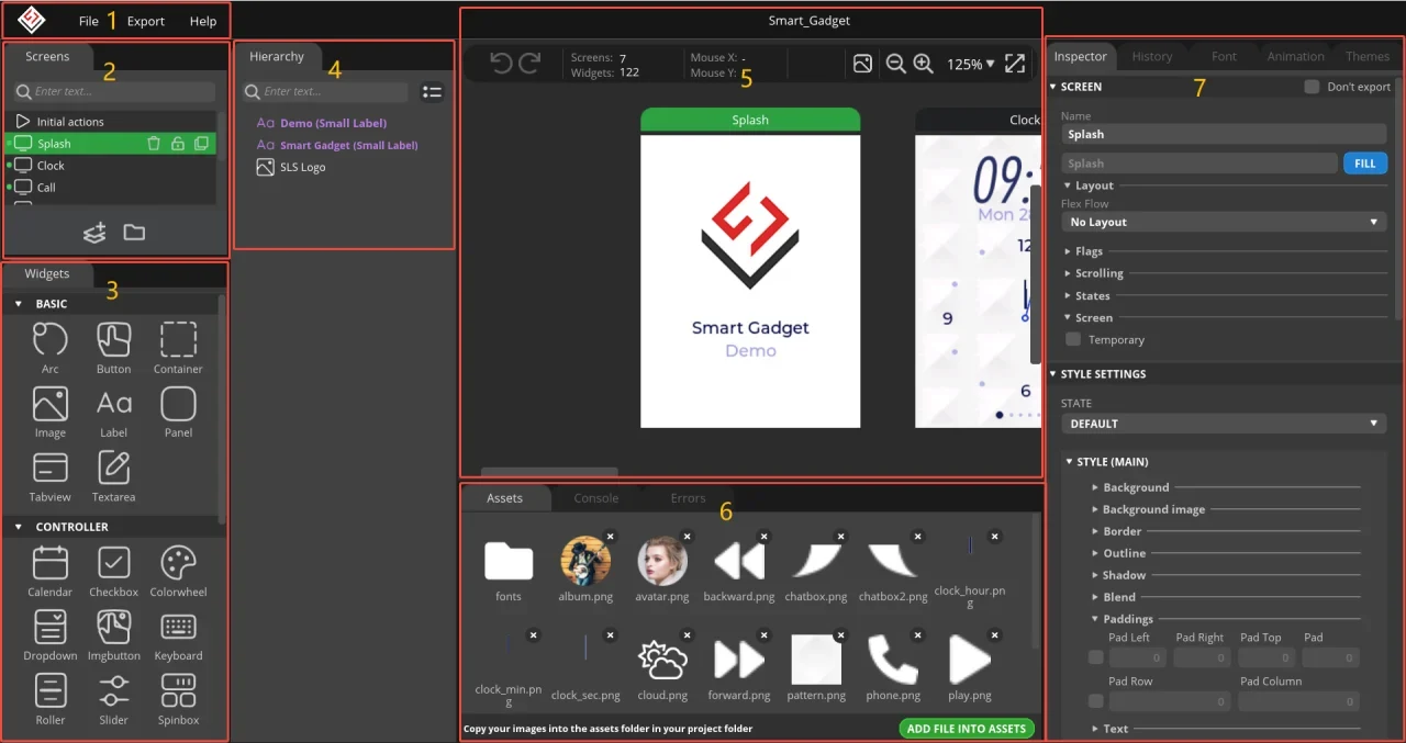

3.2 Software Function Introduction

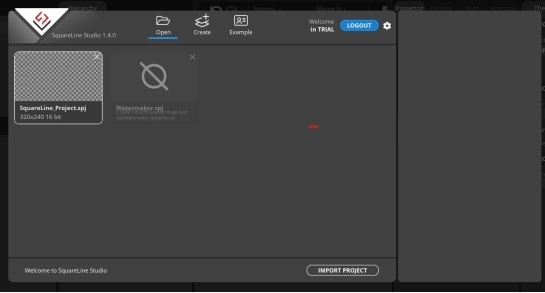

Open the software
Note:Please select the corresponding resolution and color depth according to the screen specifications.
①Toolbar, including File, Export, and Help. Basic file operation bar, create or open files, export UI files and other operations. Click help and there are related introductory documents.
②Screen bar, the project screen will be listed here.

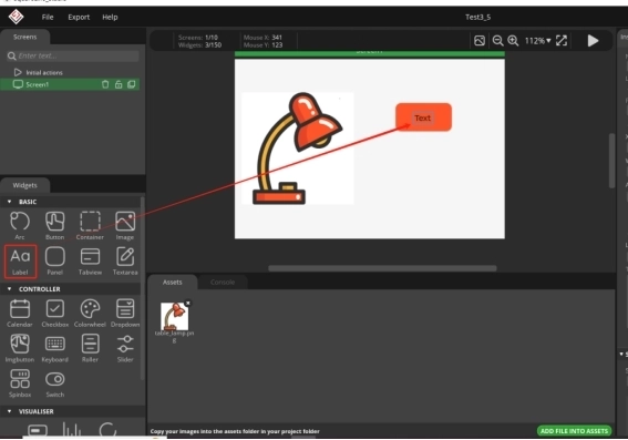

③Widget area, all widgets are here and can be selected and used according to project needs.
④Hierarchy area, it will show every widget used in each screen.
⑤This area shows the actual display effect, you can adjust the widgets or screen here.
⑥Material column, the added materials are displayed here.
⑦Setting bar, where you can make basic settings for each part, including the basic attributes and trigger operations of the part.

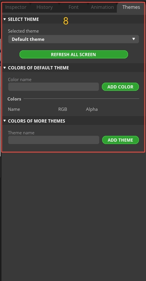

⑧Theme bar, different themes can be set.

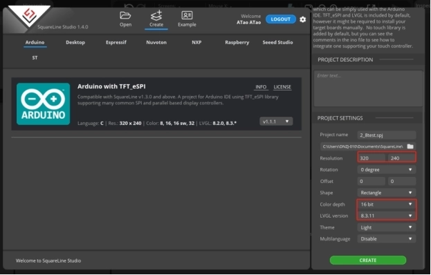

4.1 Create a new SquareLine Studio project.
Here, I take a 2.8-inch screen as an example. After determining the resolution, I fill it in

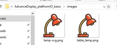

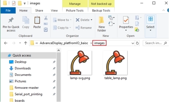

The images can be found at the following location:
https://github.com/Elecrow-RD/CrowPanel-Advance-4.3-HMI-ESP32-S3-AI-Powered-IPS-Touch-Screen-800x480/tree/master/Squareline_studio%20Instructions%20for%20use/code
Table_1amp image sizes are available for 3.5-inch, 4.3-inch, 5.0-inch, and 7-inch screens.

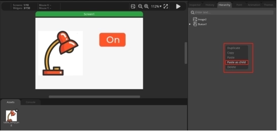

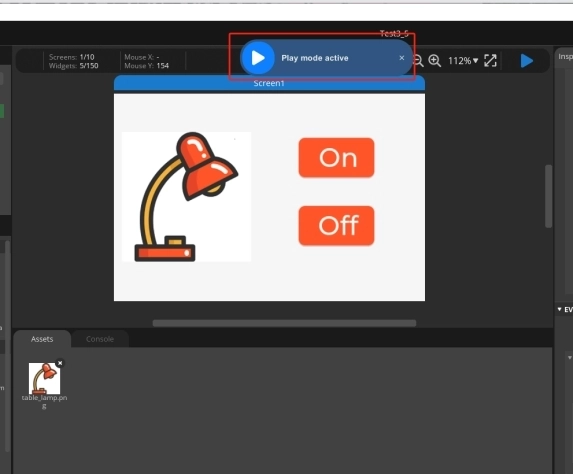

4.2 Add functions to the buttons to enable them to turn on and off lights
Select 'event' to add in the right sidebar.
After selecting, click ADD.
After adding, run

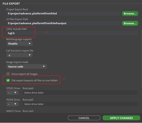

4.3 UI interface design completed, exporting UI files for easy use in subsequent code

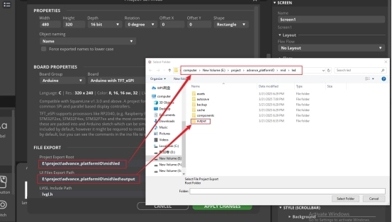

Click on Project Setting
Set export path.
Complete the setup and export file.

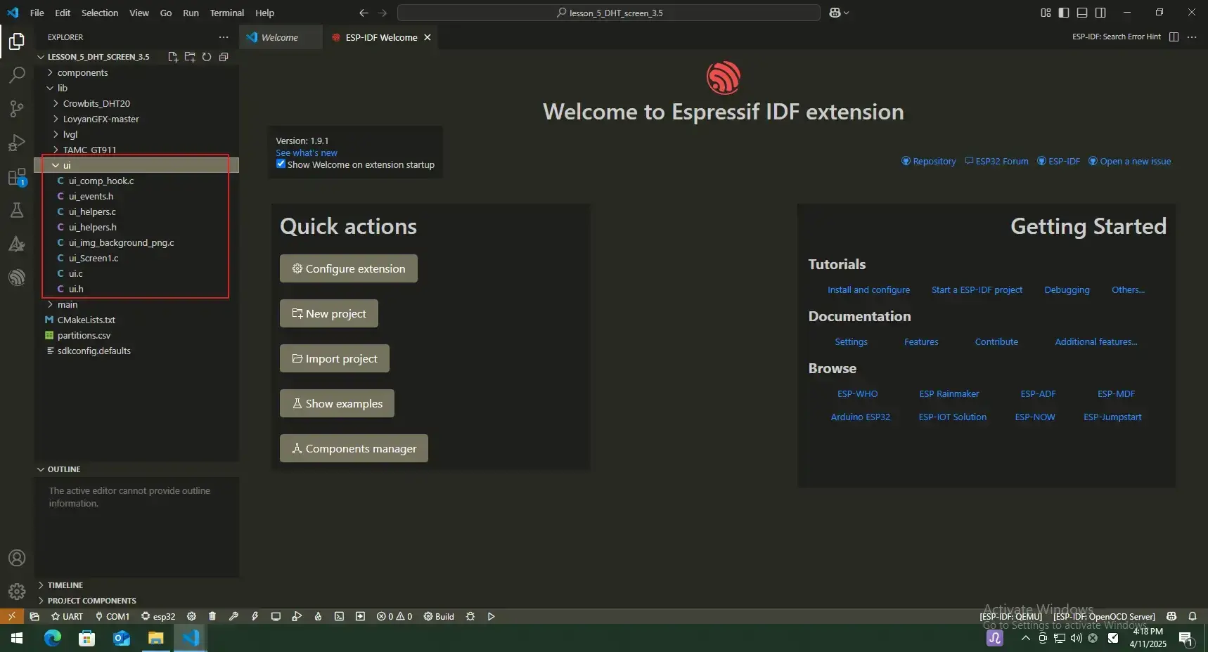

Then use VSCode to open the IDF project folder. Copy the generated .h and .c files into the corresponding folders of the project. (Here, I will use the code for the 3.5-inch version as an example, the download link is provided in Part 5.)

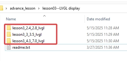

Step1:Download the files for lesson 3 from https://drive.google.com/drive/folders/1hEXyH14QeDgVdENxUfiYBQVCTbMbI6v9 and extract them, as shown below:
Click the link to access the lesson 3 folders in both big and small sizes, and select the code that matches your desired size.

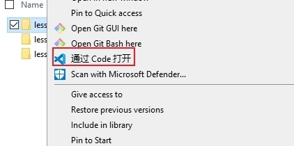

Select the code folder for this lesson, right-click on it, and then choose to open it with VS Code.

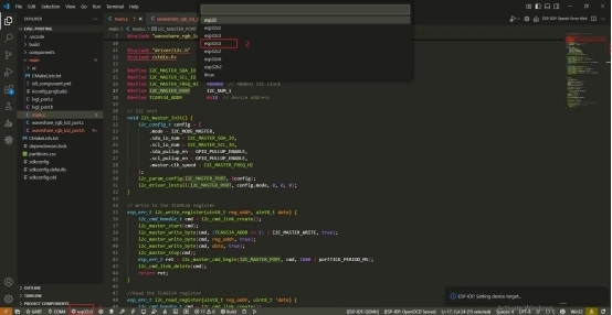

Step3: Select a serial port to connect to the development board.

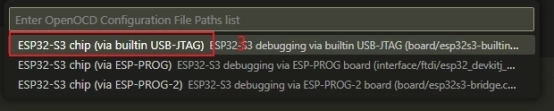

Step4: Select the chip model "esp32s3".
Note: Since there is an sdkconfig.defaults file in the project, IDF can automatically recognize the development board configuration from this file, eliminating the need for manual configuration of the development board.

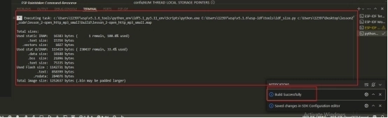

Step6:Click”build”.
Wait for the compilation to be completed.

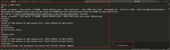

Step7: Click”Upload”.
Wait for the flashing to be completed.

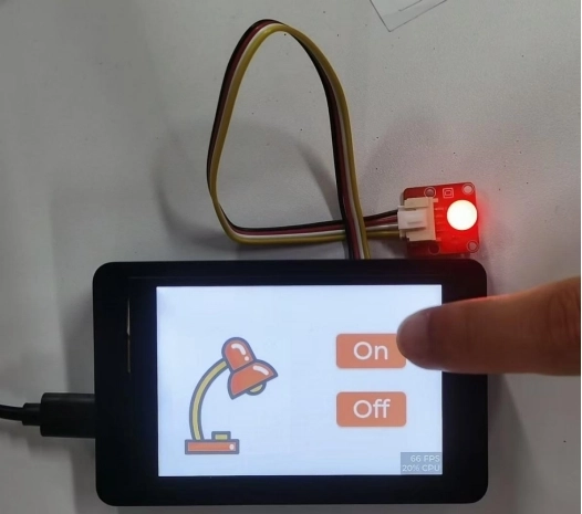

After flashing the program, tapping "ON" on the screen will turn the LED on, and tapping "OFF" will turn the LED off.
