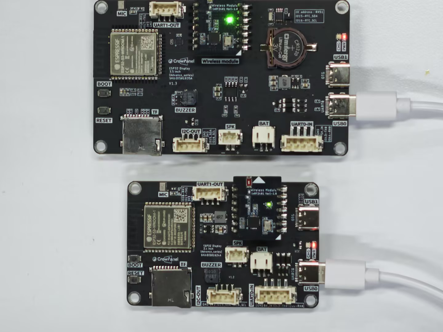

In this lesson, we will teach you how to use our nRF2401 wireless module.
To use our nRF2401 wireless module, you need to prepare two CrowPanel ESP32 Advance HMI Displays of any size.
1_2

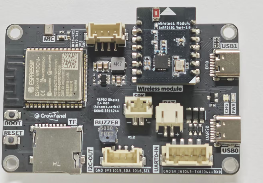

One of the nRF2401 wireless modules is inserted into the W-M wireless module slot to perform the sending task;
35_image_6_1
Another nRF2401 wireless module is inserted into the W-M wireless module slot to perform the receiving task.
1_3

Be careful:
① During the process of programming the product, please do not insert the nRF2401 wireless module into the W-M slot.
Because the BOOT pin of the CrowPanel ESP32 Advance HMI needs to be kept low, but after inserting the nRF2401 wireless module into the W-M slot, the IRQ pin of the nRF2401 wireless module will default to pulling up the BOOT pin, which can cause burning failure.
So it is necessary to upload the code to the CrowPanel ESP32 Advance HMI before inserting the nRF2401 wireless module into the W-M slot for use.

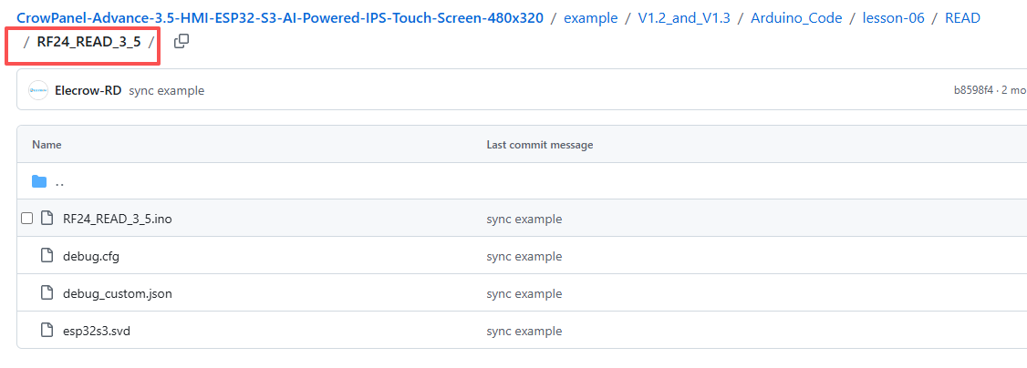

Open the READ folder.
Select the corresponding size code to open.
image-20260605152010781

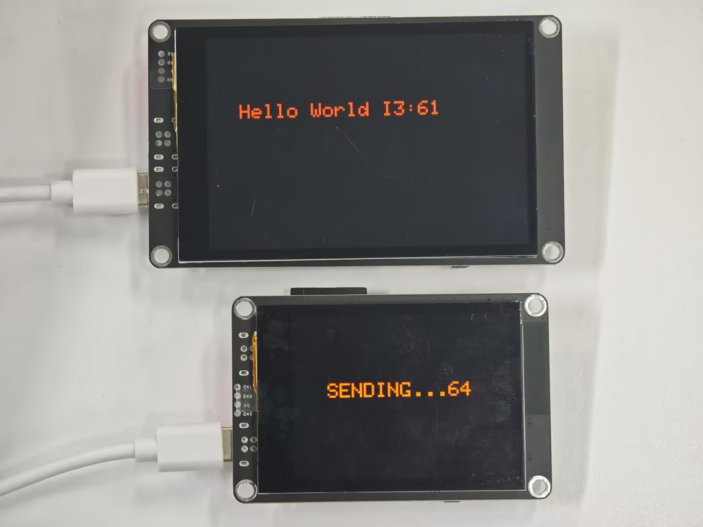

You can see that Hello World has received it.

The code upload is complete. Next, let's see the actual effect.
After waiting for the code upload to complete, insert the nRF2401 wireless module into the W-M slot.
35_image_6_3
Send messages using the 2.4-inch device and receive messages using the 3.5-inch device.
35_image_6_4
