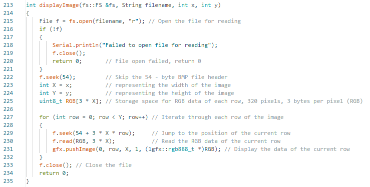

The function displayImage() reads BMP format images from the SD card and displays the image content on the LCD screen. The function first opens the specified BMP file, then skips the fixed 54-byte file header of the BMP file and directly locates to the pixel data area. Since BMP images are stored in the RGB888 format, each pixel occupies 3 bytes, so the program creates a buffer that can store the pixel data of a whole row.
Then, through a loop, it reads the image content row by row, reads one row of RGB data from the SD card each time, and calls LovyanGFX's gfx.pushImage() to draw this row of pixels at the corresponding position on the screen. This process is repeated continuously until all rows are displayed, ultimately forming a complete image.
This function adopts the "read row by row, display row by row" approach instead of loading the entire image into memory at once. Therefore, it can display high-resolution BMP images with a resolution higher than that of the ESP32's limited RAM. It is a typical streaming image display scheme.
