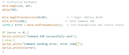

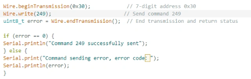

You can also control the following functions by sending other instructions to the microcontroller:
- It means sending the 248 command to the microcontroller (0x30) to instruct the speaker to turn on.
- It means sending the 249 command to the microcontroller (0x30) to instruct the speaker to turn off.

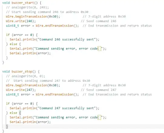

- You can also send command 246 to control the buzzer to turn on, and send command 247 to control the buzzer to turn off.
