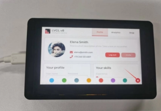

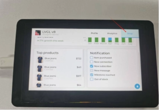

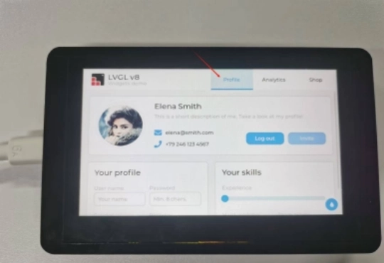

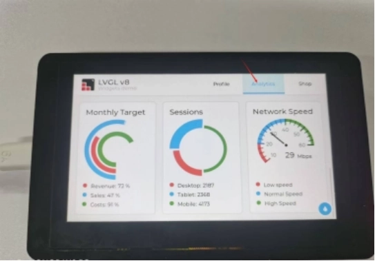

When you power on the product, you will see the following interface.
(The interface has not yet developed any functions and can only be viewed by sliding the interface.)
However, you can choose the theme color you want to use.

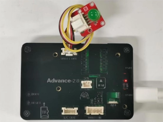

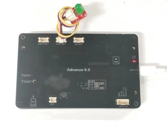

Connect the development board to the computer with a Type-C cable.

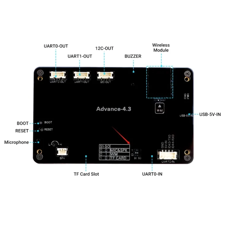

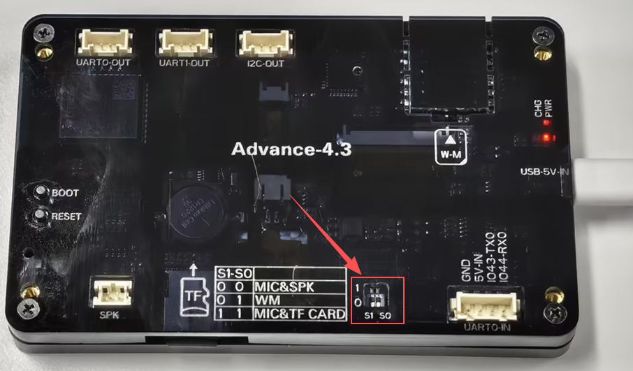

Note: For the development boards with sizes of 2.4 inches, 2.8 inches, and 3.5 inches, the default interface for flashing is USB0. For the development boards with sizes of 4.3 inches, 5.0 inches, and 7.0 inches, insert the small light bulb into the UART1-OUT port, and for development boards of other sizes, insert it into the UART-OUT port.
For the development versions with screen sizes of 4.3 inches, 5.0 inches, and 7.0 inches, the function select keys should be set to 01.

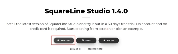

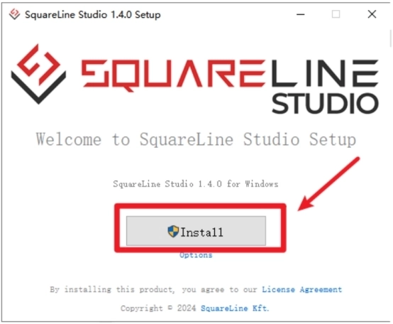

Download the version 1.4.0
Click install.

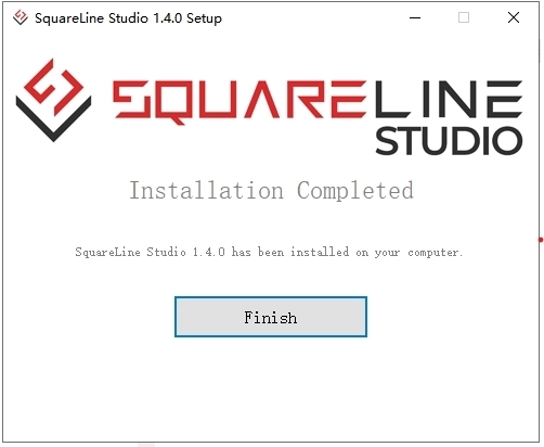

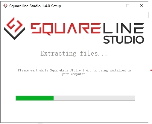

Wait for installation.
Installation finish.

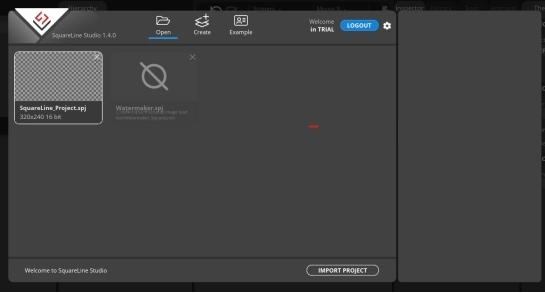

3.2 Software Function Introduction¶
Open the software

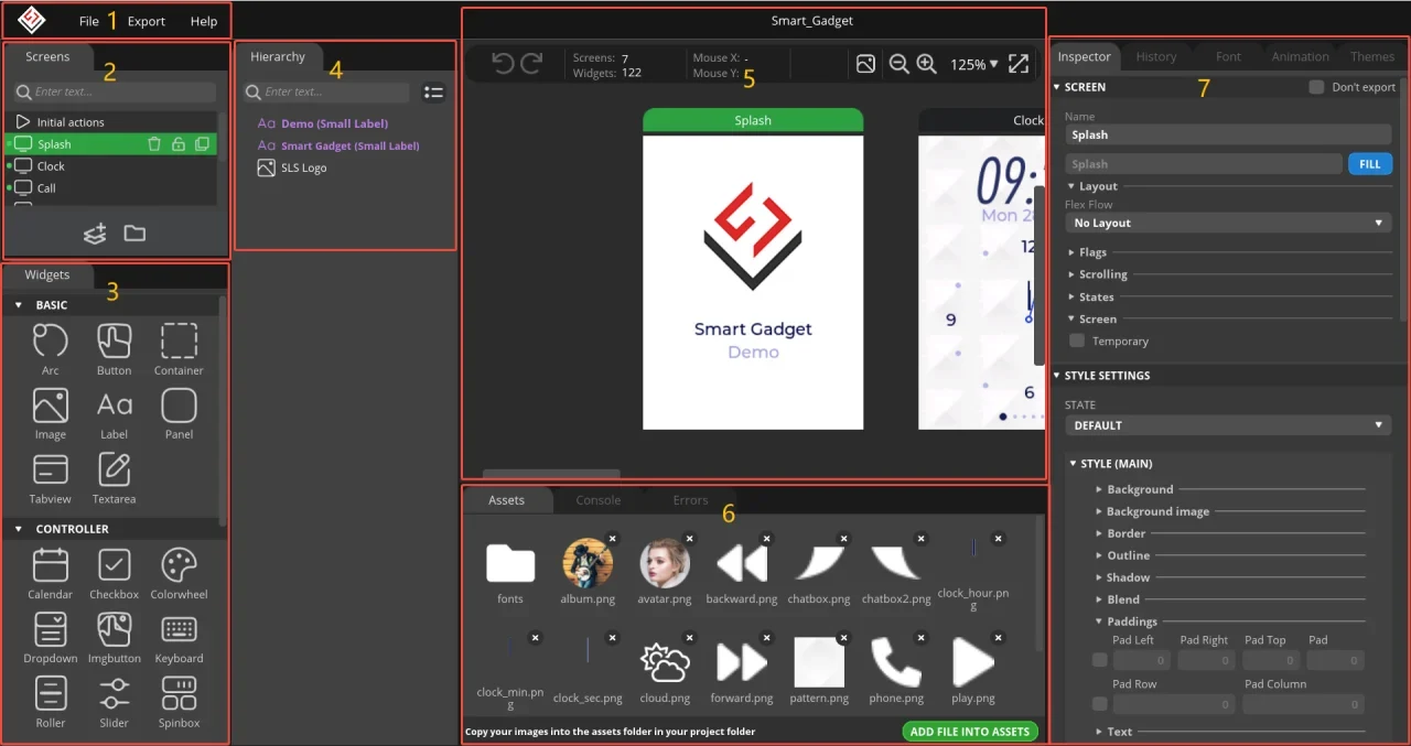

Note:Please select the corresponding resolution and color depth according to the screen specifications.
①Toolbar, including File, Export, and Help. Basic file operation bar, create or open files, export UI files and other operations. Click help and there are related introductory documents.
②Screen bar, the project screen will be listed here.

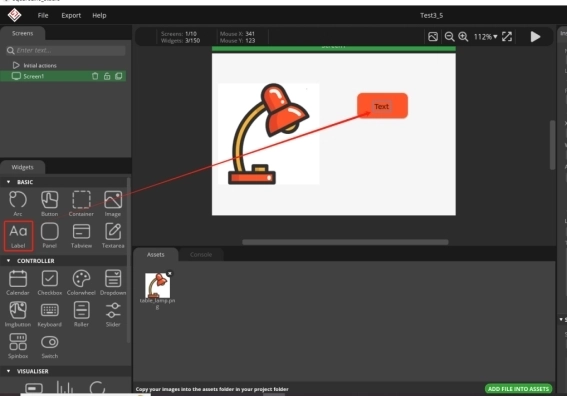

③Widget area, all widgets are here and can be selected and used according to project needs.
④Hierarchy area, it will show every widget used in each screen.
⑤This area shows the actual display effect, you can adjust the widgets or screen here.
⑥Material column, the added materials are displayed here.
⑦Setting bar, where you can make basic settings for each part, including the basic attributes and trigger operations of the part.

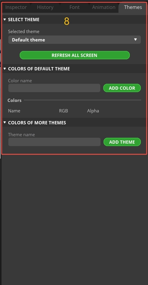

⑧Theme bar, different themes can be set.

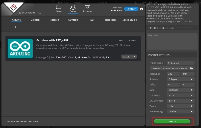

4.1 Create a new SquareLine Studio project.¶
Here, I take a 2.8-inch screen as an example. After determining the resolution, I fill it in

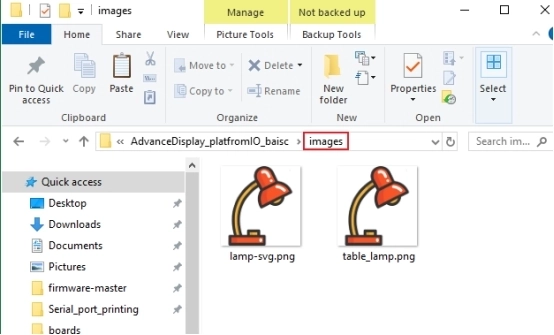

The images can be found at the following location:
https://github.com/Elecrow-RD/CrowPanel-Advance-4.3-HMI-ESP32-S3-AI-Powered-IPS-Touch-Screen-800x480/tree/master/Squareline_studio%20Instructions%20for%20use/code
Table_1amp image sizes are available for 3.5-inch, 4.3-inch, 5.0-inch, and 7-inch screens.

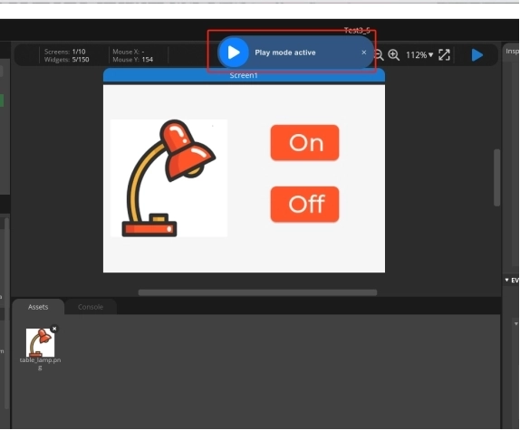

Select 'event' to add in the right sidebar.
After selecting, click ADD.
After adding, run

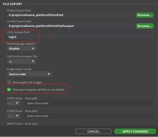

Click on Project Setting
Set export path.
Complete the setup and export file.

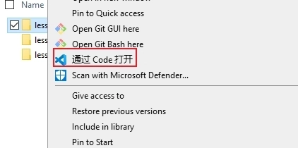

Select the code folder for this lesson, right-click on it, and then choose to open it with VS Code.

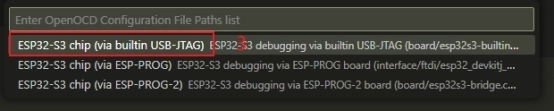

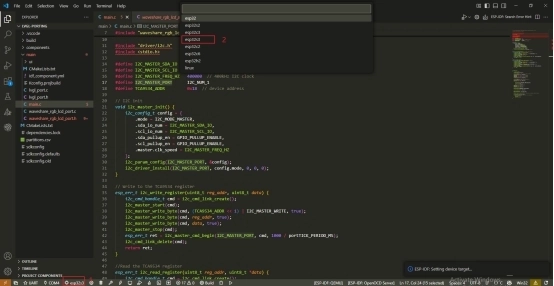

Step3: Select a serial port to connect to the development board.
Step4: Select the chip model "esp32s3".
Note: Since there is an sdkconfig.defaults file in the project, IDF can automatically recognize the development board configuration from this file, eliminating the need for manual configuration of the development board.

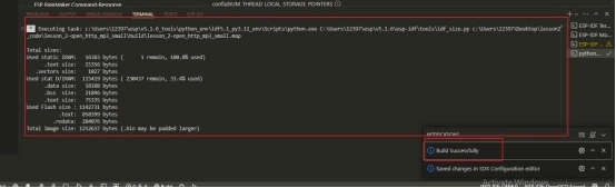

Step6:Click”build”.
Wait for the compilation to be completed.

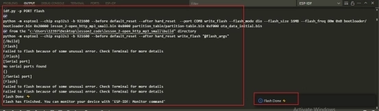

Step7: Click”Upload”.
Wait for the flashing to be completed.

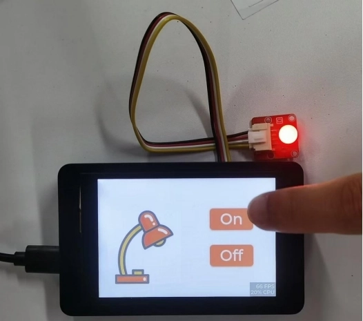

After flashing the program, tapping "ON" on the screen will turn the LED on, and tapping "OFF" will turn the LED off.

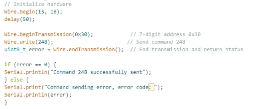

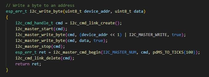

In terms of hardware, we use a microcontroller (STC8H1K28) to control the screen backlight, speaker on/off, and buzzer.
(However, there are other function interfaces that need to be written in the specific code, and you can refer to the complete code provided later.)
Explanation:

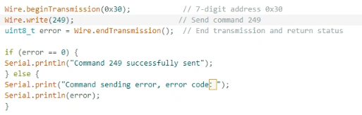

- 0x30 is the I2C address of the microcontroller (STC8H1K28).
- 0x5D is the I2C address of the touch IC (GT911).
- sendI2CCommand(0) means sending command 0 to the microcontroller (address 0x30) to instruct it to set the screen brightness to maximum.

You can also control the following functions by sending other instructions to the microcontroller:
- It means sending the 248 command to the microcontroller (0x30) to instruct the speaker to turn on.
- It means sending the 249 command to the microcontroller (0x30) to instruct the speaker to turn off.
- You can also send command 246 to control the buzzer to turn on, and send command 247 to control the buzzer to turn off.
