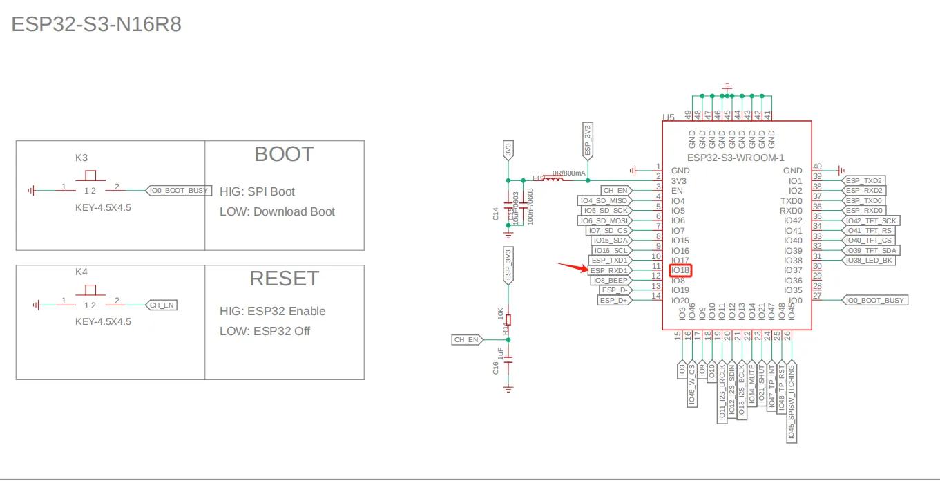

Connect the light bulb at the UART1 interface
Observing the schematic diagram of this size, it is known that the pin for UART1 to control the light bulb to turn on and off is 18
So in the code, set pin 18 as the output mode.
A large-sized screen requires setting 19 pins as the output mode.
