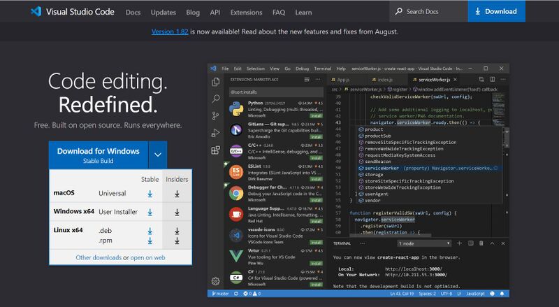

First download Visual Studio Code on https://code.visualstudio.com/. Choose the version that is compatible with your computer system and download it Vscode-download.jpg

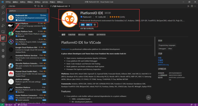

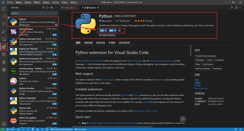

Open VSCode and click on Extension, search for Python and install. Platformio-terminal-python.png

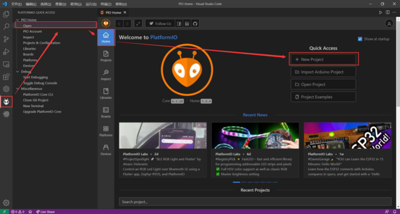

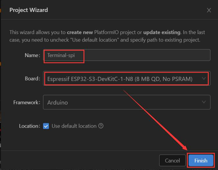

Click on the PlatformIO icon, click the quik access "Open", then click "+New Project" Platformio-terminal-new-project.png
Add the project name. The board select "ESP32-S3-DevKitC-1-N8(8 MB QD, No PSRAM)", framework select Arduino Platformio-terminal-project-wizard.png

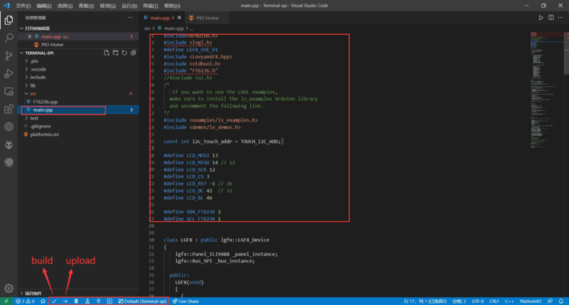

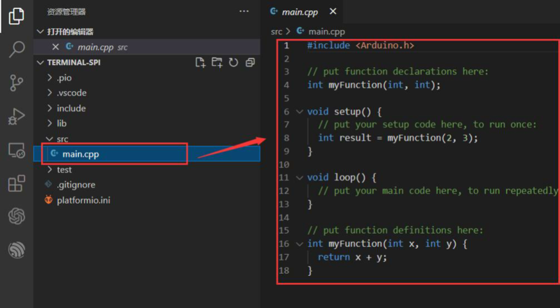

The main part of the program will be written in main.cpp Platformio-terminal-main.png

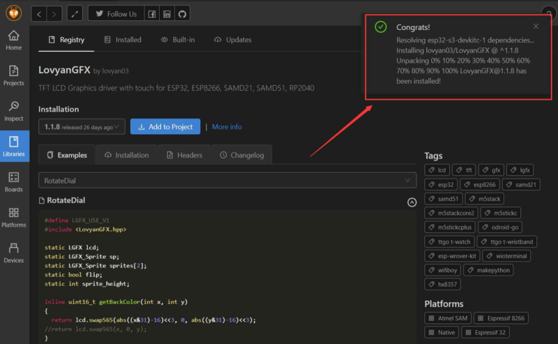

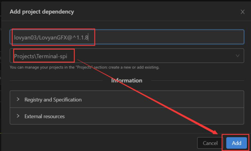

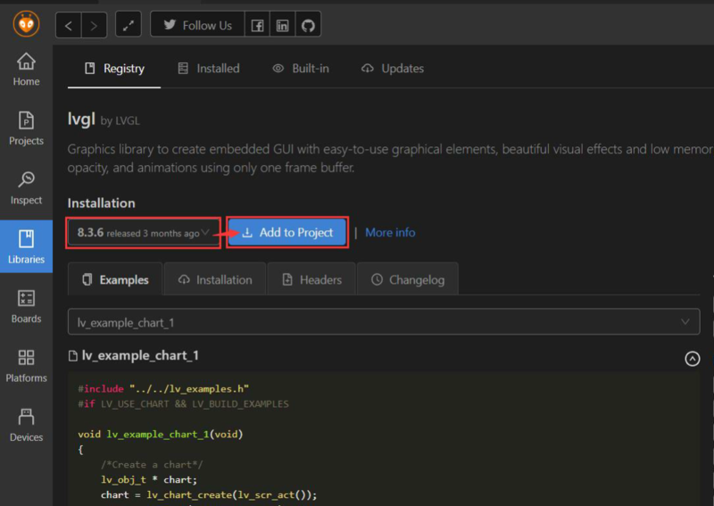

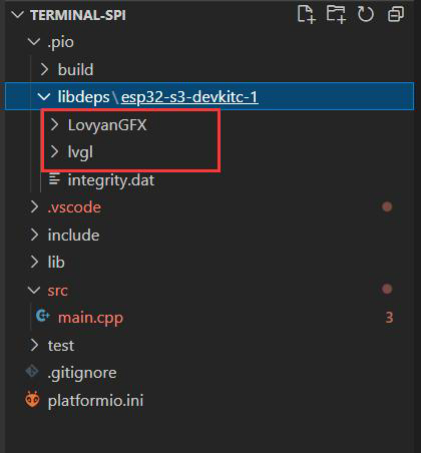

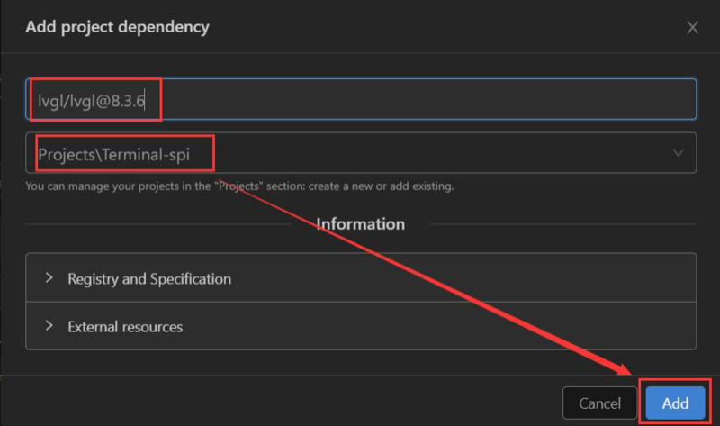

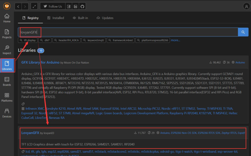

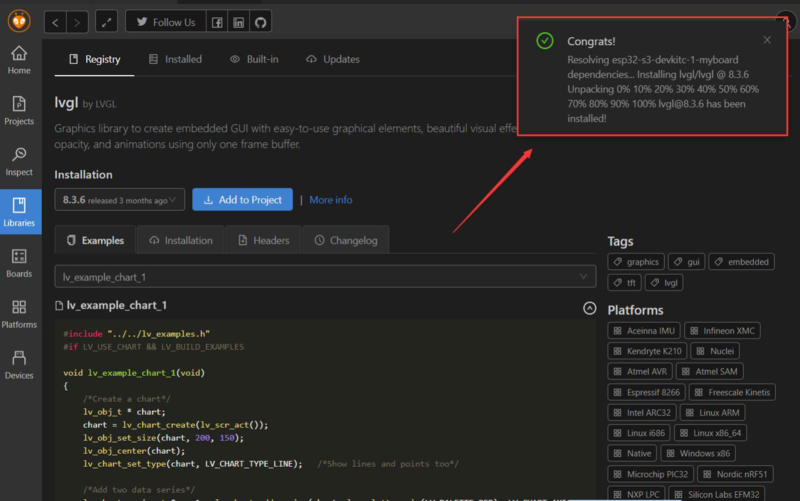

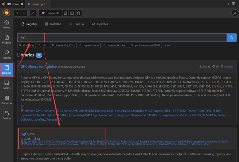

We can see that the library has been added successfully! Platformio-terminal-library-added.png

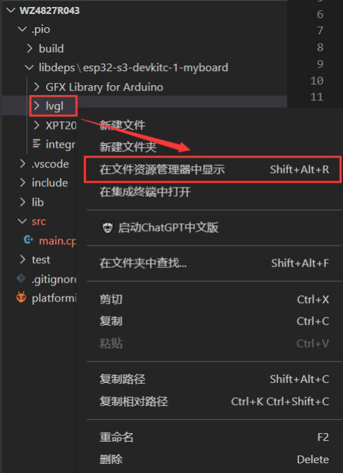

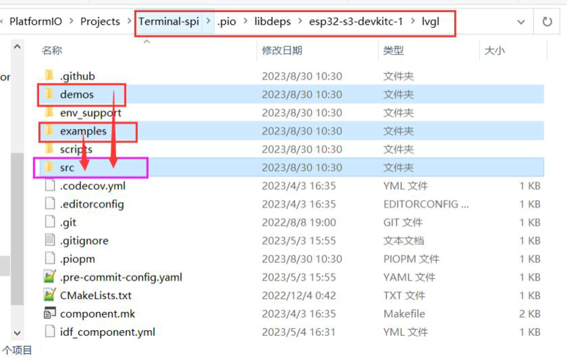

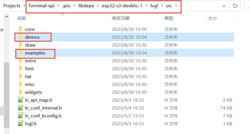

Right-click the lvgl and open in files explorer Platformio-terminal-open-lvgl.png

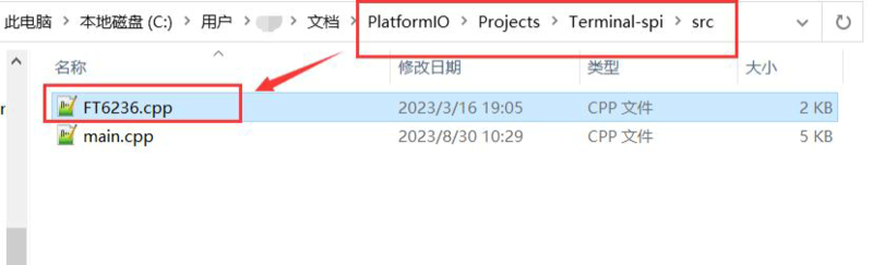

Move the demos and examples folder to src folder Platformio-terminal-copy.png

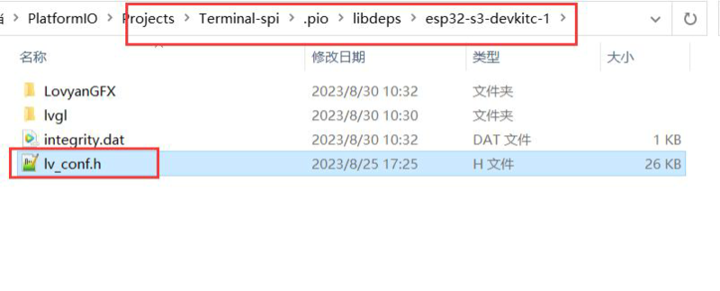

Place the lv_conf.h file under the esp32-s3-devkit-1 directory Platformio-terminal-lv conf.png
Put the FT6236.cpp file into the /src folder Platformio-terminal-FT-CPP.png

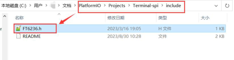

Put the FT6236.h file in the /include folder Platformio-terminal-FT-H.png

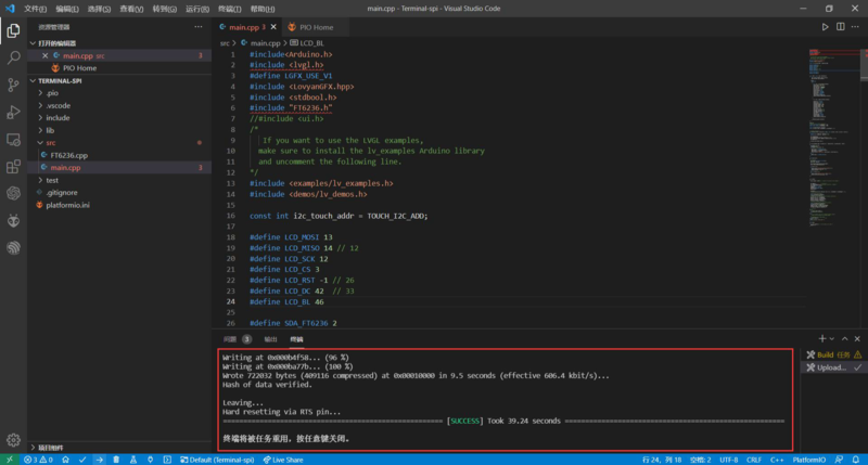

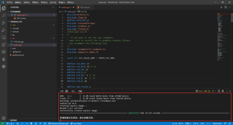

After the configuration is complete, write the code in main.cpp. Platformio-terminal-write-code.png
