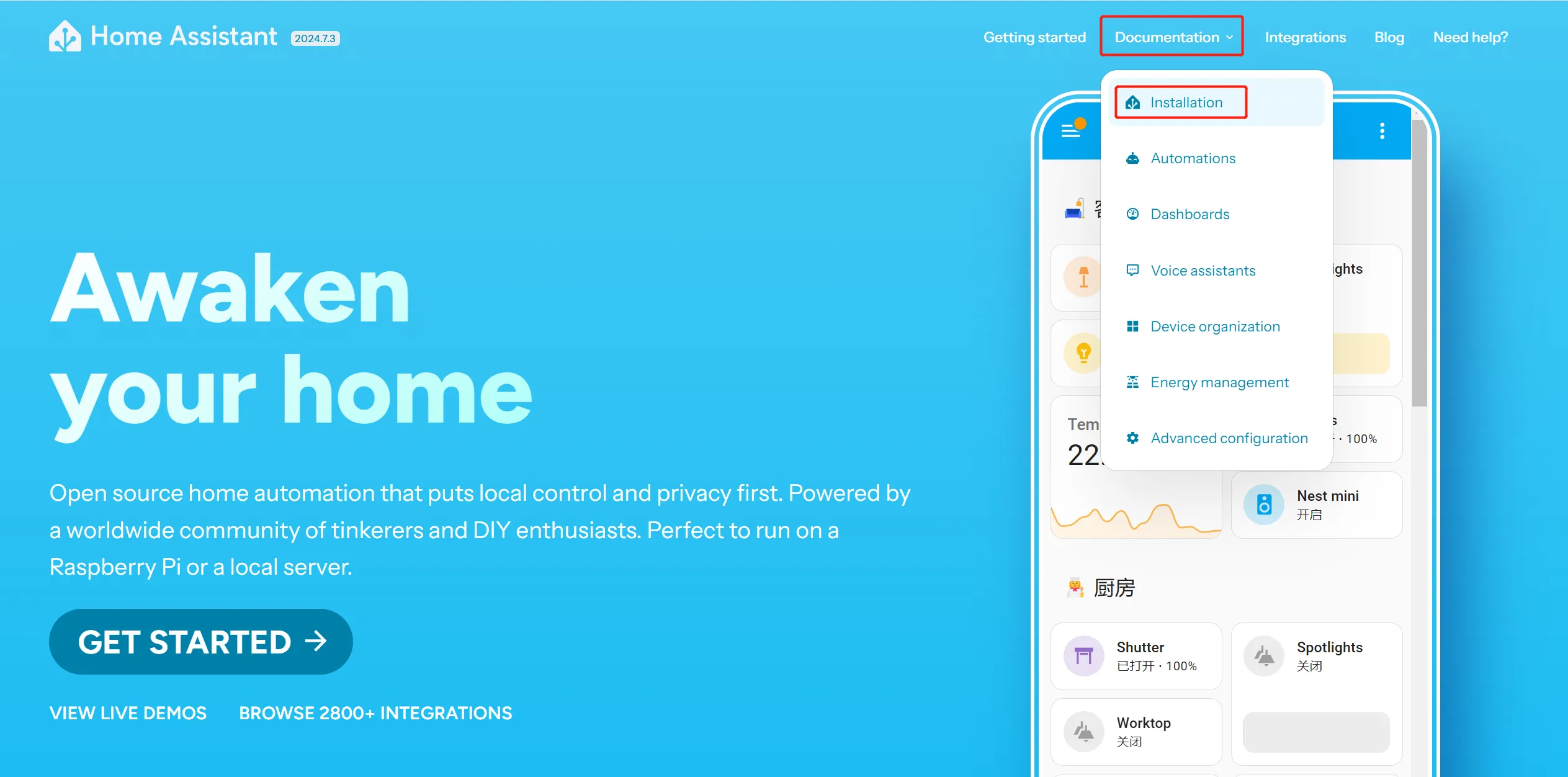

  1. Go to https://www.home-assistant.io/, and click the "Installation" under "Documentation" on the homepage.
    HA-1

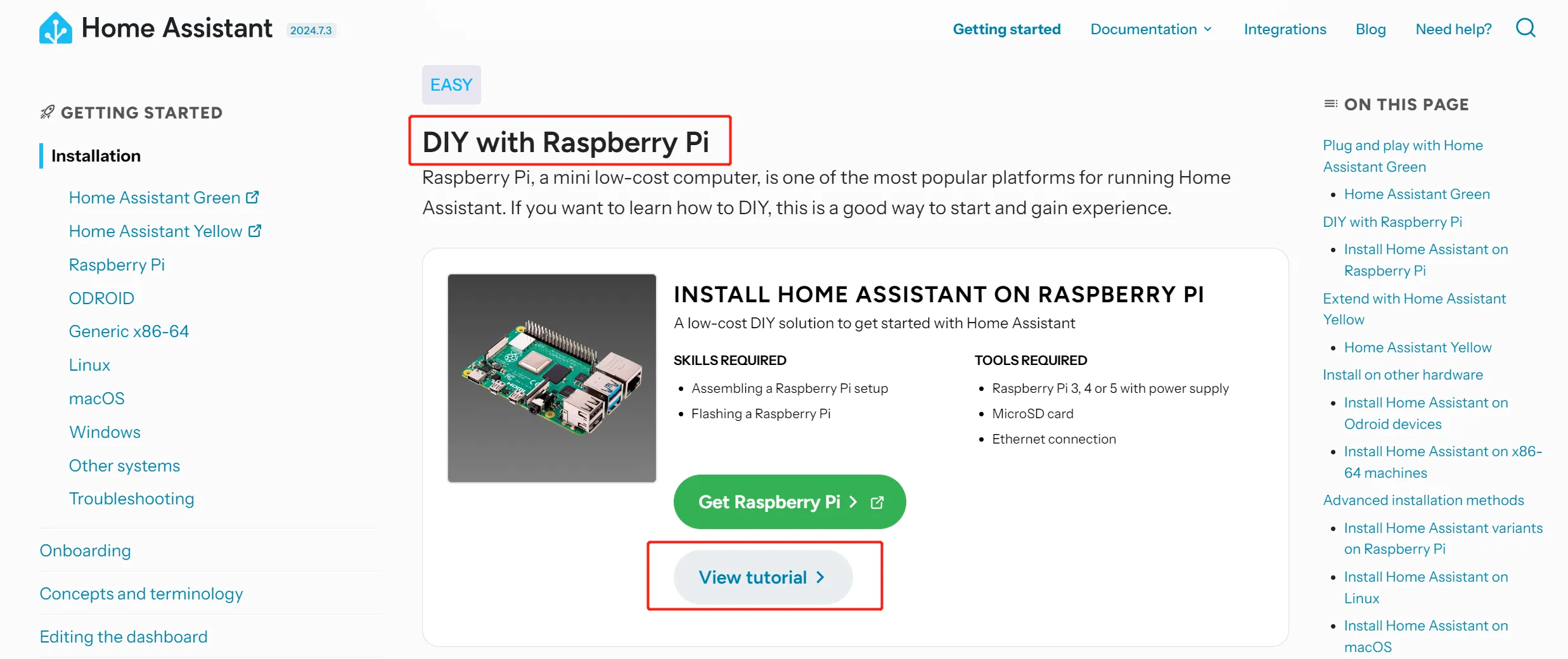

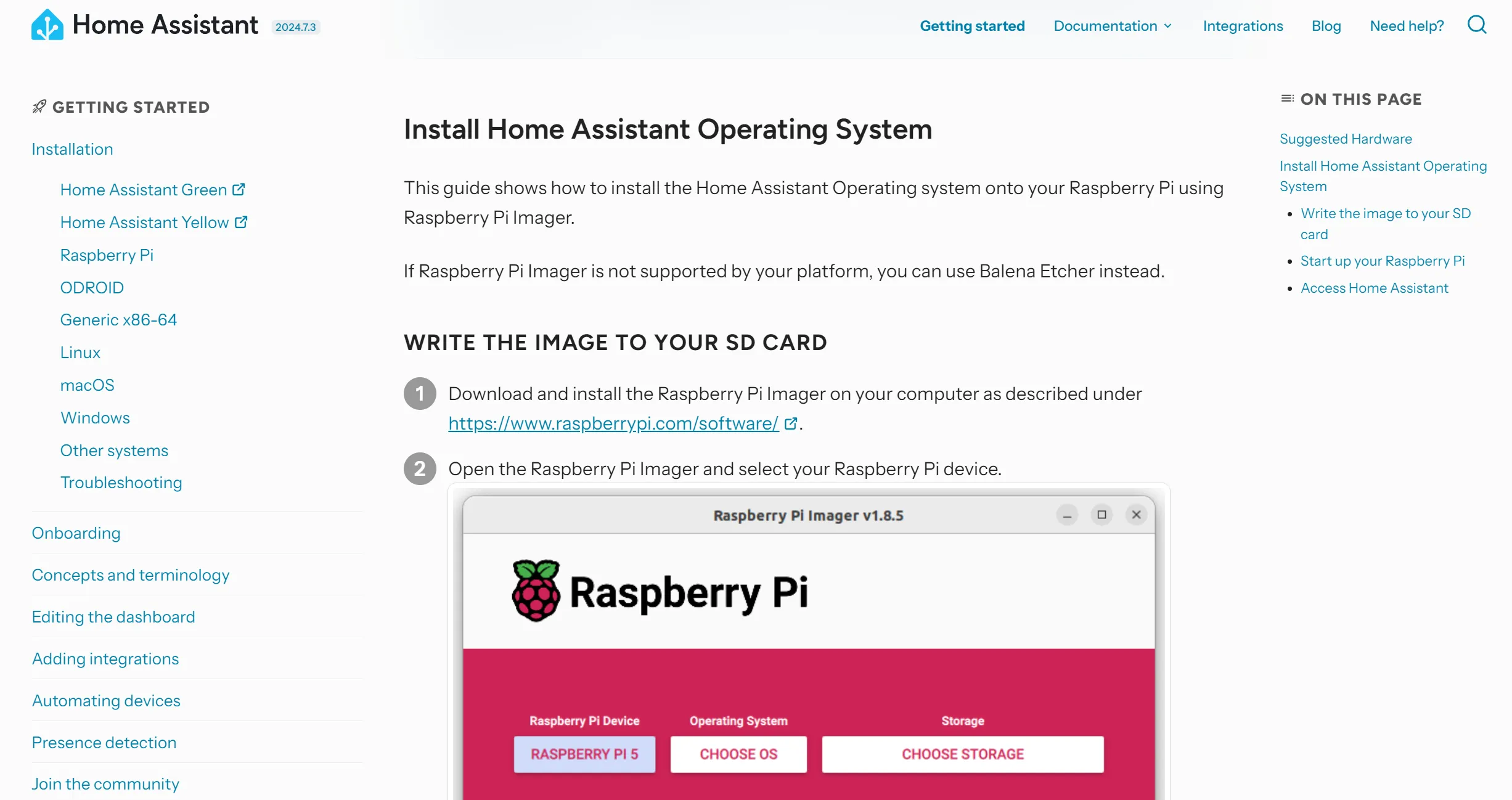

  2. Scroll down to the "DIY with Raspberry Pi" section, and click "View tutorial".
    HA-2
  3. Follow the Home Assistant tutorial to install Operating System.

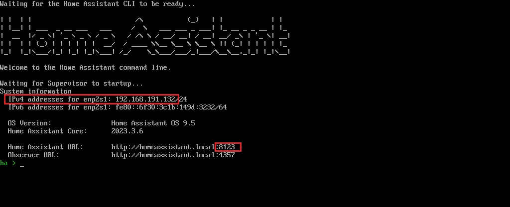

Within a few minutes after connecting the Raspberry Pi, you will be able to reach your new Home Assistant.
HA-4

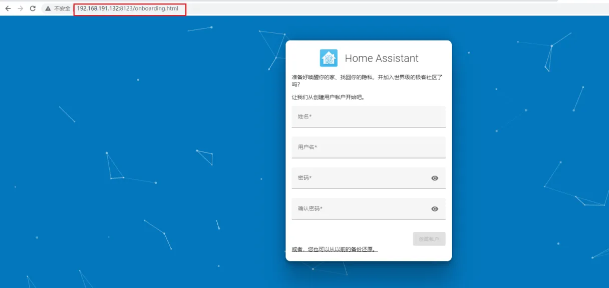

  1. In the browser of your desktop system, enter homeassistant.local:8123.

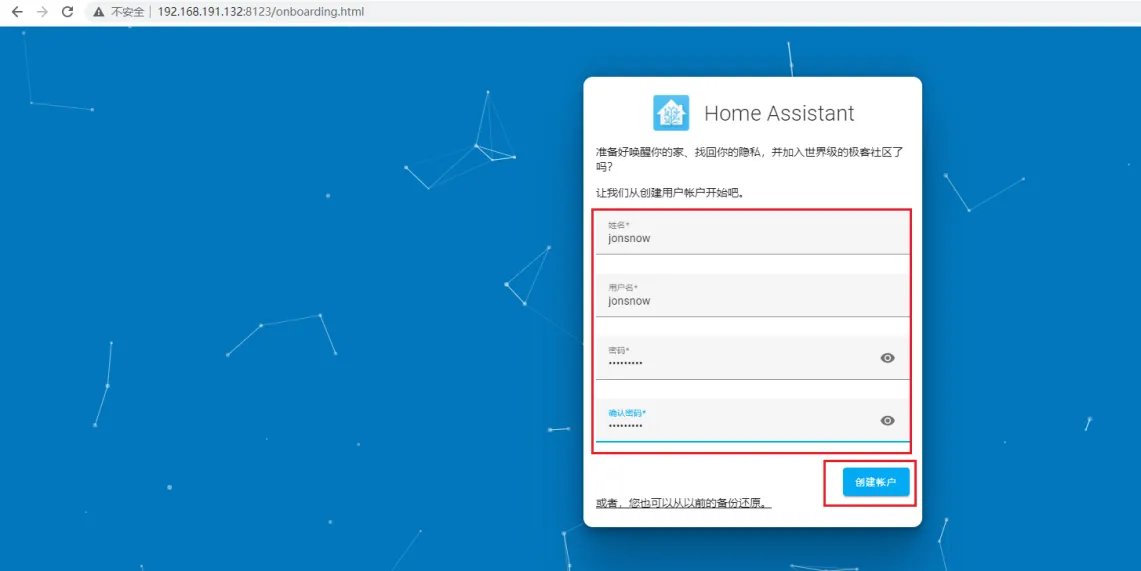

  2. For the first visit, you need to create an account. Fill in the username and password, and create an account.
    HA-6

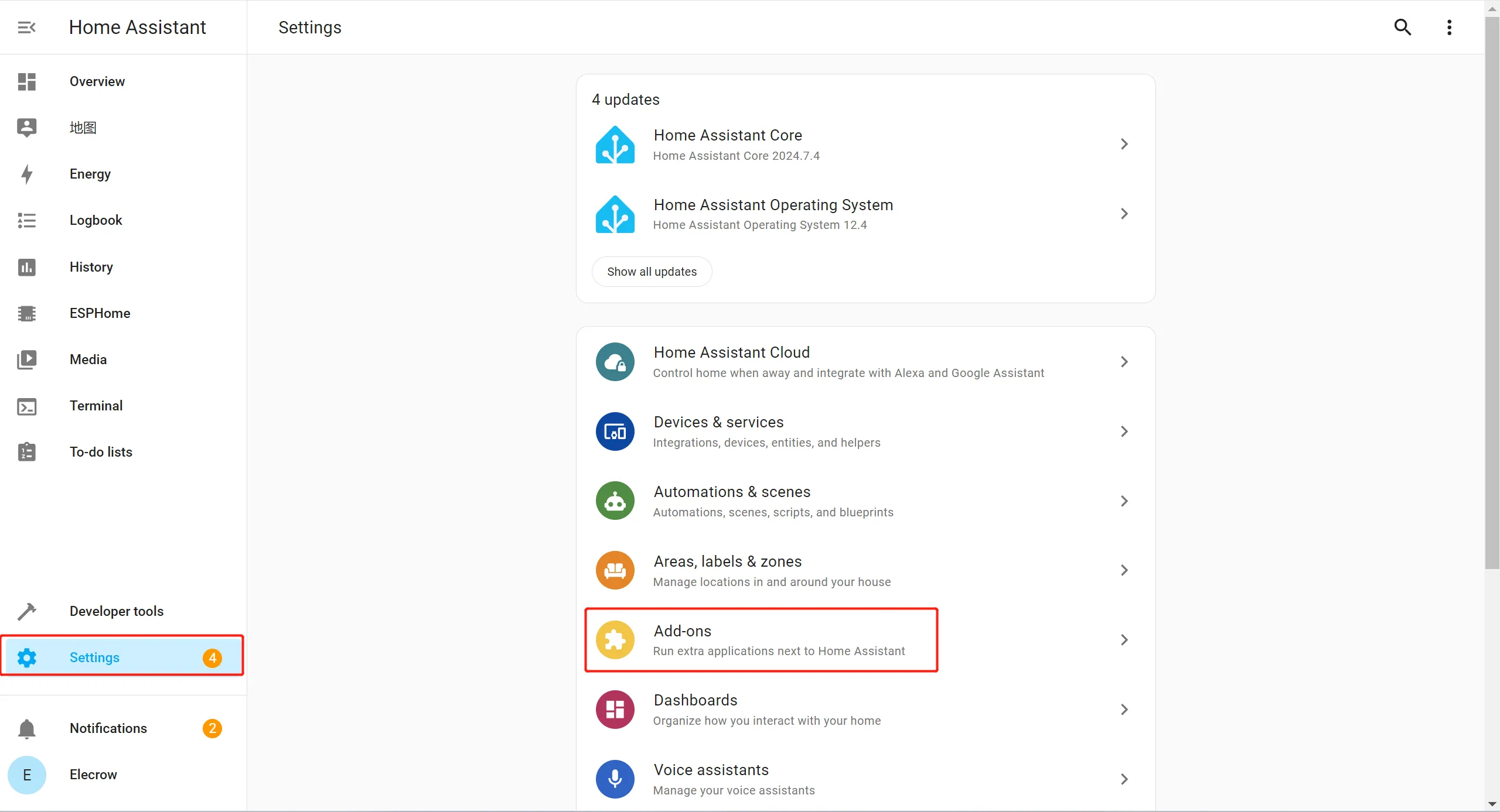

  2. Click "Setting" -> "Add on"
    HA-8

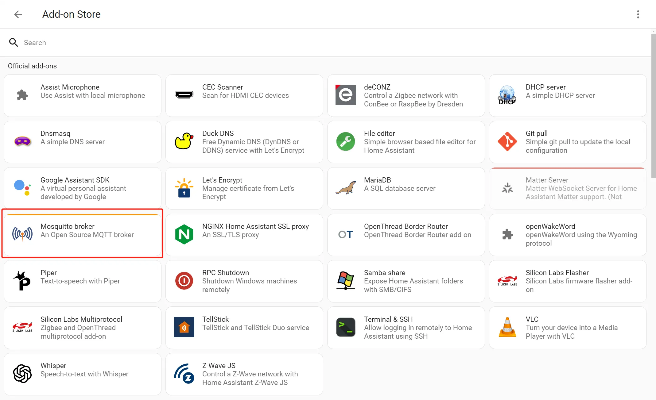

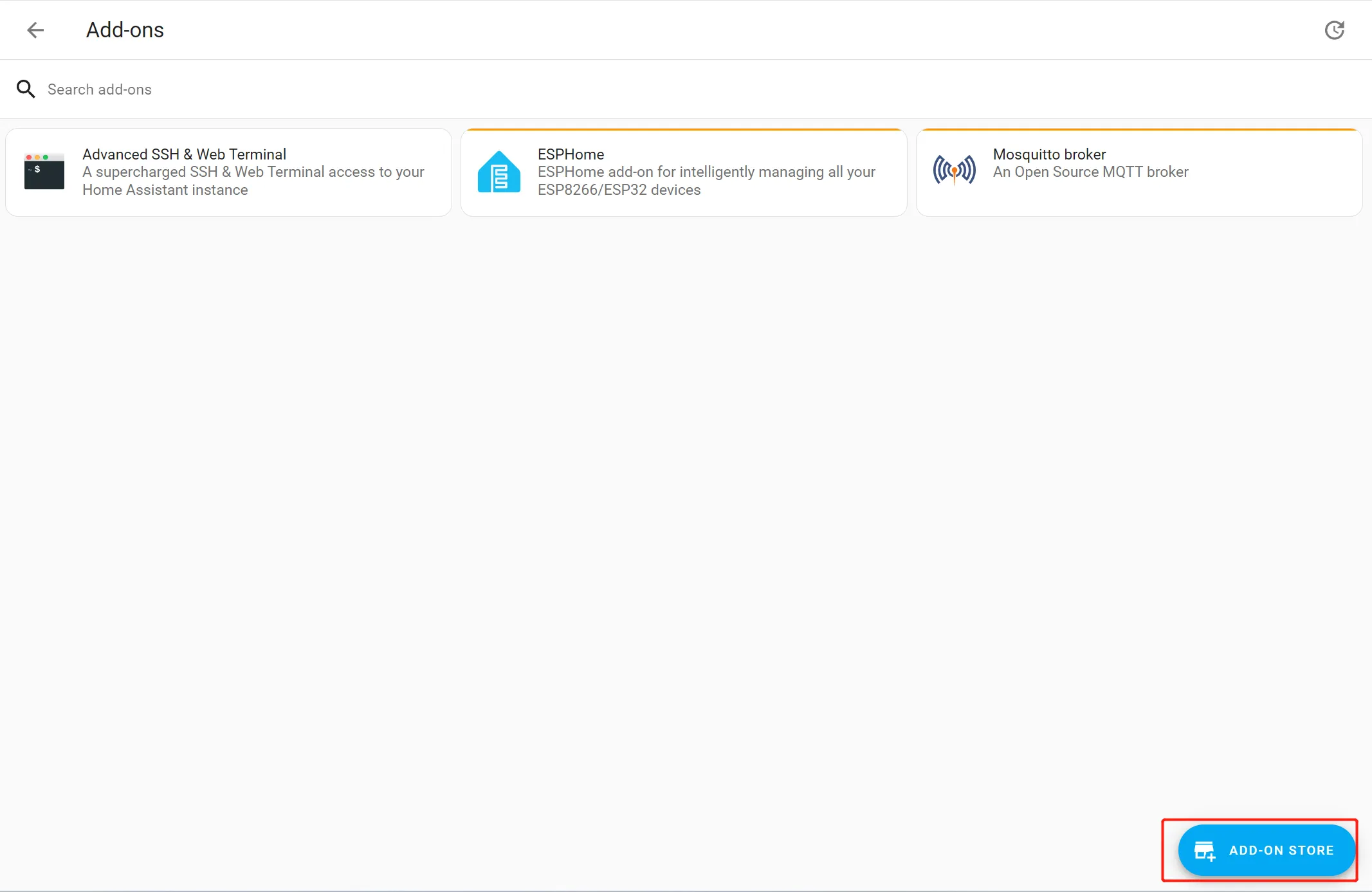

  3. Click ADD-ON STORE
    HA-9

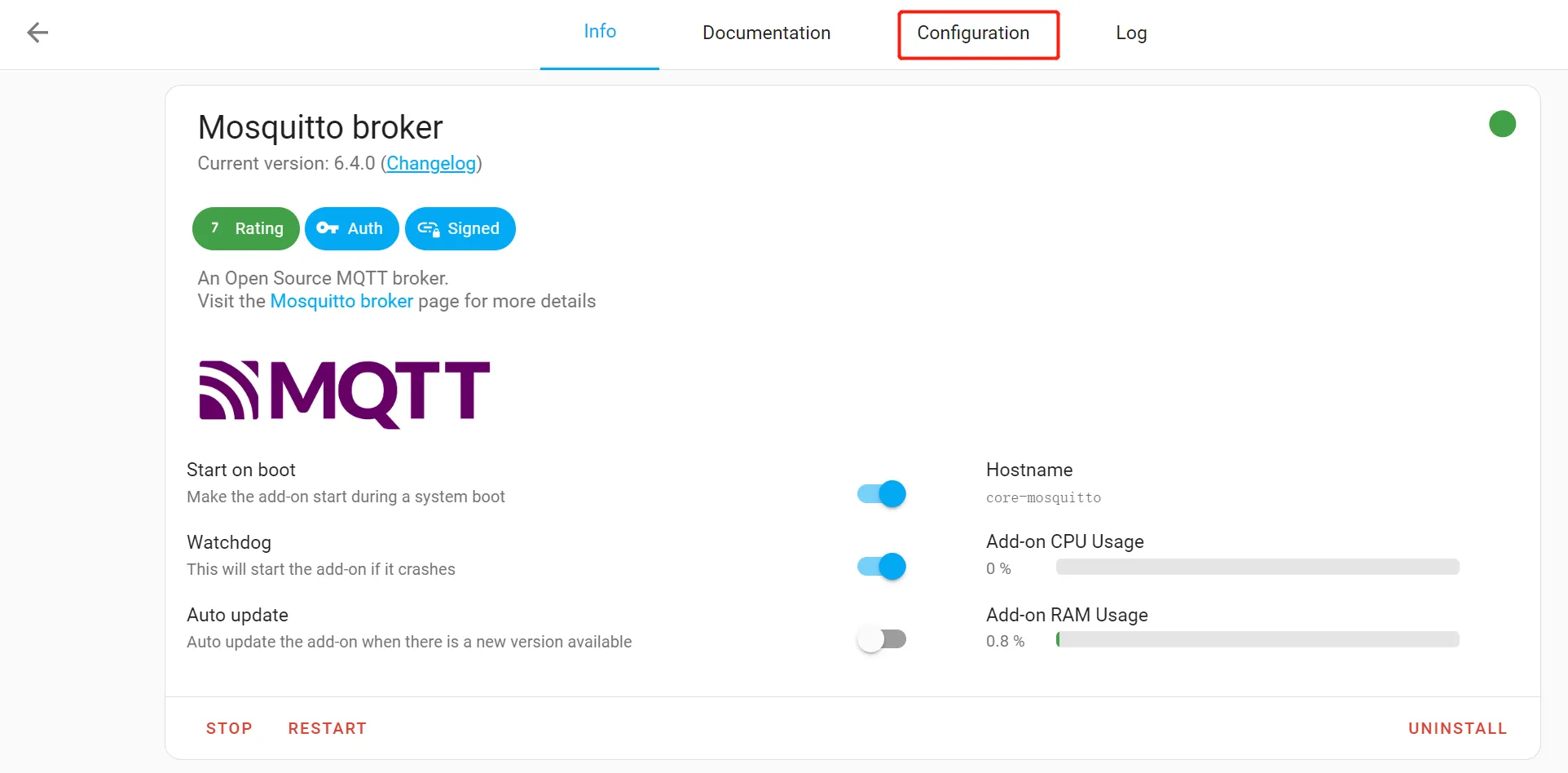

  4. Select "Mosquitto broker" and install
    HA-10

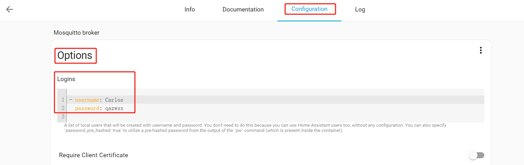

  5. Enable Mosquitto broker

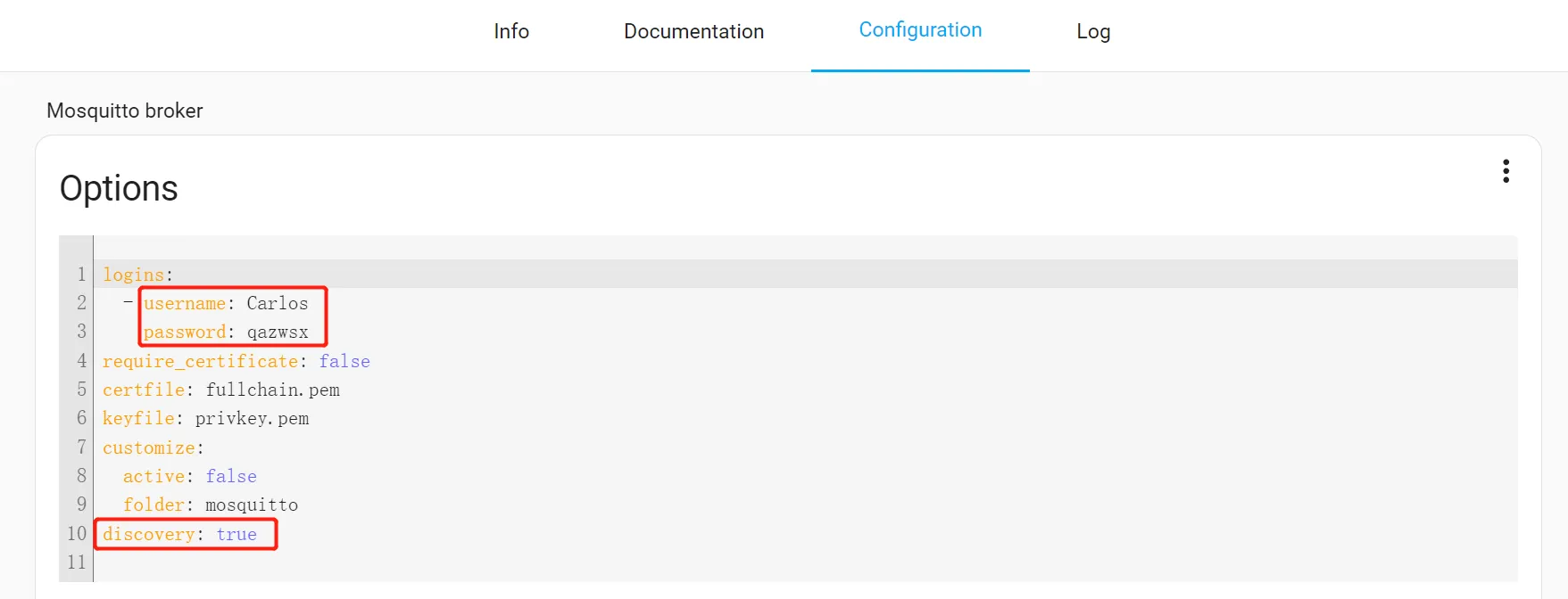

  6. Then click "Configuration" -> "Options" -> "Logins", and set the username and password.
    HA-11
    HA-12

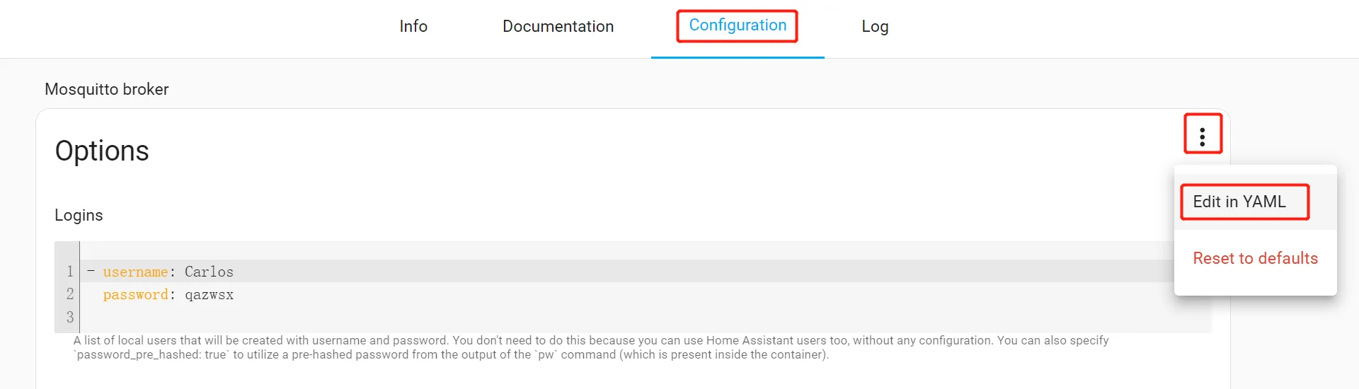

    Click the three-dot icon, then click "Edit in YAML"
    HA-12-1
    Modify the username and password, and set the discovery to "true".
    HA-12-2

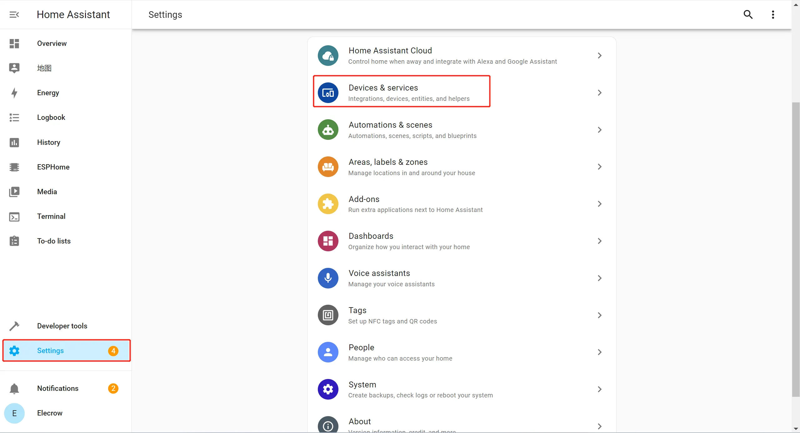

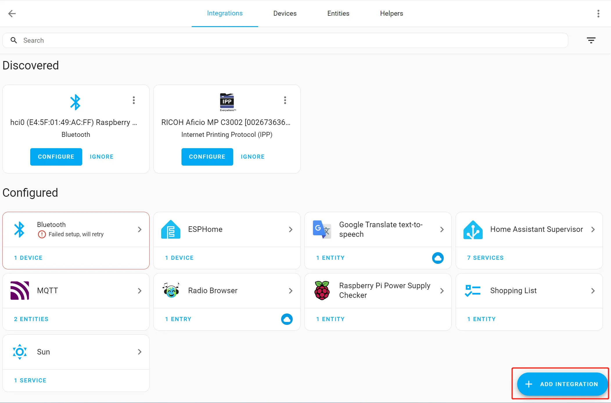

  7. Click "Setting"-> "Devices&Service"
    HA-13

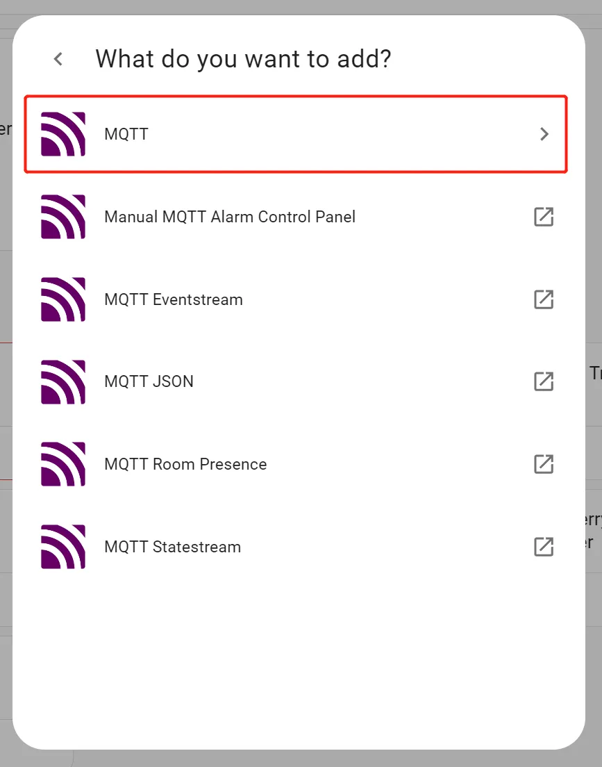

  8. Click "ADD INTEGRATION"
    HA-14

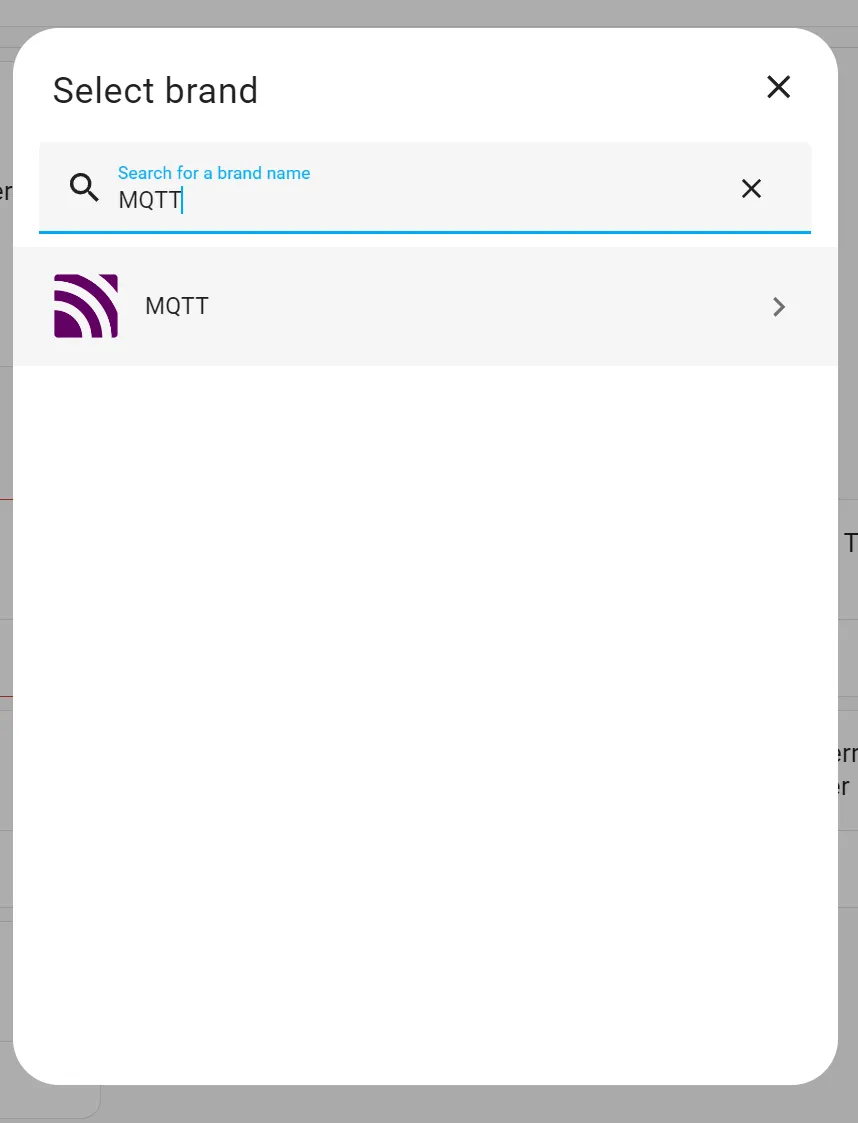

  9. Search for "MQTT"
    HA-14
    HA-16

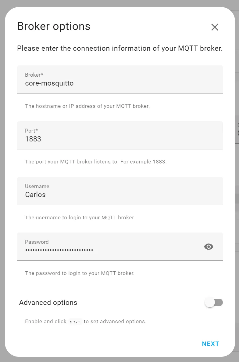

  10. Configure the MQTT server information (the server address is the address and port number of the Raspberry Pi server, and the username and password are the username and password configured in step 6)
    HA-17

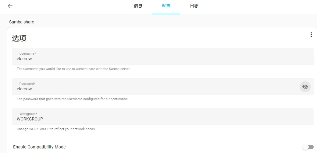

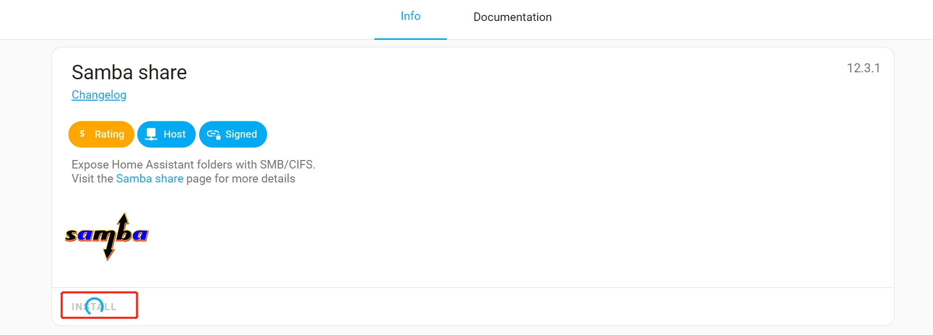

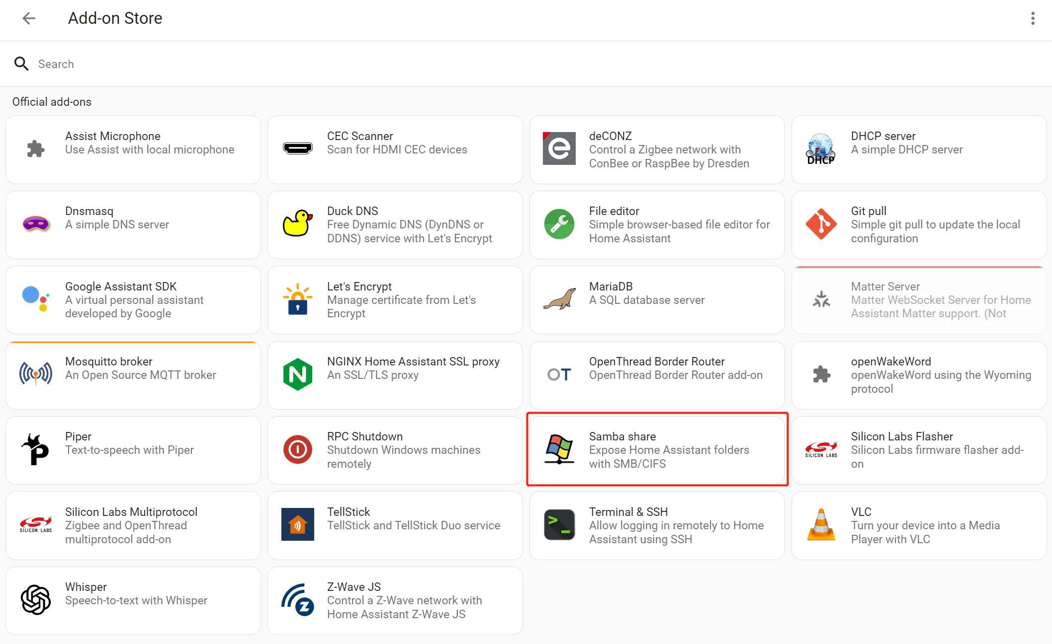

  11. Click "Setting" -> "Add on" -> "ADD-ON STORE", and install Samba share
    HA-18
    HA-19
  12. Enter the Samba share Configuration and enter the Username and Password
    HA-20

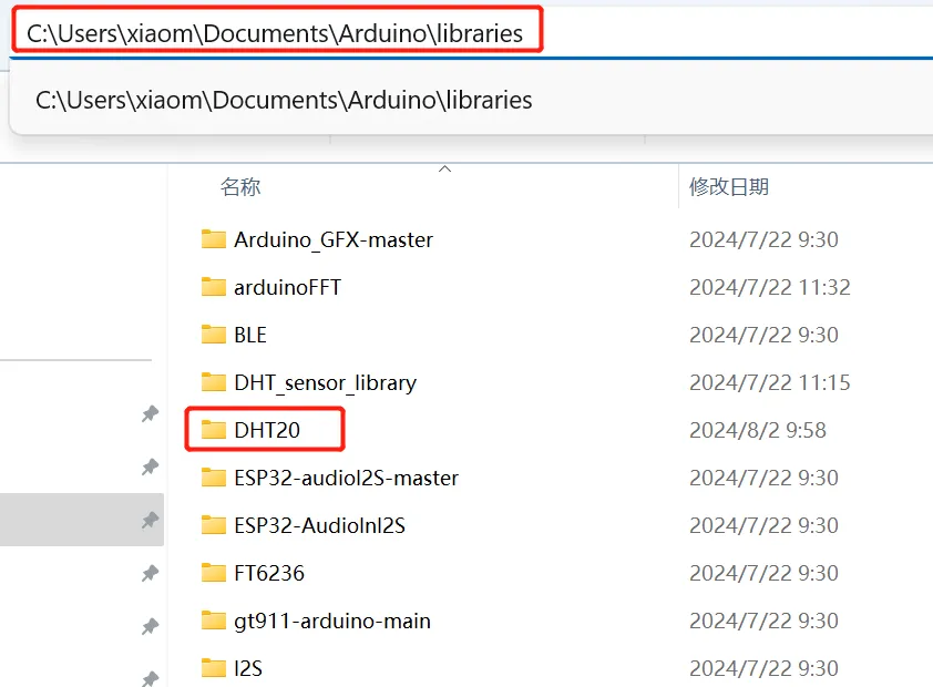

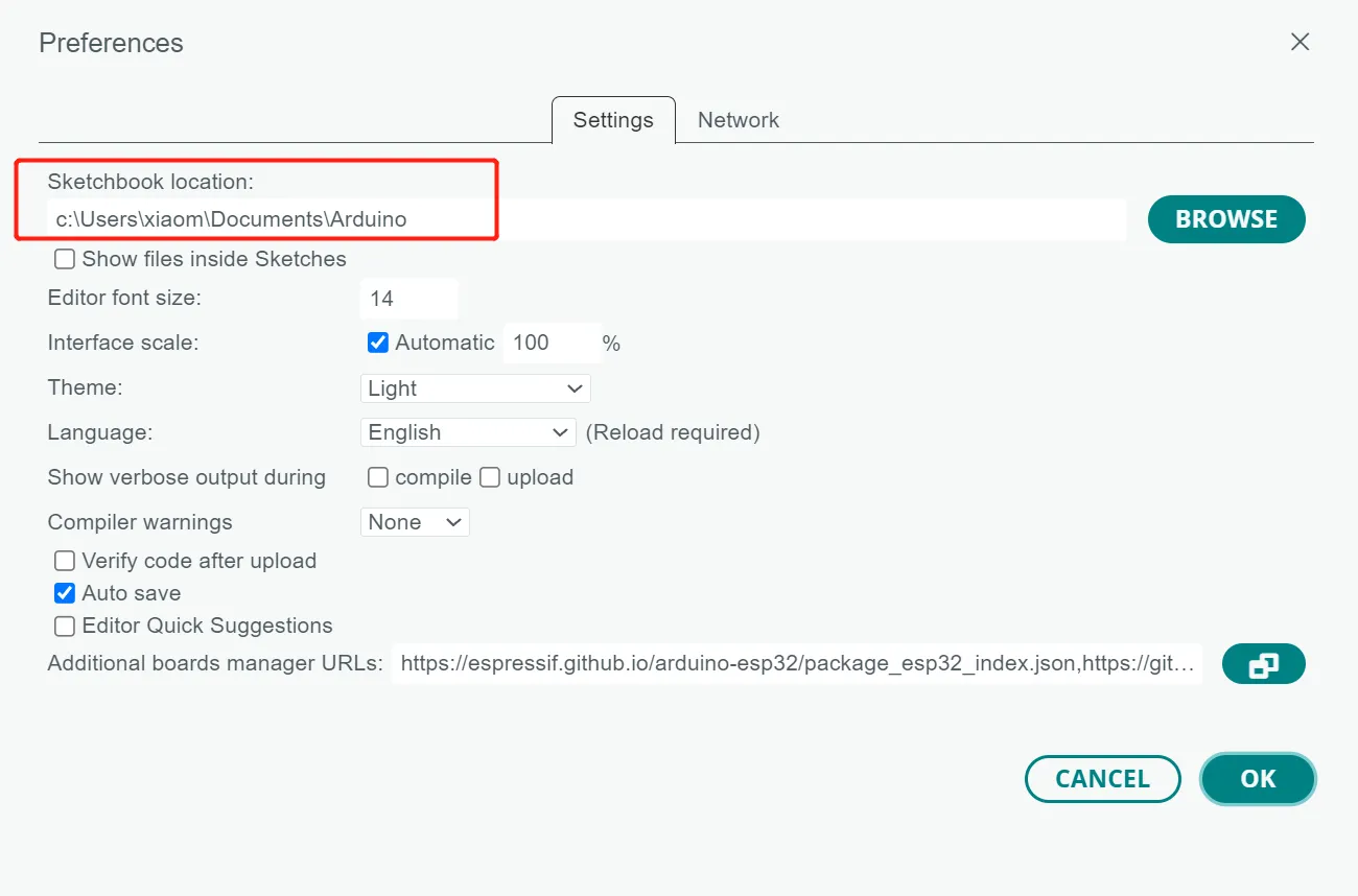

  1. Install "DHT20" library.
    Copy the DHT20 in the libraries folder to the Sketchbook location.
    Arduino-1

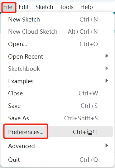

    To find the Sketchbook location, please open the Arduino IDE, click "File"->"Preferences"->"Sketchbook Location".
    arduino-preferences
    sketchbook-location

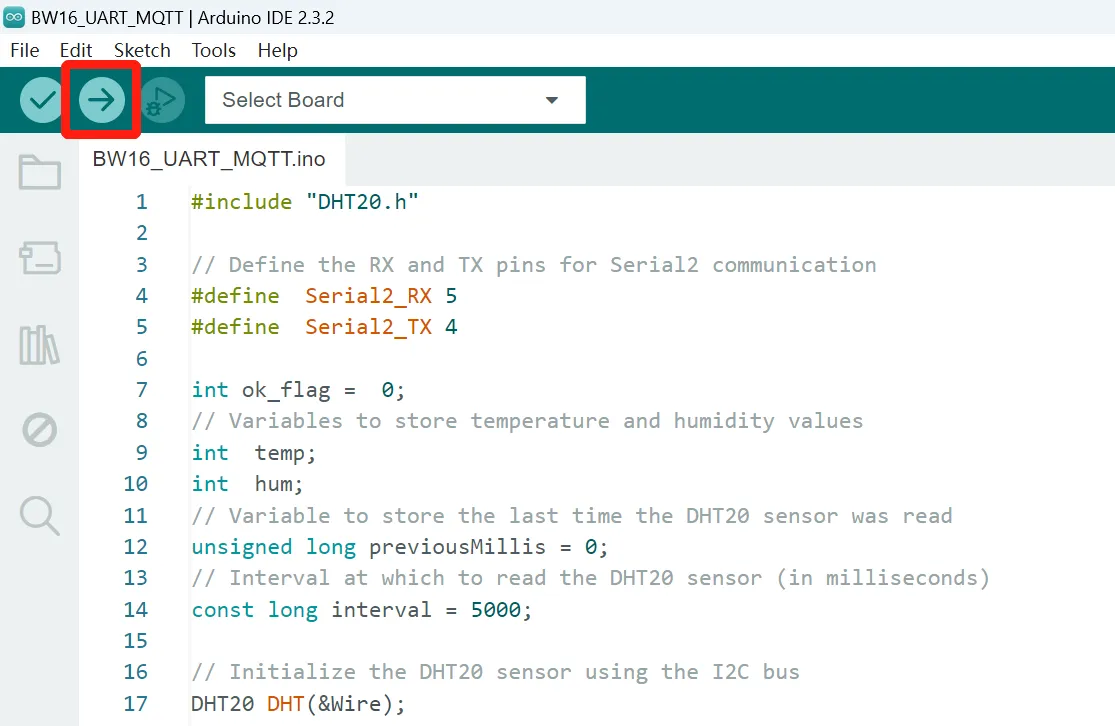

  2. Enter the "HA_MQTT_Demo" folder and open BW16_UART_MQTT.ino

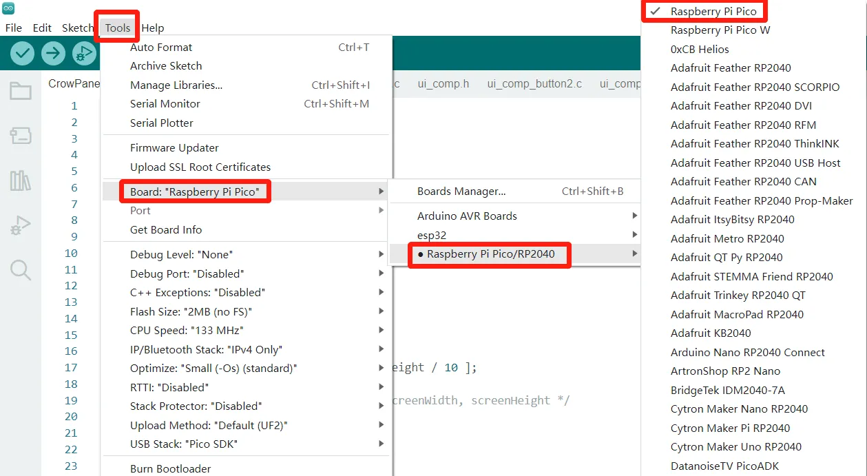

  3. Click "Tool" -> "Board", and select the "Raspberry Pi Pico"
    select-board

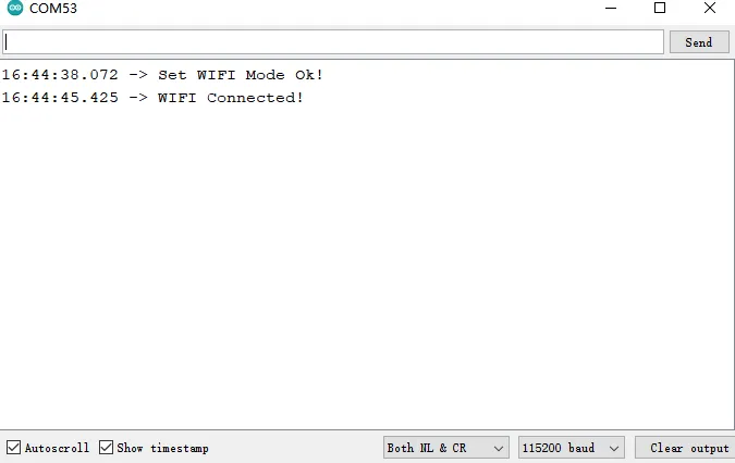

  4. Connect the PICO W5 to the computer, and click "Tool"->"Port" to select the corresponding port number.

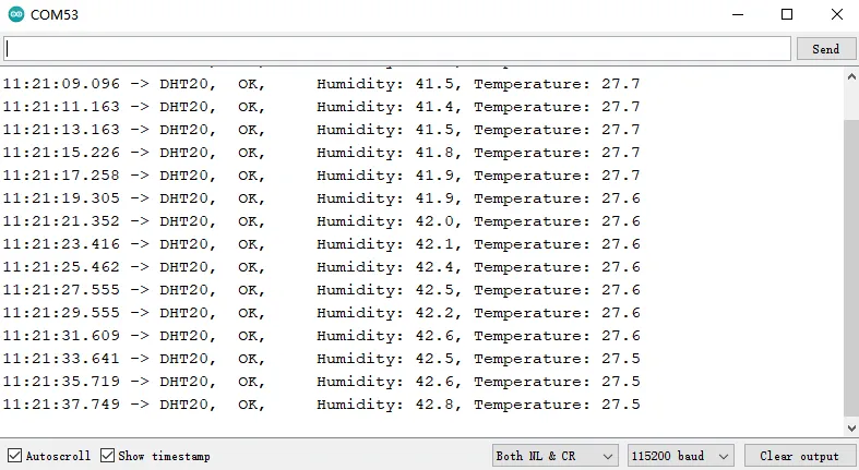

  5. Click the "Upload" icon to upload the code. After the program is successfully downloaded, it will be prompted that the download is successful.
    Upload-code

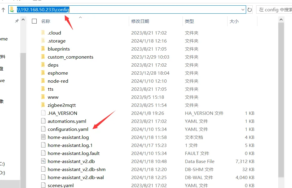

  1. Open "File Explorer" and type in \\192.168.50.233 to enter "config" folder. Open configuration.yaml
    HA-21
  2. Add the following code in configuration.yaml to add the sensors.

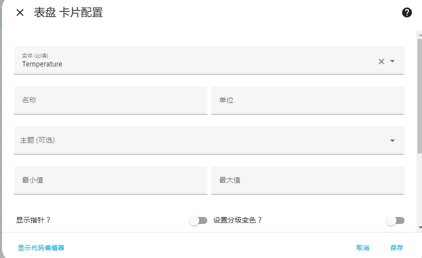

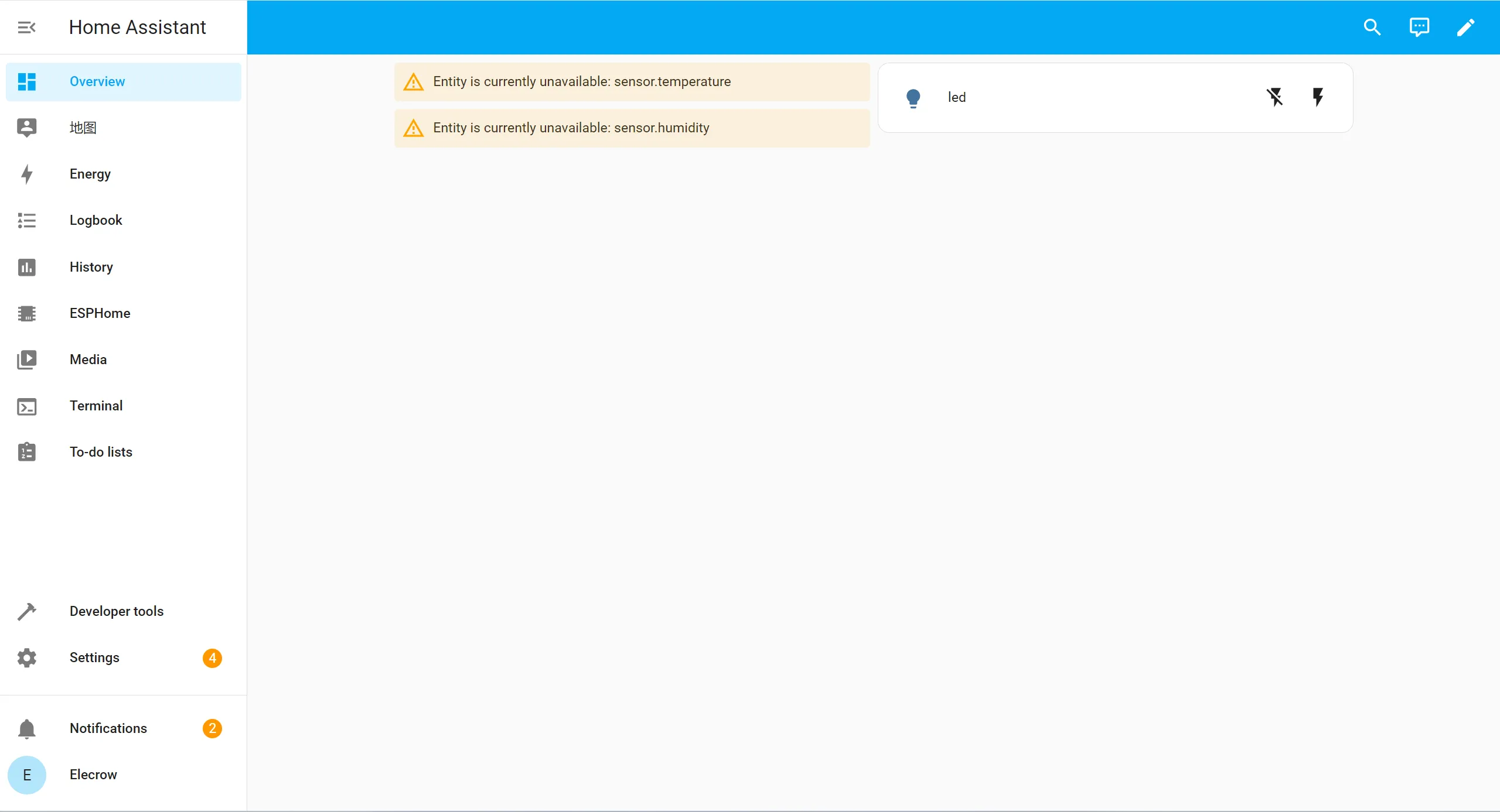

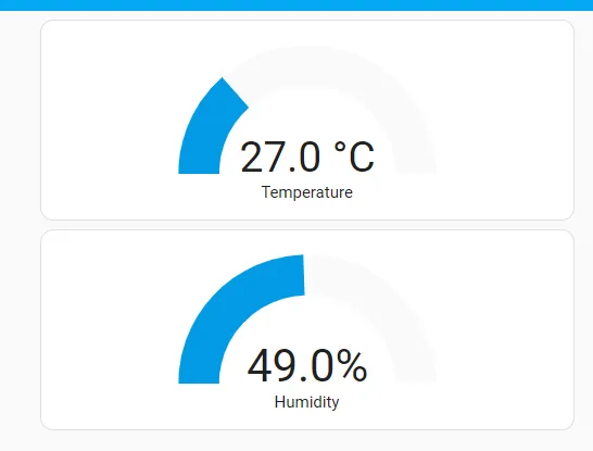

  3. After saving the above code, go to the homepage -> Overview -> Edit Dashboard -> Add Card -> Select the entity just written in configuration.yaml in the card, the save.

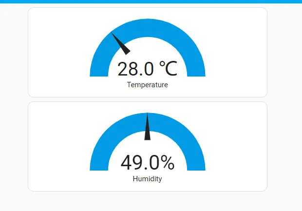

  4. Get the temperature and humidity of the environment in real time and display it on the server
    HA-22

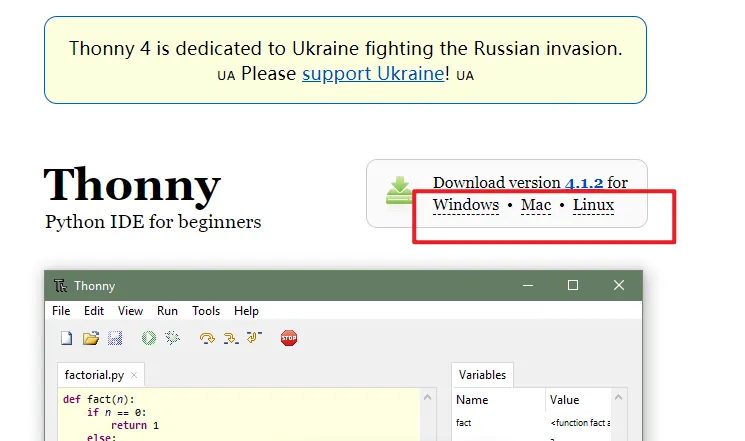

  1. Go to the website https://thonny.org/ and download the corresponding software version (here we take the Windows version as an example)
    Thonny-1

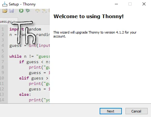

  2. Double-click the downloaded exe file to install the software.

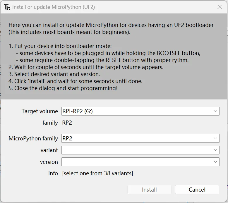

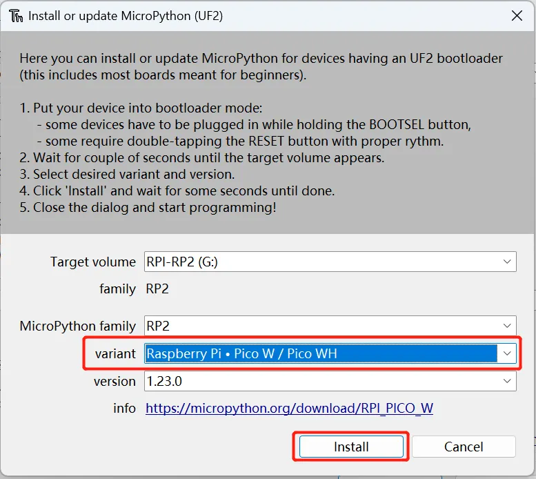

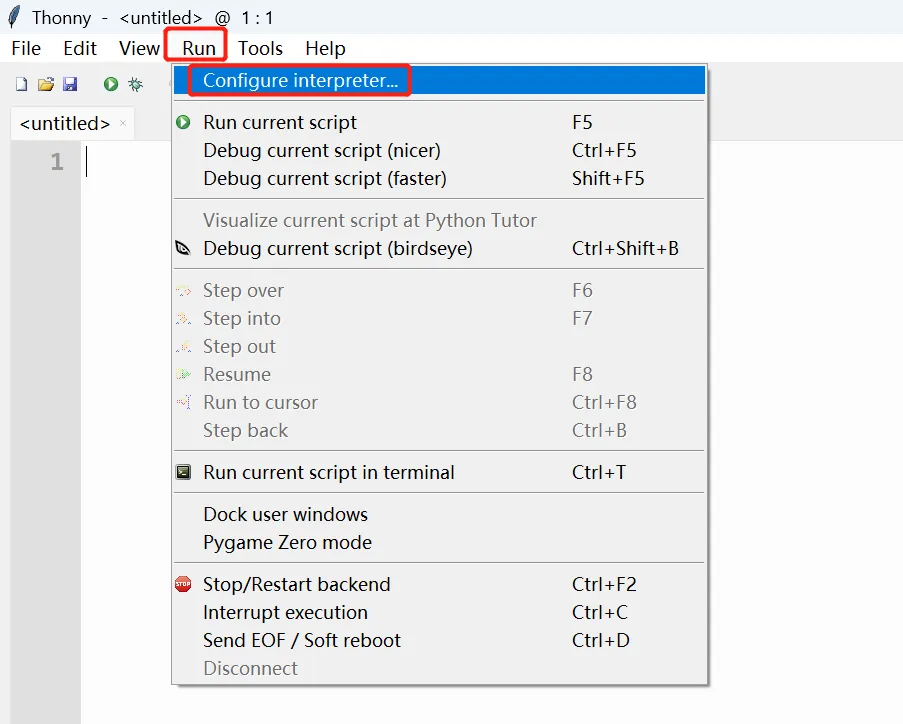

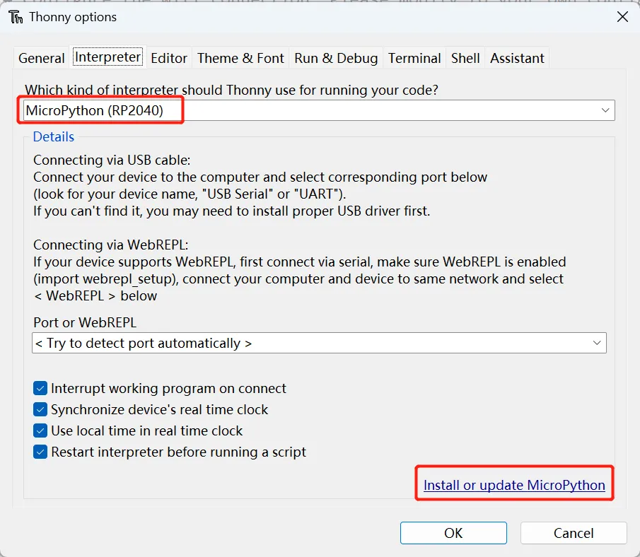

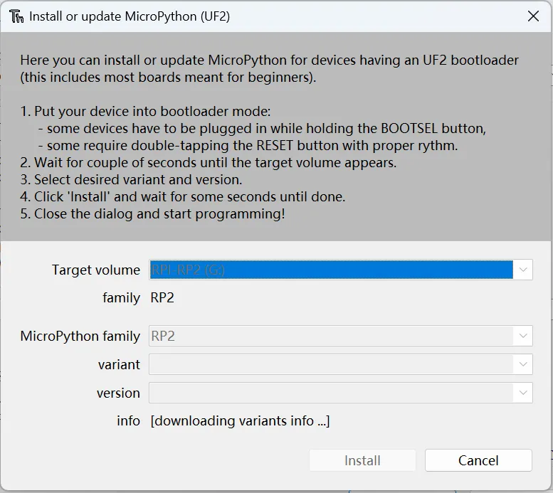

  2. Open Thonny IDE and click "Run"->"Configure interpreter". Select "MicroPython(RP2040)" as the interpreter. Then click "Install and update MicroPython"
    Thonny-6
    Thonny-7
  3. Waiting for the loading the downloading variants info...
    Thonny-8
    After loading is complete, it will show:
    Thonny-9

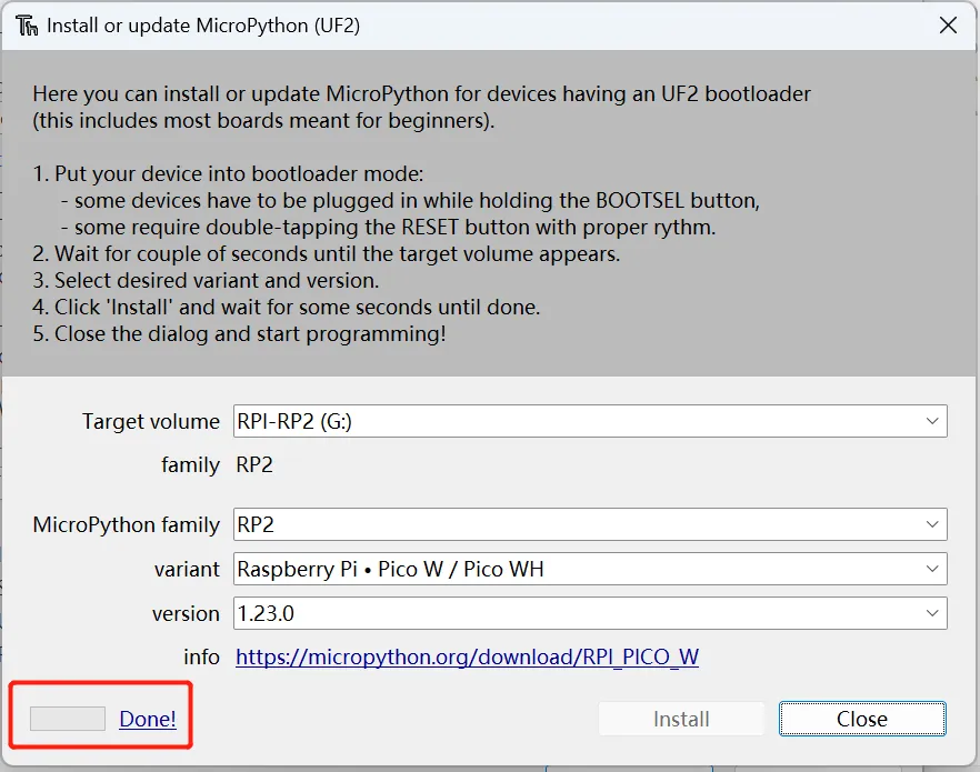

    Select the variant to and install the firmware.
    Thonny-10
    Installation is done!
    Thonny-11

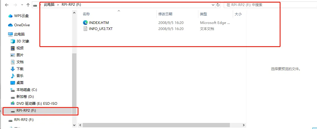

  2. Drag the firmware to the U disk
    Thonny-4
    Thonny-5

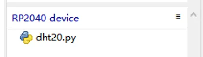

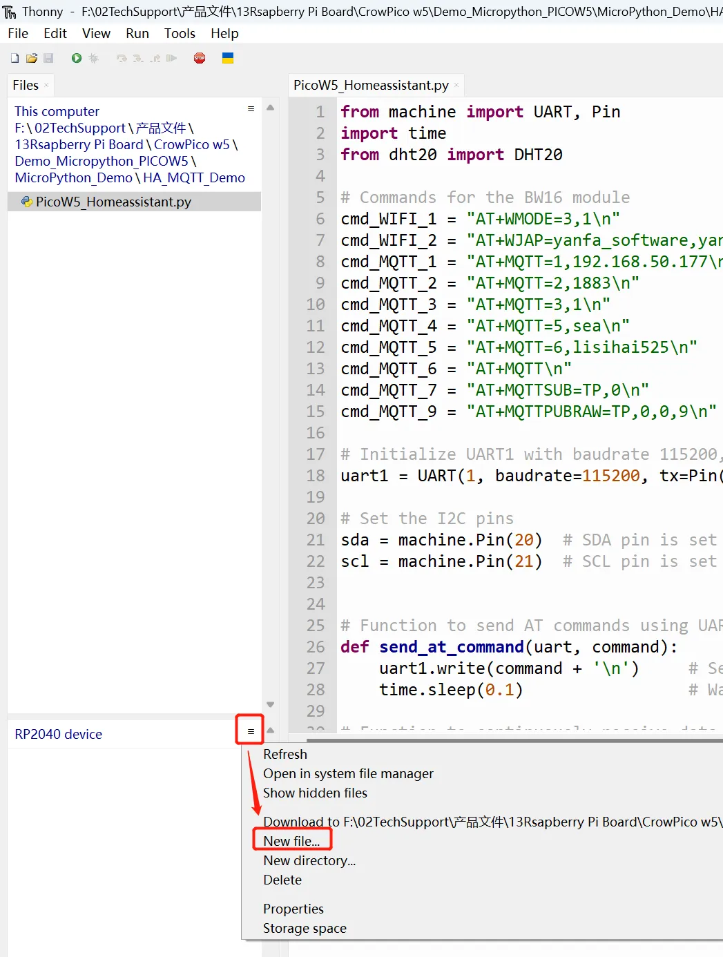

  1. Click the menu icon in the upper right corner of RP2040 device. Select "New file..."
    Thonny-12

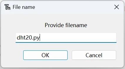

  2. Name the file, note to add the file type suffix(.py)
    Thonny-13
  3. Then copy the following to the editor.

  4. Click run, then the dht20.py will be added to RP2040 device
    dht20-added
    Thonny-14

  5. Get the temperature and humidity of the environment in real time and display it on the server
    Thonny-15

Examples 5 Read Temperature and Humidity from DHT20 via I2C 0
  1. Plug the DHT20 module to GPIO-20 and GPIO-21.
    Sensor PIN
    SCL GP21
    SDA GP20
  2. Upload the DHT20_test_rp2040_i2c0.ino to CrowPico W5.
    #include "DHT20.h"
    DHT20 DHT(&Wire);   //  or use 2nd I2C interface &Wire
    Serial.begin(115200);
    Serial.println(__FILE__);
    Serial.print("DHT20 LIBRARY VERSION: ");
    Serial.println(DHT20_LIB_VERSION);
    Serial.println();
    Wire.setSDA(20);  //  select your pin numbers here
    Wire.setSCL(21);  //  select your pin numbers here
    Wire.begin();
    delay(2000);
    Serial.println("Type,\tStatus,\tHumidity (%),\tTemperature (C)");
    //  READ DATA
    Serial.print("DHT20, \t");
    int status = DHT.read();
    switch (status)
    case DHT20_OK:
       Serial.print("OK,\t");
       break;
    case DHT20_ERROR_CHECKSUM:
       Serial.print("Checksum error,\t");
       break;
    case DHT20_ERROR_CONNECT:
       Serial.print("Connect error,\t");
       break;
    case DHT20_MISSING_BYTES:
       Serial.print("Missing bytes,\t");
       break;
    case DHT20_ERROR_BYTES_ALL_ZERO:
       Serial.print("All bytes read zero");
       break;
    case DHT20_ERROR_READ_TIMEOUT:
       Serial.print("Read time out");
       break;
    case DHT20_ERROR_LASTREAD:
       Serial.print("Error read too fast");
       break;
    default:
       Serial.print("Unknown error,\t");
       break;
    //  DISPLAY DATA, sensor has only one decimal.
    Serial.print("Humidity: ");
    Serial.print(DHT.getHumidity(), 1);
    Serial.print(",\t");
    Serial.print("Temperature: ");
    Serial.println(DHT.getTemperature(), 1);
    delay(2000);
    //  -- END OF FILE --
  3. After the code is successfully uploaded, the humidity and temperature value will be printed in the serial monitor.
    DHT20-VALUE

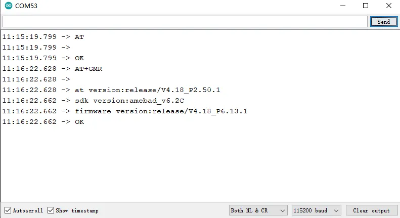

Examples 6 Control BW16 with AT Commands through UART1
  1. The BW16 is soldered on board. The RX is connected with GP5, and the TX is connected with GP4.
  2. Upload the BW16_UART.ino to CrowPico W5.
    // Define the RX and TX pins for the second serial port
    #define Serial2_RX 5  // Set the RX pin
    #define Serial2_TX 4  // Set the TX pin
    // Initialize the second serial port
    void UART1_Init()
    Serial2.setRX(Serial2_RX);  // Set the RX pin for the second serial port
    Serial2.setTX(Serial2_TX);  // Set the TX pin for the second serial port
    Serial2.begin(115200);     // Start the second serial port at a baud rate of 115200
    delay(1000);               // Delay for 1 second to allow the serial port to initialize
    // Setup function to initialize the main serial port and the second serial port
    Serial.begin(115200);      // Start the main serial port at a baud rate of 115200
    UART1_Init();               // Initialize the second serial port
    // Main loop function that prints "loop" and then delays
    UART1_test();
    // Test function for the second serial port
    void UART1_test()
    Serial2.println("AT");
    while (Serial2.available())  // Check if there is data available to read from the second serial port
       Serial.write(Serial2.read());  // Write the data from the second serial port to the main serial port
    Serial2.println("AT+GMR");
    Serial.println("");
  3. After the code is successfully uploaded, open the serial monitor.

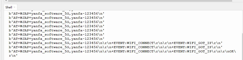

Examples 7 Connect to the 5G band Wi-Fi
  2. Upload the Connect_to_the_5G_band_Wi-Fi.ino to CrowPico W5.
    Note: Serial1 is UART0, and Serial2 is UART1
    // Define the RX and TX pins for Serial2 communication
    // Flag to check the status of the WiFi connection
    int ok_flag = 0;
    // Define the command to set the WiFi mode to AP+STA
    #define SET_WIFI_MODE           "AT+WMODE=3,1"
    // Define the command to set the WiFi SSID and password
    // Please replace "yanfa_software_5G" and "yanfa-123456" with your own SSID and password
    #define SET_WIFI_SSID_PASSWORD  "AT+WJAP=\"yanfa_software_5G\",\"yanfa-123456\""
    // Initialize the serial communication at 115200 baud rate
    // Set the RX and TX pins for Serial2 communication
    // Start Serial2 communication at 115200 baud rate
    // Delay for 5 seconds to allow the module to initialize
    delay(5000);
    // Call the UART2 test function
    UART2_test();
    // Main code to run repeatedly
    // This loop is empty as the setup function does all the work
    // Function to test UART2 communication and set WiFi configuration
    void UART2_test() {
    // Clear the serial buffer
    clear_serial();
    // Reset the OK flag
    ok_flag = 0;
    // Send the command to set the WiFi mode
    Serial2.println(SET_WIFI_MODE);
    // Wait until the OK flag is set
    while (!ok_flag) {
       if (Serial2.find("OK")) {
          // Set the OK flag to true
          ok_flag = true;
          // Print a message to indicate the WiFi mode has been set
          Serial.println("Set WIFI Mode Ok!");
    // Clear the serial buffer again
    clear_serial();
    ok_flag = 0;
    // Send the command to set the WiFi SSID and password
    Serial2.println(SET_WIFI_SSID_PASSWORD);
    while (!ok_flag) {
          ok_flag = true;
          // Print a message to indicate the WiFi is connected
          Serial.println("WIFI Connected!");
    // Function to clear the serial buffers for Serial and Serial2
    void clear_serial() {
    // Clear Serial2 buffer
    while (Serial2.read() >= 0);
    // Clear Serial buffer
    while (Serial.read() >= 0);

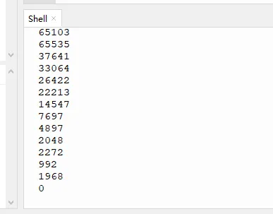

Examples 4 Control the Light Intensity into an Analog Value
  1. Plug the light sensor module to GPIO-27 Port.
    Sensor PIN
    Light Sensor GP27
  2. Run the AnalogRead.py.
    from machine import ADC, Pin
    import time
    # Initialize an ADC object using Pin 27 for analog input
    adc = ADC(Pin(27))
    while True:
       # Read the analog value from the ADC and print it as a 16-bit unsigned integer
       print(adc.read_u16())
       # Delay for 1 second to avoid overwhelming the output with too many readings
       time.sleep(1)
  3. The light intensity will be printed in the shell.

  2. Run the I2C_DHT20.py.
    import machine
    import utime
    # Set the I2C pins
    # SDA pin is set to GPIO pin 20
    sda = machine.Pin(20)
    # SCL pin is set to GPIO pin 21
    scl = machine.Pin(21)
    # Create an I2C object, select bus 0, assign the SDA and SCL pins, and set the bus frequency to 400kHz
    i2c = machine.I2C(0, sda=sda, scl=scl, freq=400000)
    # Import the DHT20 library
    from dht20 import DHT20
    # Initialize the DHT20 sensor with its I2C address and the I2C bus
    dht20 = DHT20(0x38, i2c)
    while True:
       # Perform a measurement with the DHT20 sensor
       measurements = dht20.measurements
       # Extract the temperature from the measurements and convert it to an integer
       temp = int(measurements['t'])
       # Extract the relative humidity from the measurements and convert it to an integer
       hum = int(measurements['rh'])
       # Print the temperature and humidity values
       print(f"Temperature: {temp} °C, humidity: {hum} %RH")
       # Pause for 2 seconds before the next measurement
       utime.sleep(2)
  3. The humidity and temperature value will be printed in the shell.
  1. Send the command to connect to WiFi to the bw16 module through uart1 and receive the information returned by the bw16 module.
  2. The BW16 is soldered on board. The RX is connected with GP5, and the TX is connected with GP4.
  3. Run the Connect_to_the_5G_band_Wi-Fi.py
    from machine import UART, Pin
    import time
    # Initialize UART1 with baudrate 115200, transmit on Pin(4), receive on Pin(5)
    uart1 = UART(1, baudrate=115200, tx=Pin(4), rx=Pin(5))
    # Function to send AT commands using UART1
    def send_at_command(uart, command):
       uart1.write(command + '\n')     # Send the AT command followed by a newline for the module to process
       time.sleep(0.1)                 # Wait for the module to process the command and send a response
    # Function to continuously receive data from UART1 until a newline character is detected
    def Uart1_receive():
       data = b''          # Initialize an empty bytes object to store incoming data
       succeed = "OK"      # Expected success response from the module
       fail = "ERROR"      # Expected error response from the module
       while True:
          if uart1.any():              # Check if there is data available to read
                data += uart1.read()     # Read all available data into 'data'
          if data.endswith(b'\n'):     # Check if the data ends with a newline character
                if succeed in data:      # If the success response is in the data
                   print(data)          # Print the received data
                   break                # Exit the loop
                if fail in data:         # If the error response is in the data
                print(data)              # Print the data received so far
          time.sleep(0.5)              # Wait for 0.5 seconds before continuing
    # Send an AT command to set the module's working mode
    send_at_command(uart1, 'AT+WMODE=3,1')
    Uart1_receive()
    # Send an AT command to connect the module to a Wi-Fi network with the SSID "yanfa_software_5G" and password "yanfa-123456"
    send_at_command(uart1, 'AT+WJAP=yanfa_software_5G,yanfa-123456')
    Uart1_receive()
