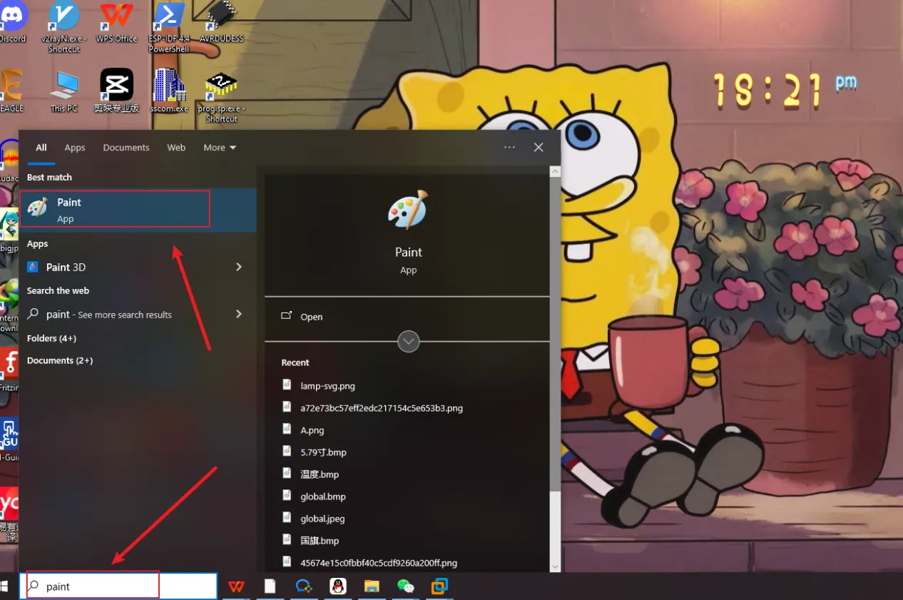

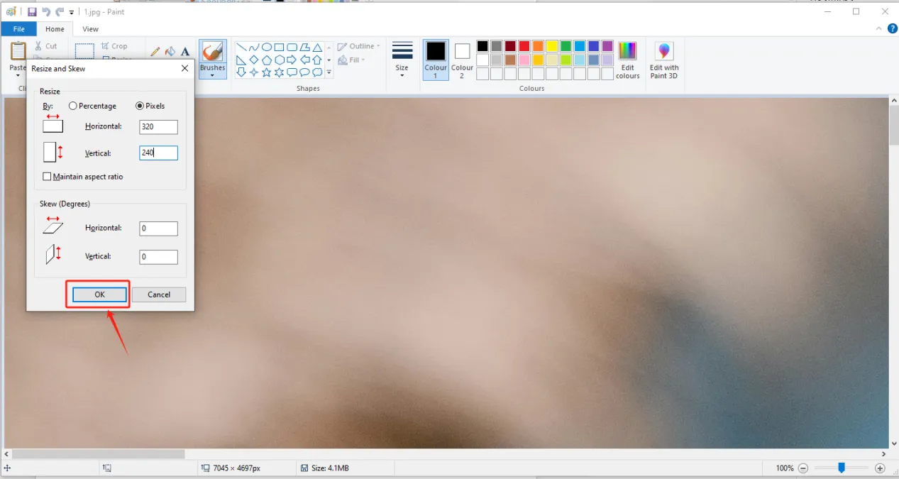

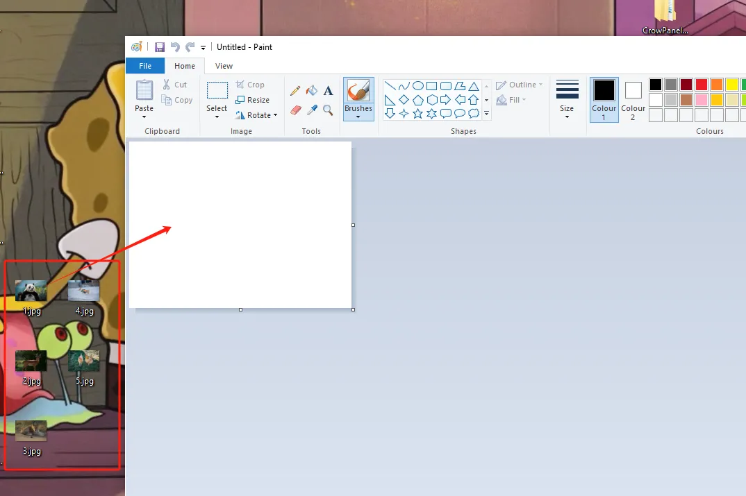

First, open the "paint" tool on the computer.

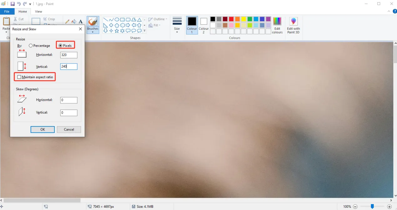

Drag and drop the image into the "paint" tool to readjust the pixels of the image
(Images can be uploaded to the browser and selected according to everyone's preferences)
Adjust the pixel to 2.4-inch screen resolution: 320x240
(If you are using a different size, please set the correct resolution)
Can be referred to:There are resolutions of different sizes as references above. (Second point)
Click confirm
Adjust the resolution of the image as shown in the picture

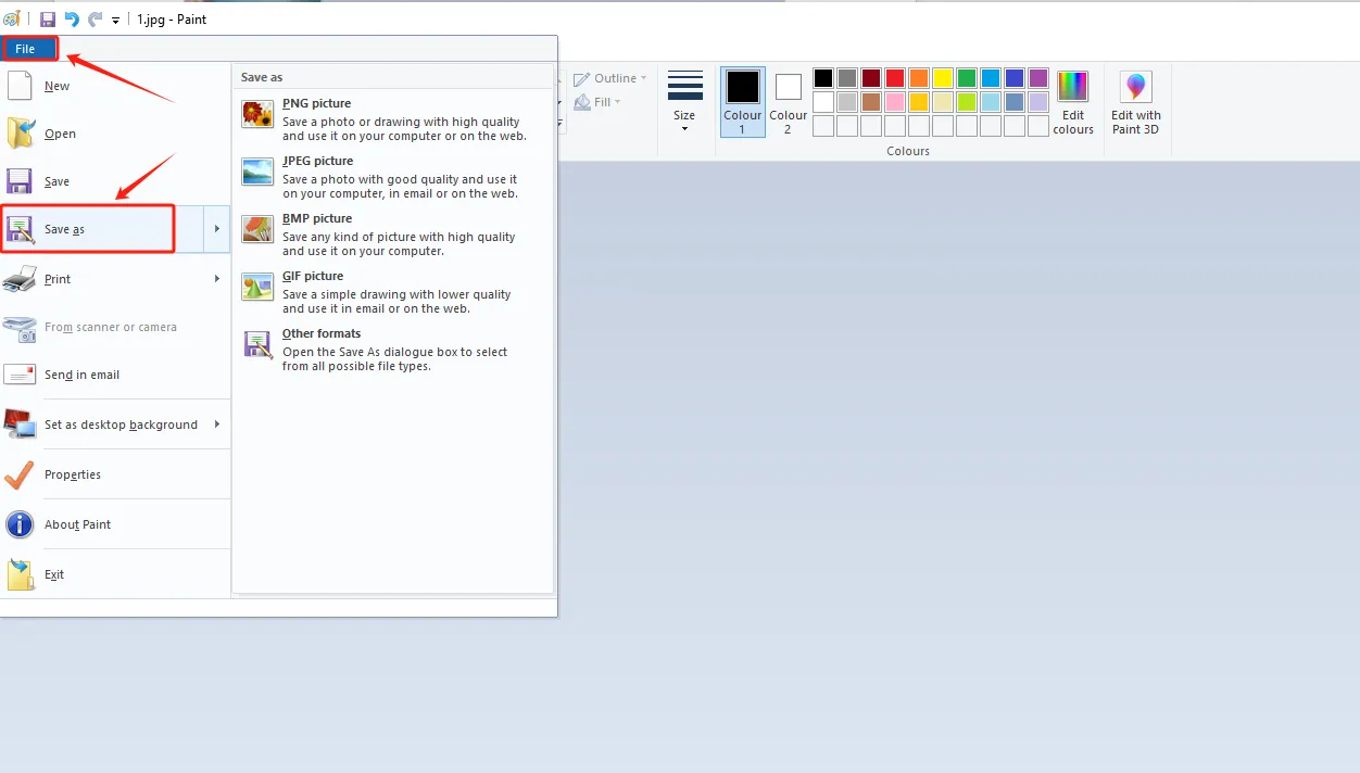

Save to a folder for easy use (folder path can be customized)
Save in BMP format (must have a 24 bit image depth)

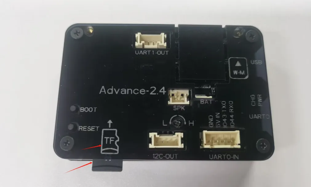

3 Insert the SD card containing this saved image into your CrowPanel ESP32 Advance HMI¶
(2.4 inch, 2.8 inch, 3.5 inch products can be directly inserted for use)

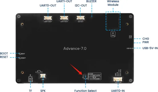

(After inserting the SD card, turn the function switch to 1 0 mode (TF Card mode) for 4.3-inch, 5.0-inch and 7.0-inch.)

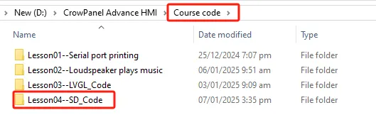

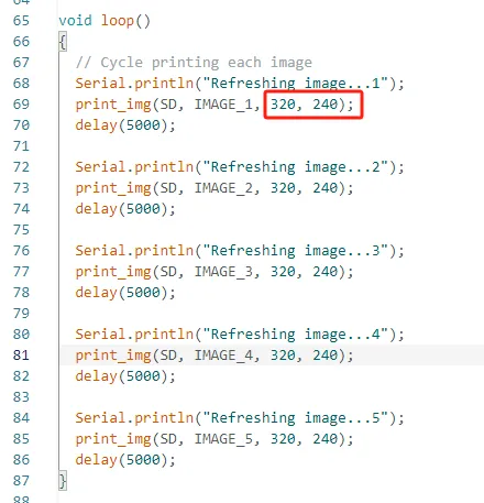

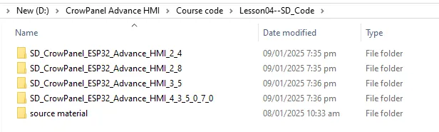

4 Open the code we provide, and you only need to modify the path and name of the image you saved¶
Modify the path of the image you saved
Here, my path is the five images in the current path on the SD card
So the path of my image is the current path "/" plus the image name (1. bmp)
Then display the image in the loop and set the resolution size
(different sizes have different resolutions)

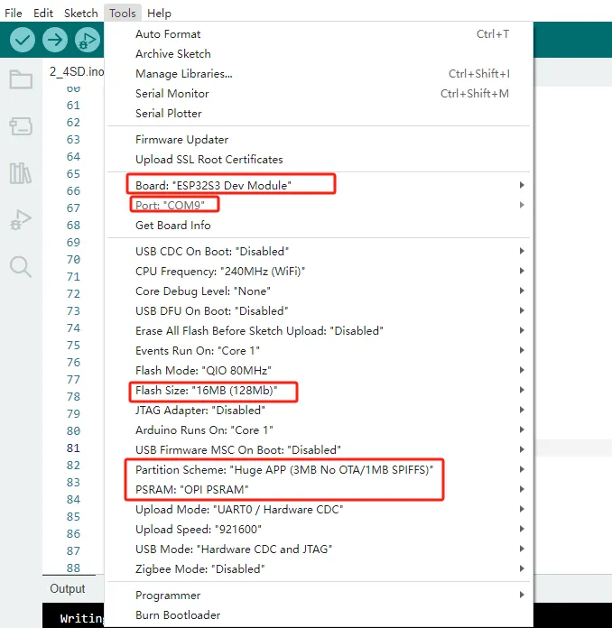

5 Configure the runtime environment and burn code¶
(Before burning, please replace the relevant library files according to different sizes.
How to replace, details in Lesson 2)

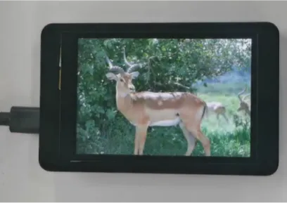

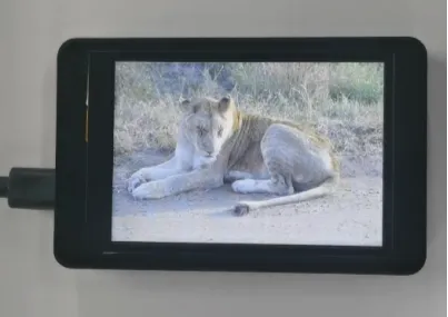

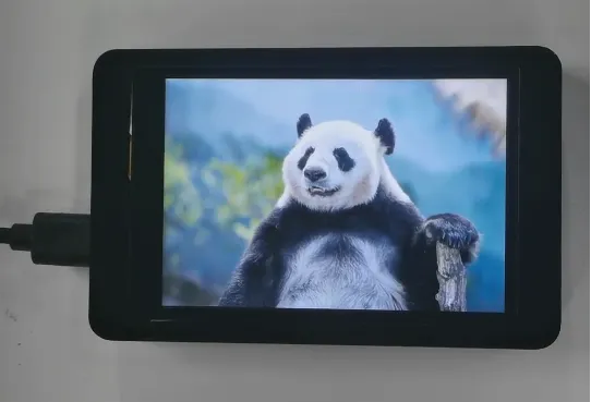

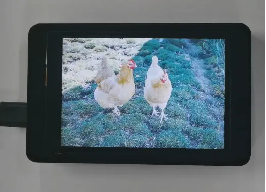

6 Phenomenon display¶
The five photos I saved on the SD card will be displayed in a loop.

if (SD_init() == 0)
Serial.println("TF_Card initialization succeeded");
show_test(LCD_H_RES, LCD_V_RES, 75, 150, "SD_Card OK");
delay(3000);
} else {
Serial.println("TF card initialization failed");
show_test(LCD_H_RES, LCD_V_RES, 75, 150, "SD_Card failed");
delay(3000);
gfx.setRotation(2);
gfx.fillScreen(TFT_BLACK);
Serial.println( "----- Setup done -----" );
void loop()
// Cycle printing each image
Serial.println("Refreshing image...1");
displayImage(SD, IMAGE_1, 320, 240);
delay(5000);
Serial.println("Refreshing image...2");
displayImage(SD, IMAGE_2, 320, 240);
delay(5000);
Serial.println("Refreshing image...3");
displayImage(SD, IMAGE_3, 320, 240);
delay(5000);
Serial.println("Refreshing image...4");
displayImage(SD, IMAGE_4, 320, 240);
delay(5000);
Serial.println("Refreshing image...5");
displayImage(SD, IMAGE_5, 320, 240);
delay(5000);
